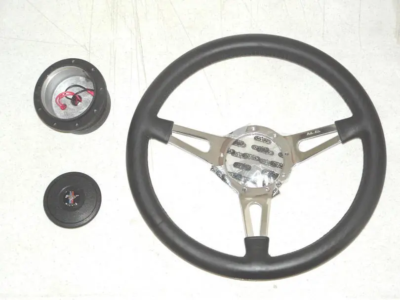

'65 fastback: I like that steering wheel! I'm thinking this LeCarra leather wrapped, $234 for this kit at Mustang Depot of Las Vegas:
or a Grant one like yours. What is the model number?

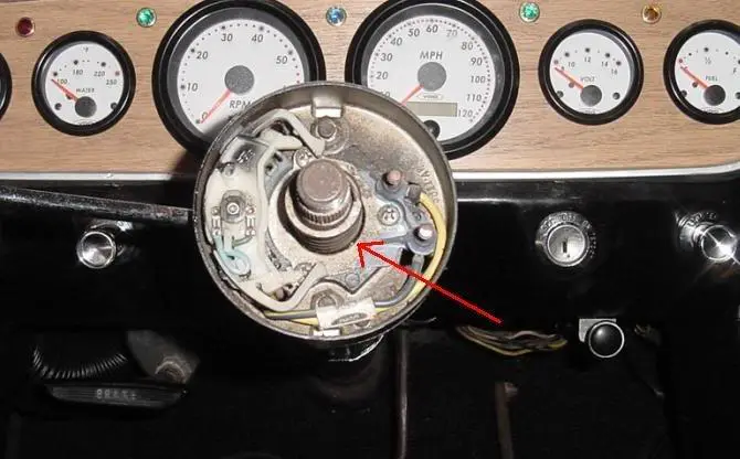

On mine, it was the horn cancelling spring ring. I took it off the stock wheel and put it on the Grant horn contact hub. Apparently the two tangs (arrow) were sticking too far in and were rubbing on the bearing retainer plate (next pic arrow). I caught it before it did too much damage. (The pictures are before the damage)
Instead of fixing it, (trimming the tangs) I went back to the larger stock wheel mainly because my daughter was having a hard time parking the car. Now she has her own car, but I’ll probably wait until I upgrade the suspension before I try the Grant wheel again. I also have a ’68 collapsible column I want to put in.

Your issue is different than mine then. In your 2nd pic you can see the two horn contacts on the right. On mine, the one with the yellow wire doesn't have any insulation on the connector. When the wheel is on those two leads get pushed down thru a cutout in the barrel. I'm pretty sure it is shorting out right there. Electrical tape didn't work so I guess I'll have to remove some metal.
