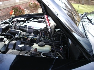

I have the MRT's and love them. I too was torn between the Redline's and MRT's. The thing that sold me on the MRT's is that they are a lot more compact (don't take up much room under the hood) and it required no drilling. Here is a picture of mine.

Safe to assume from some of the posters that the MRT ones will work with 94 to 98 models? Evern with an aftermarket hood?
Cheers
I dunno about that. The Redlines would be more versitile.
MRT relies on the location of a fender bolt. However it has nothing to do with the hood as it slips in on the hood mount.
