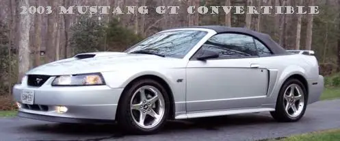

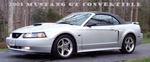

I have the exact setup in question on my 02 GT: H&R Sports, Tokico HP's, and MM C/C Plates. I love the drop and the ride feels just as stock with the shocks. No problems on my daily driver on the pothole infested streets of Chicago. I wouldnt do the C Springs if your looking to get rid of the 4x4, the H&R's will definetly make you happy without slamming the car.

The Tokico's would be ok but be sure to keep the rubber bumpers that are on the stock front struts, you can cut them down some but using them will prevent the struts from ever bottoming out. The best thing is to use CC Plates as Blinkstang did on his Mustang. Note in his picture that he has installed spacers on top of the CC Plate bearing which allows the strut to be extended more than when using the stock CC Plates. This will allow the strut to have more travel before bottoming out. :nice:

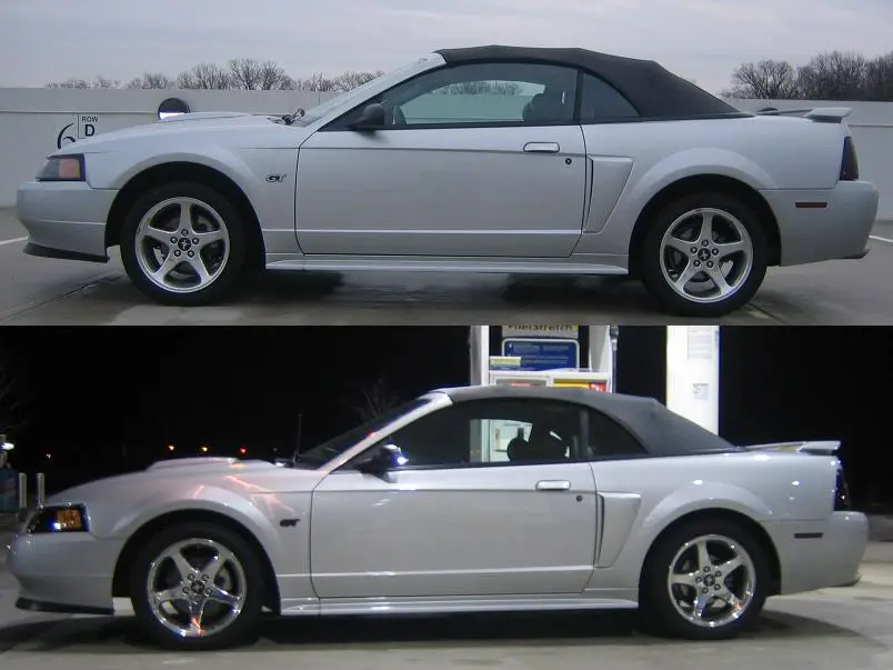

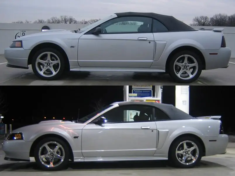

I have that exact kit ordered from that company. Transaction and everything went perfectly, as did the install. Love the improved handling and looks. The drop wasn't quite enough for me so I cut half a coil off the front and got a great rake.
Here is a comparison pic. Top is stock, bottom is a few hours after the install. They settled a bit after this.
