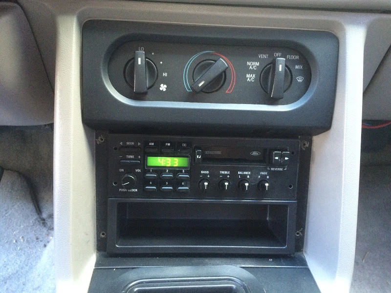

I had a chance to install the new bulb and dry fit the radio and storage compartment today. I used this bulb (Sylvania 24 LL), and it works great.
The storage compartment is from the Radio Delete piece linked above. I did have to separate the storage piece from the radio delete plate, which wasn't so hard. It's creased along the line, so i gently flexed it back and forth until it separated along the crease.
Here's how it's looking with the pieces laid into place. I didn't push them in all the way, as I don't have the removal tool and didn't want to mess with finding something to remove it with afterward:
The screw holes are really going to bug me. I don't like the idea of painted screws or plastic caps or stickers or etc ... I think I will attempt to find some ABS plastic strips I can cut to fit along the sides. Done right, it should look pretty close to factory.
Any suggestions on where to look for something to cover the sides?

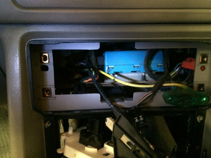

I'm digging into the wiring today, and came across this blue box behind the HVAC controls. Not sure what it is, but it appears to be some sort of ECU or maybe BCM? Anyone know what this box is?

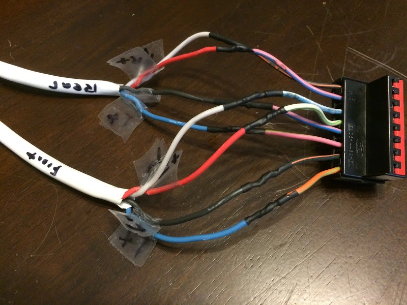

I ended up using 16/4 wire, to make the installation a bit easier; and here is how I adapted the harness. I simply cut the harness connector off of the body harness and soldered it onto the wires I ran.
I ran these to the trunk, then also ran new wires to the 6 speaker locations from the trunk. So all wires, including an amp install wire from the battery, are now converging into the trunk space. I don't have the amp or LOC yet, so I just used the passive MB Quart crossovers for the door and dash tweeters (MB Quart components), and connected the rear 6x9s (Diamond speakers) up as well.

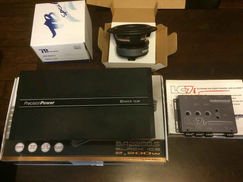

The amplifier, line out converter, and some 6.5" subs were delivered today. Not sure if I'll get a chance to install them tonight though.
Precision Power BA2200.5 amplifier (high pass, band pass, and low pass capable 5 channel amp)
Audiocontrol LC7i (6 channel line out converter with bass control)
Tang Bang 6.5" subwoofers (these have received great reviews when performing in a infinite baffle setup, so no box required)

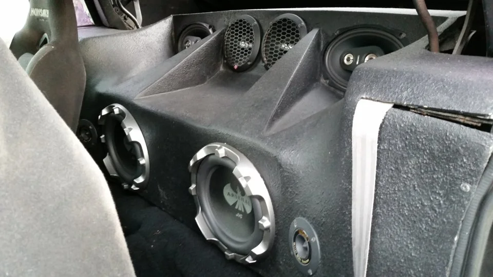

I can never go back.... lol I have considered pulling it out many times, but I laid all that fiberglass and can't bring myself to pull it out. This is what happens when your friends only say "that's cool!" And not "it's a convertible bro"... oh well young and dumb.
still needs the plates made for the seat belts..... I'm afraid to let this car leave my sight..... but I work so much I only put 2000 miles on her in the last 3 years..:(
