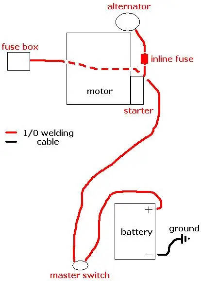

ok coming from the info you guys gave me i came up with this quick half ass diagram.
will it be ok to run the alt wire from the alternator to the lug on the starter?
what size fuse link is recommended?

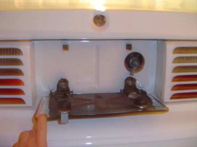

heres a pic from corral where the guy mounted his master switch behind the plate with the hinge

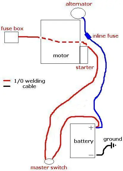

After looking at your "quick half ass diagram", I see a problem. The cutoff switch will not kill power to the car. Current will travel from the Alt to the starter and to the dist. box.
Run a separate line (i used 2 gauge) from the Alt to the cutoff + side in your diagram. This way the battery and alt. are cutoff from the car.

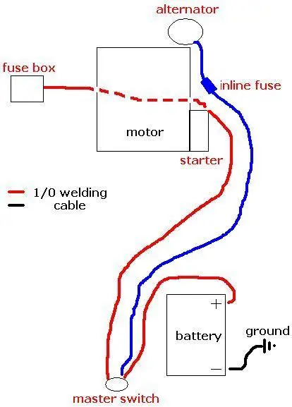

ok, from what you just said, i changed up my diagram.
the thing is tho, is that i'm gonna be running 3 cables again to the switch. i'm gonna get a juction box so i can merge the battery and alt together so i only have to run 2 cables to the switch instead of 3

if you ran it that way car would still run when the cutoff was clicked over
i think this is what your goin for

Eric94GTvert
May 13, 2002
596
PA, Nazareth
Dec 3, 2005
#18
  • Dec 3, 2005
  • #18
That would work fine. You can combine the alt and bat wires before the switch.
I have 3 cables running running to my switch like your diagram but my switch is mounted to my box so it's not really much extra wire. With your setup running to the license plate I can see where there would be more wire required.
both diagrams would kill the car exactly the same way. It doesn't matter which way you do it.

yeah it just hit me that he could have the wire on the other side of the switch but i would think it would be better to have the alt directly connected to the batt
