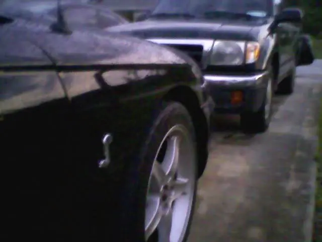

ill get one right now
98COBRA281
Nov 24, 2007
1,348
30
59
Port St. Lucie, Florida
Mar 11, 2008
  • Mar 11, 2008
its not to good of a picture but its about a 1 3/4in gap
