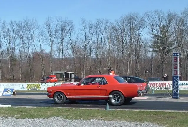

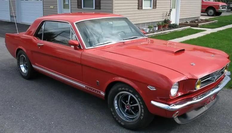

Although not original to the car, I agree that the Magnum 500 looks great on a 65/66 too. I am biased though:
I use a 15x8" on the rear of above stang (which I pushed the quarters out 3/4" a long time ago) and stuffed the widest slick possible on them. They fit great with no rubbing. The fronts happen to be 14x6's. A 15x7 with stock wheel wells would look equally good and require no body modifications.

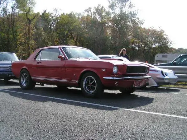

Here is a pic with 14x6's on all 4 wheels:
