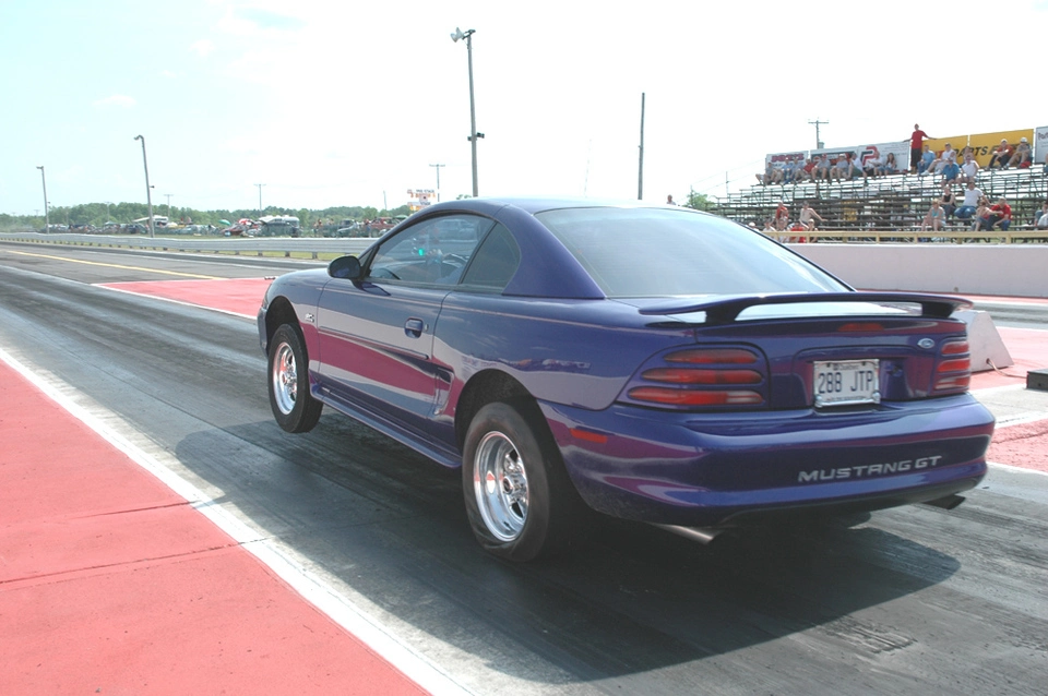

300rwhp + slicks + skinnies +70/30 struts + lower/upper control arms + NO SWAY BAR + dropping the clutch @5500rpm =

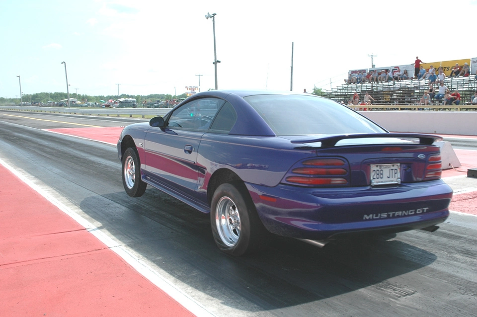

Here's a descent shot of the stance of the car that night. :p
