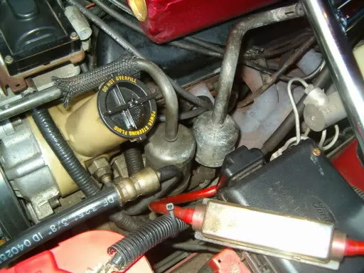

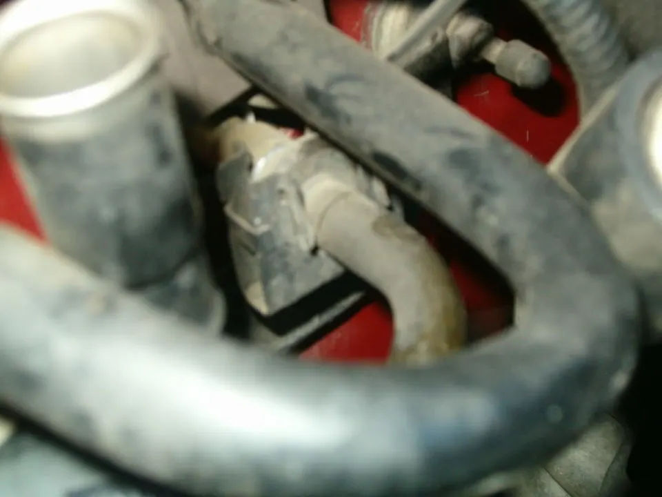

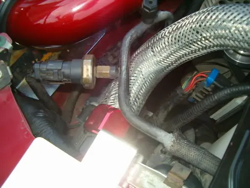

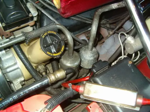

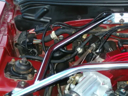

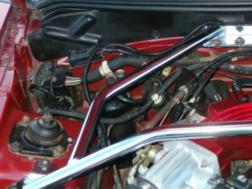

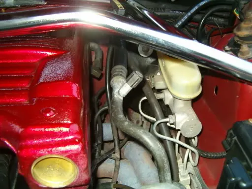

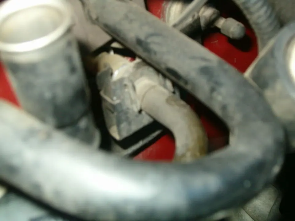

Alright, maybe I'm dumb, or maybe my question is misunderstood. I don't have the line removal tool. I'm wondering what I can rip out beforehand. I'll post some pictures, tell me if i can get rid of these peices with basic hand tools
I notice all kinds of plugs and wires here...this is why I'm a little confused to whether I can just jack it or not

I started taking out lines and such, then with the complications of maneouvering the lines around things, I just decided to start cutting what i don't think i'll need....man i sure hope i'm cutting the right things...

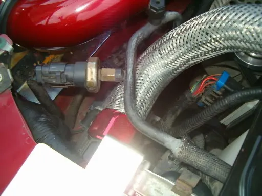

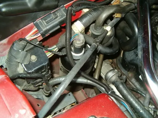

Here's a problem...

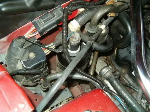

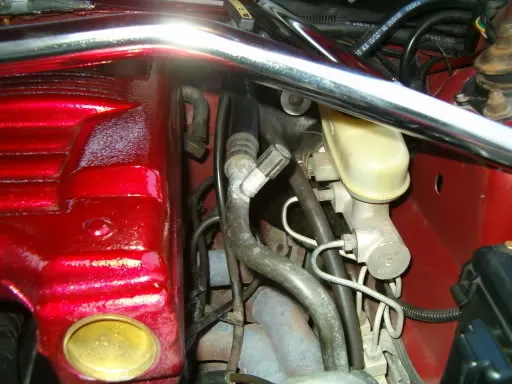

These little metal things, placed around the connectors....are they there to prevent people from using line pullers on them? This a connection by the firewall, about to go inside the car...they're getting in the way of the wire disconnection tools...
And, how do i get that canister out?

We pulled those clips right off.. No problem for me. My cousin a mechanic just cut the lines too. But we made sure we did it so we would have the best ease and least expense to reinstall the unit. Just try to think in terms of that. I would need a new condensor (shot anyway) and hoses. I wouldn't buy new though if I ever changed my mind.
