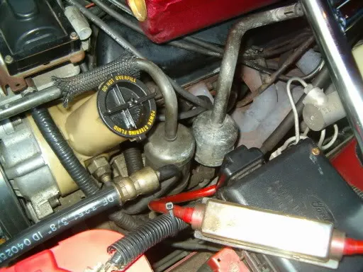

What are the two cylindrical peices in the center of this picture, and how do I get them out?
Once that is done, how do I yoink the actual A/C compressor, and what else will I be looking for?

those two things pictured are hardlined right to the compressor. if your not saving any of the system then i would just cut those. i think youll have to remove your rad to pull the condenser out
you sure urban? It looks like it's sitting right in view of me when i'm under the front of the car, unless that's something else...
and those two things are coming off as soon as possible, thanks for that bit
