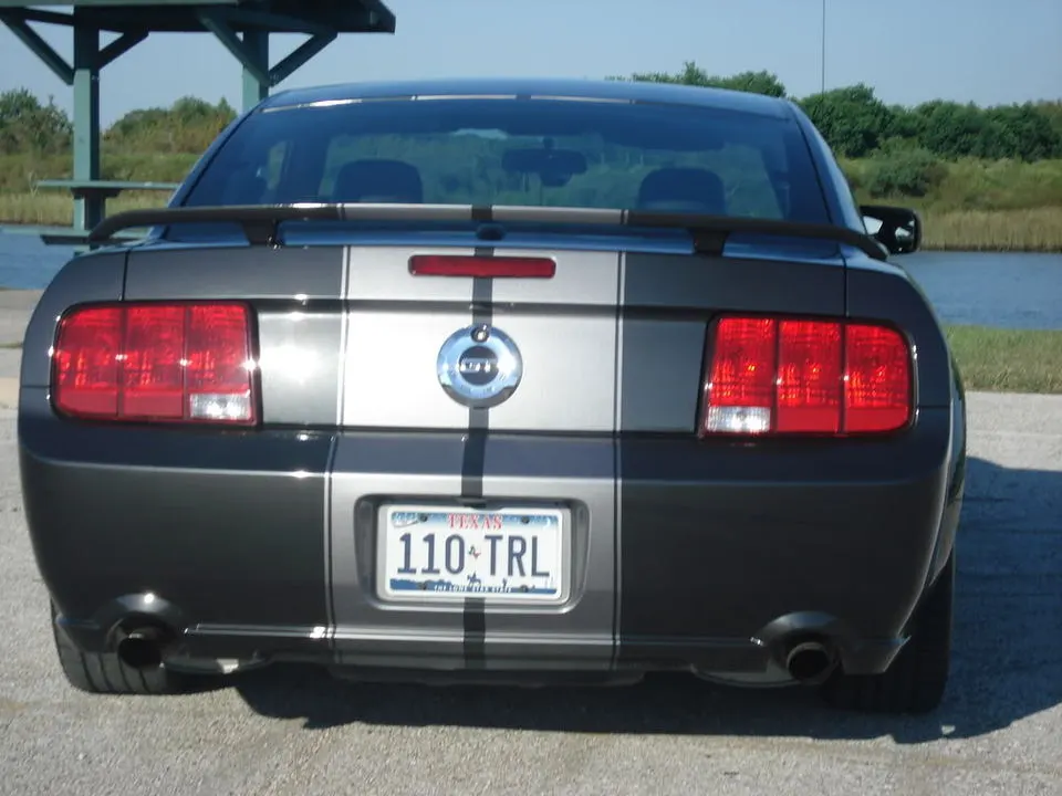

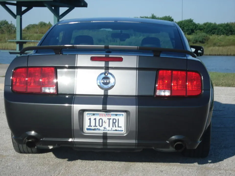

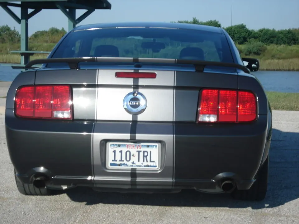

I really like how the blackout panel looks, but ive never seen one on a mustang w/ stripes...anybody have any opinions?
Would look fine IMO with the panel and stripes
