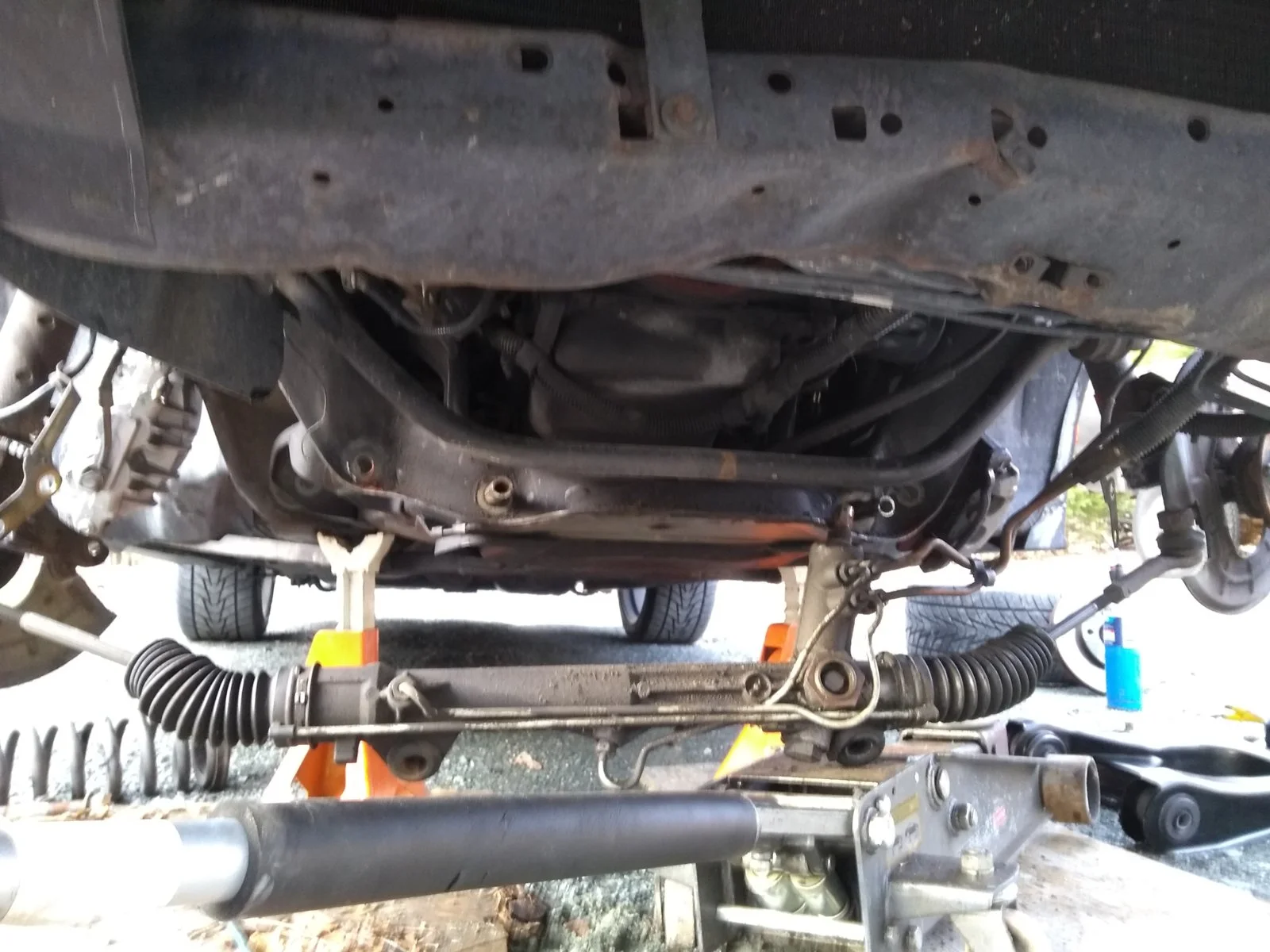

Did you run into issues getting the power steering rack to seat correctly? Mine's about half an inch too low on the pass side, and it seems to be hitting the oil pan when I try to work it upwards. Wondering if I have worn motor mounts (not unlikely).
No, I didn't hit the oil pan at all. Hopefully this picture helps you see the alignment. Don't mind what the PO did to the bottom of the radiator support :rolleyes: . Did have a chance to try jacking up the motor slightly?
