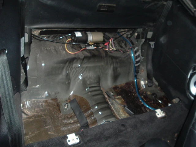

Here some pictures of what I have done so far. Thanks guys for helpping me out. Snoozer i'll IM you tomorrow for some more things to take out.
Dustin

Just a bit of info for the vert guys... our back seats don't weigh anywhere near what the coupes do. A rear seat delete in our cars is only worth about 15lbs TOTAL. Snoozer was right about the coupes though.... its around 35lbs.

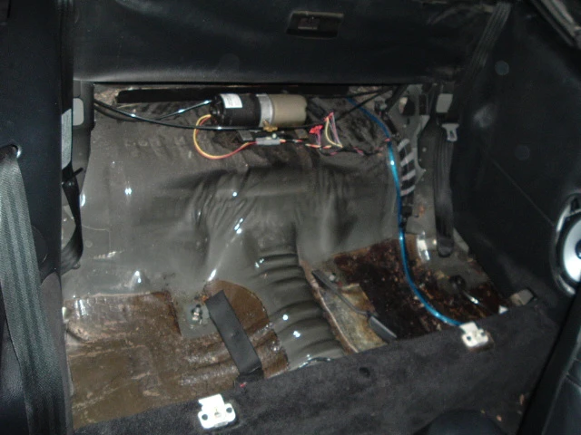

here is a pic of where the rear seat release latches are, they are the white things on th front edge of where the seat would be:
take a screwdriver and push in on the front of it and the pin will be released.
