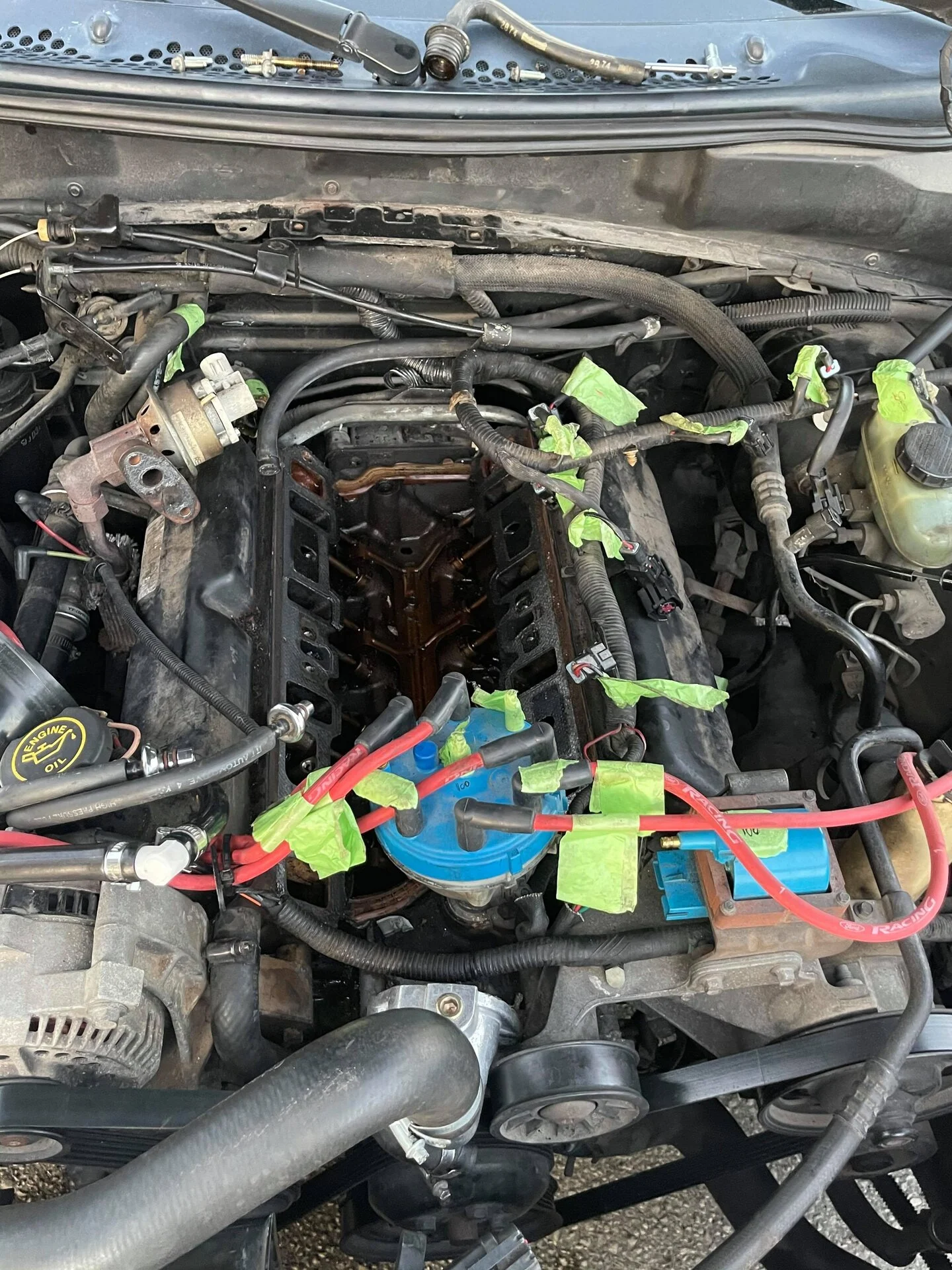

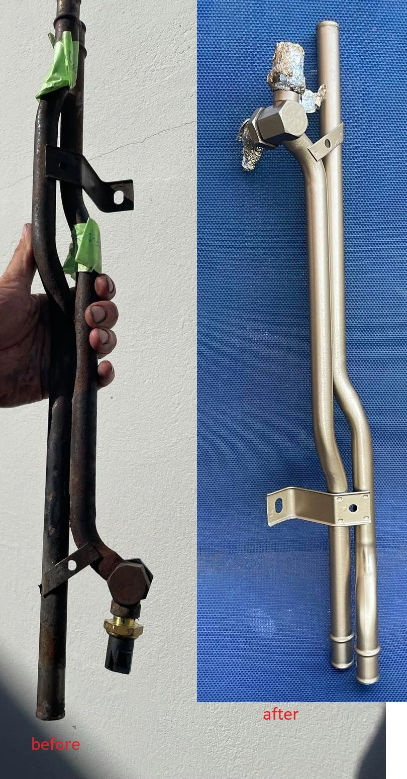

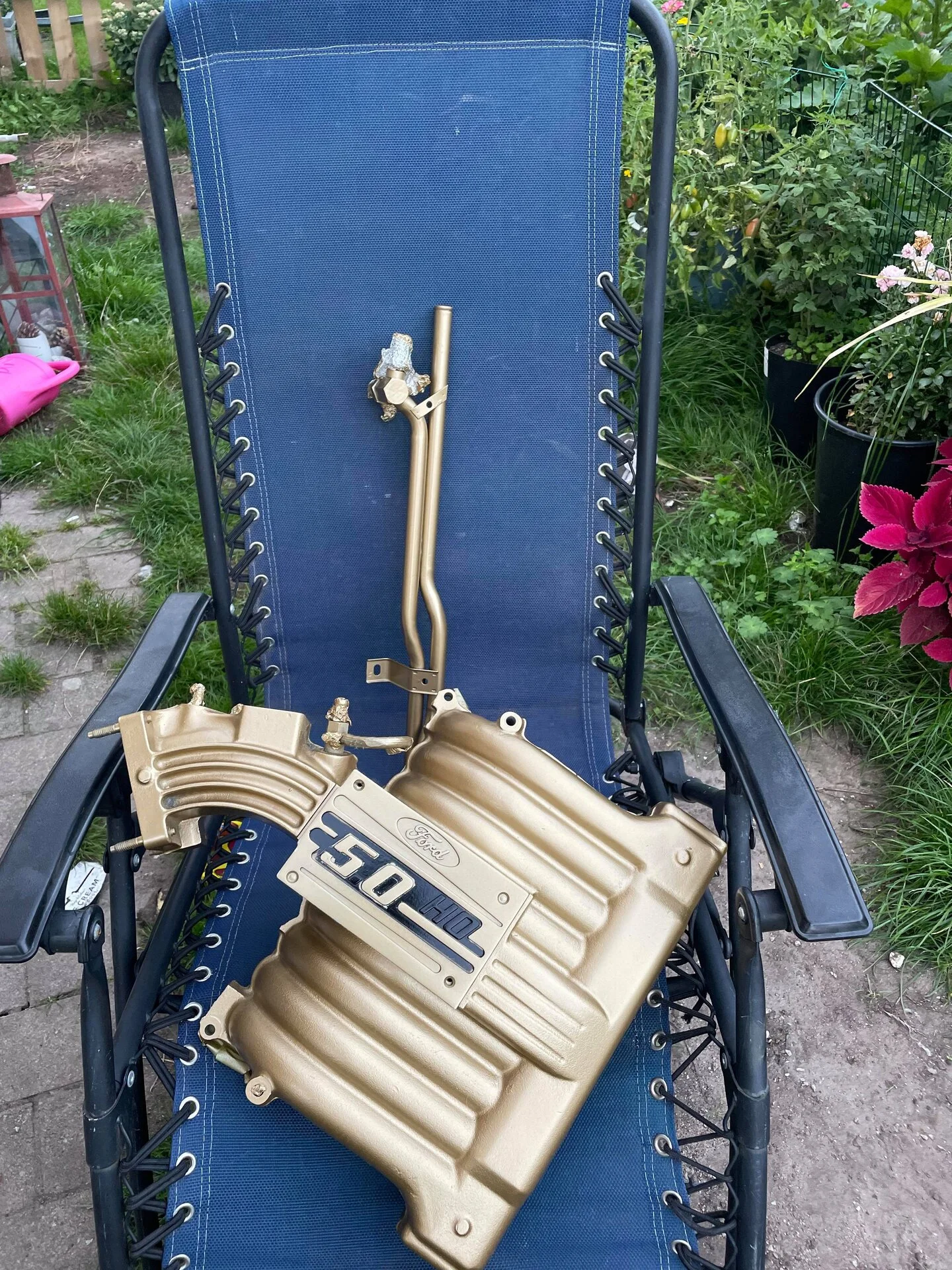

Know I removed and painted upper intake and a pipe (I dont know what name is it :/ ) and I hope its ok to paint with engine paint. Now I have 3 questions
1: how I clean and remove gasket ( i don't know the part of the car - engine ? - see image)
2. when I removed upper intake I did not know how imported marked every screw and its place ) what shall I do know :'(
3. Is there any manuel when I m going to put all parts back for beginner (some papper flow away :/ and some silicon pipe went of :/) :D

The pipes look like the heater tubes that take coolant to and from the lower intake manifold and short hoses that go to the heater core. If you search the site for Heater tube you should get plenty of hits, some of which are helpful.
