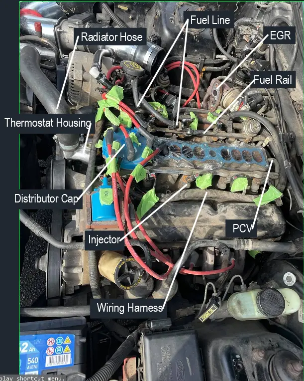

I need to replace the lower intake (I've learned from #stanget, its called lower intake yuhii :D ) but i wonder do i need to remove all things (waterpump, generater...)?
Could you please help me? Here is a pic how long I'm come with it. If I won't bother you, I appreciate to mark what needs to remove to take out the lower intake.

Hey, not sure if you saw my post in your last thread but here is the section from the factory service manual for your car that details how to remove and re-install the lower intake manifold. You don't need to remove the water pump or alternator, but you will need to disconnect the upper rad hose, fuel lines, PCV/vacuum hoses, ect. I also usually take the distributor cap off with all the wires to make it a little easier to move around. Once you get everything disconnected, it will take some upward force to get that lower intake off normally.

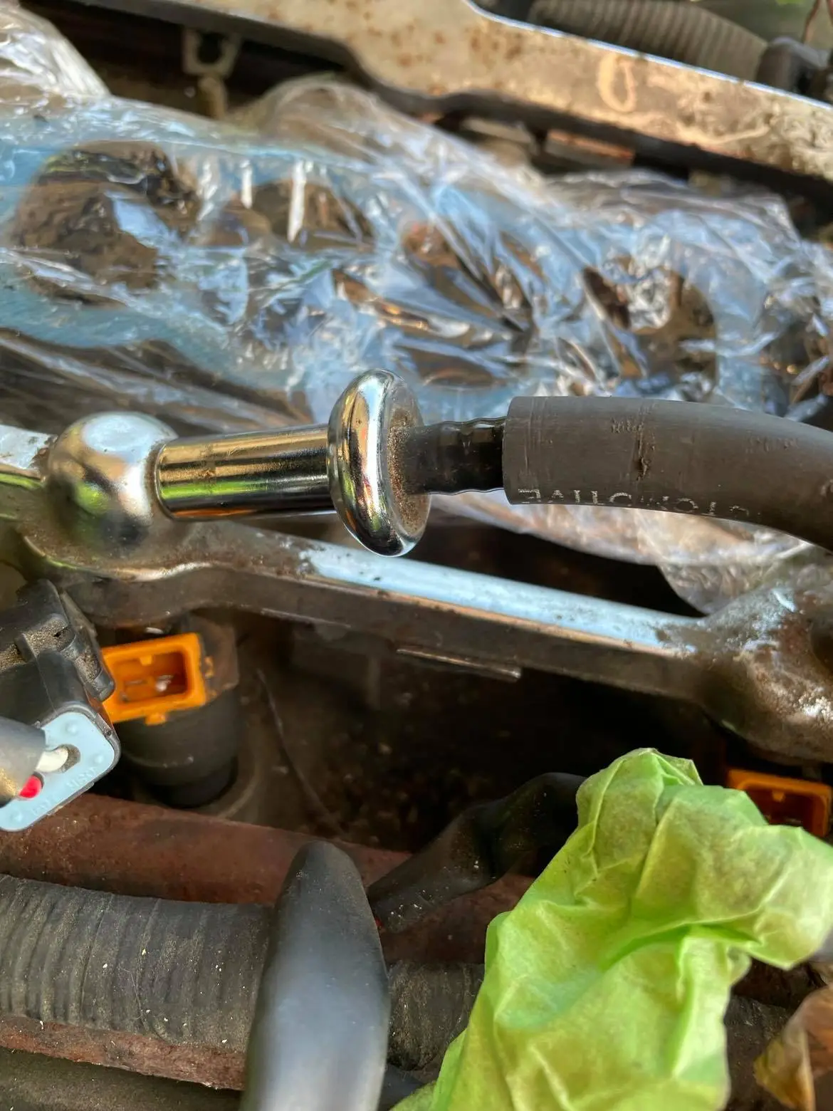

do i need a tool for remove on pic. I did " relieve the fuel pressure by putting a rag over the Schrader valve on the fuel rail and pressing it down to relieve the pressure." to relieve pressure but can't take out fule line :(. PS /991LXnSHO you are also good at mustang, you helped me lot also :)

I don't remember taking off my fuel hose? I'm sure I popped off the fuel rails as an assembly, one or two injectors might stay on the lower manifold, but they just pop out because they are held by o-rings.
But disconnecting that fuel hose will yield better clearance to remove the lower.
