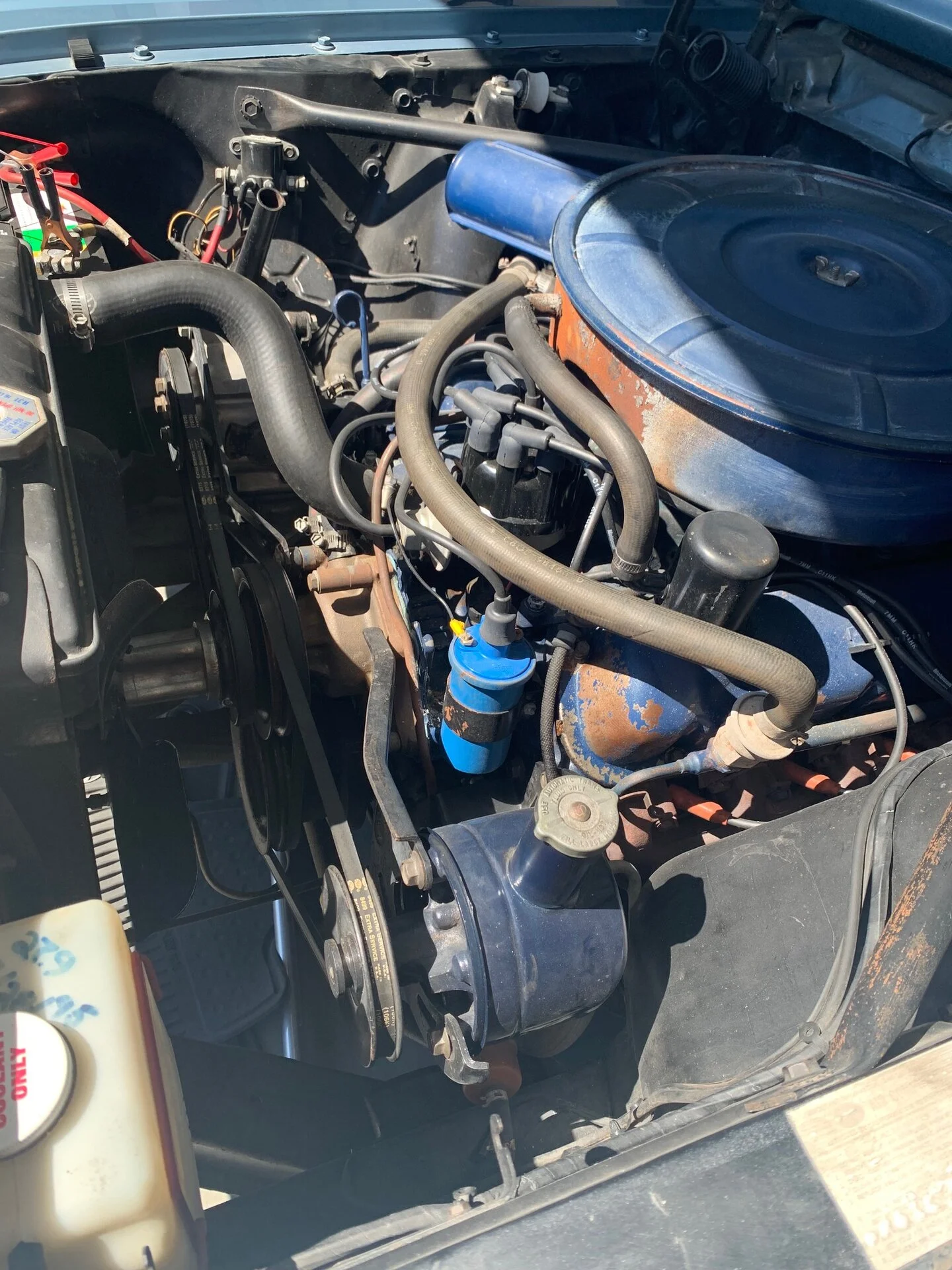

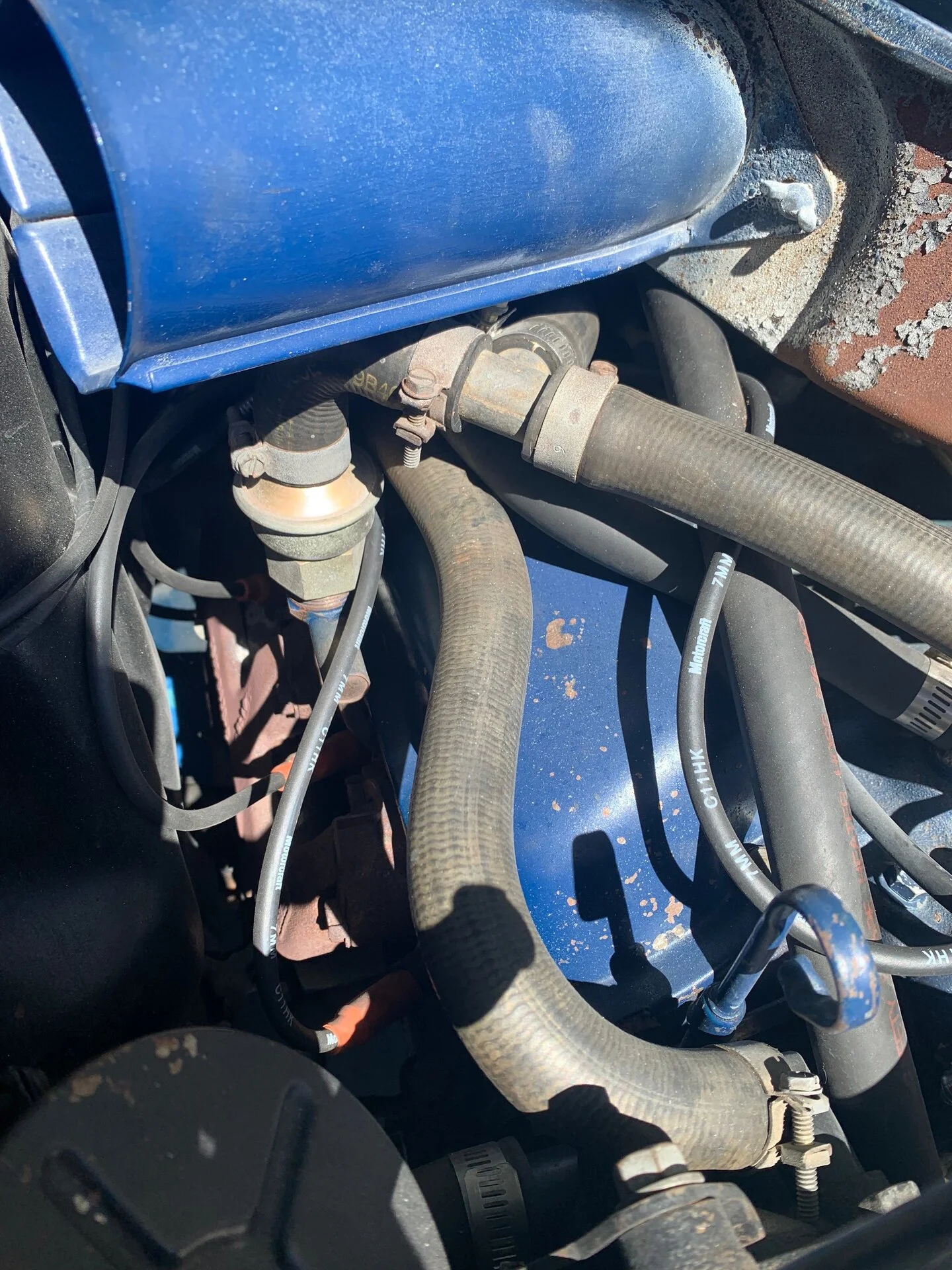

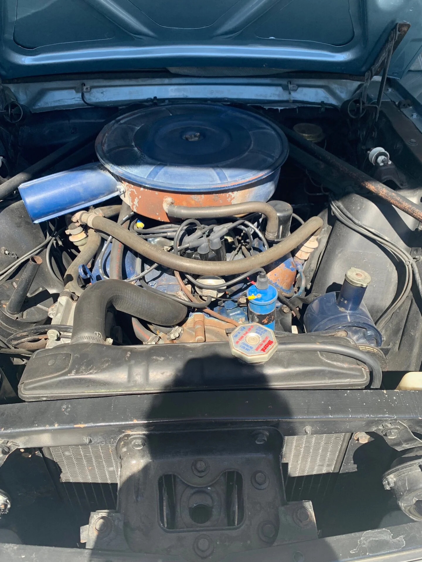

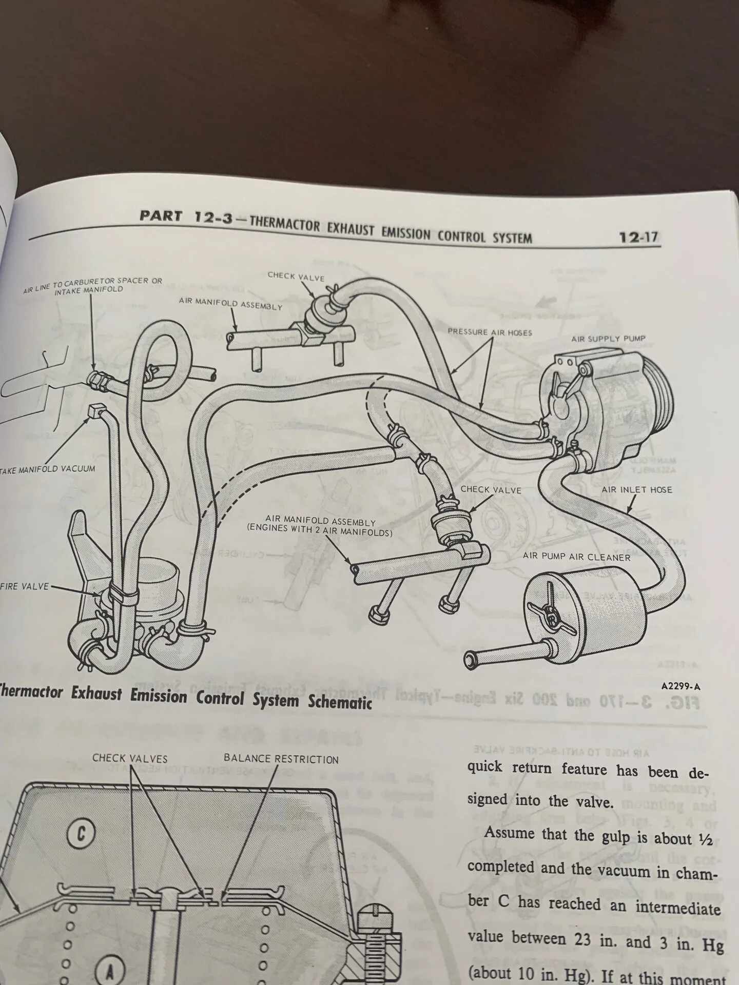

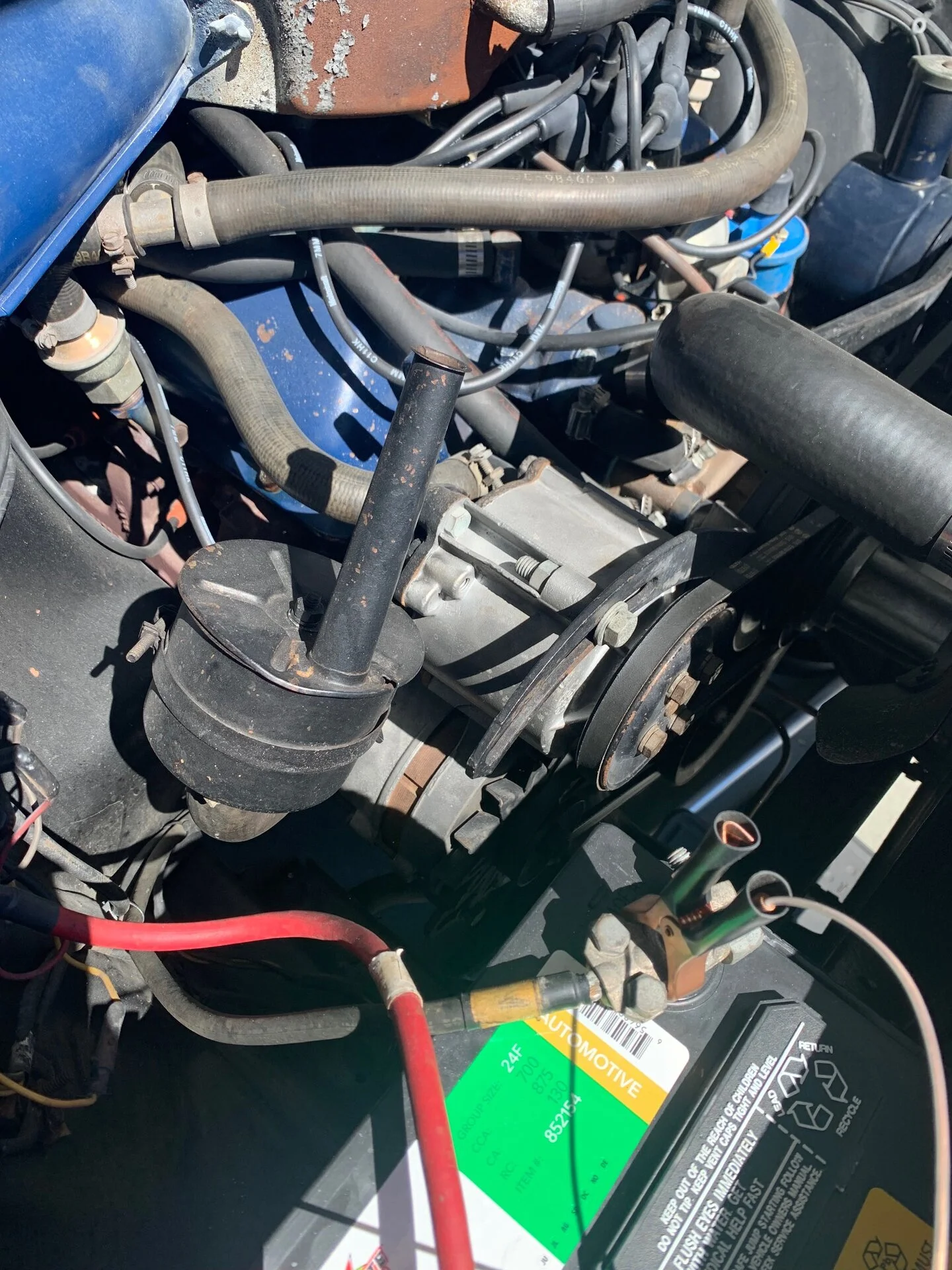

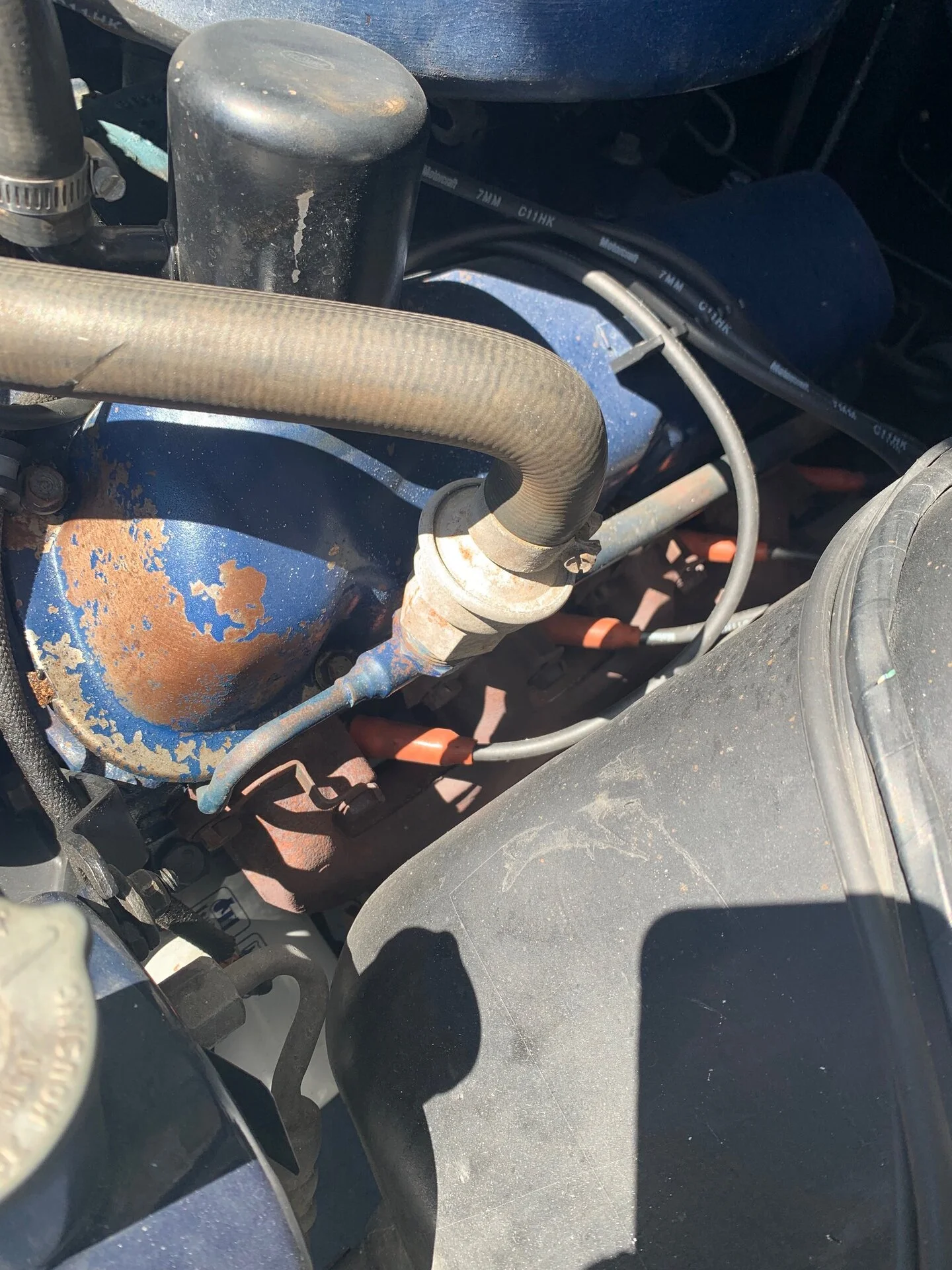

Hi All. So as it has been said, the smog equiptment was an option in 66/67 then sounds like it became standard in 1968. Not sure if that was CA only or all of the USA. Thanks for the comments and thoughts. Here are a couple pics plus a copy of section 12 in the Ford Shop Manual showing the complete Thermactor Exhaust System. For sure I will have to remove the valve covers to get those tiny nuts to loosen on the air manifold assembly.
