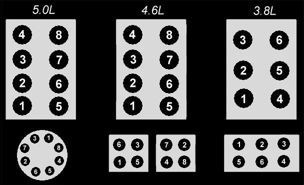

Only issue I had was the injector for No. 4 cylinder (see diagram below). This injector is located directly under the inlet piping to the supercharger. Took some work, but I managed to change it without removing the inlet duct.
