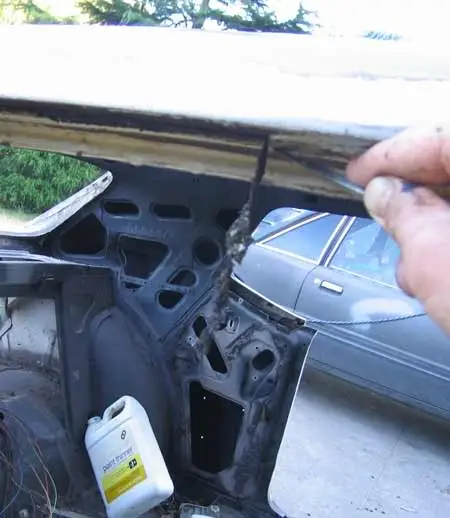

Okeydoke. I'm cleanin my car up for painting. I ripped the weather stripping off the door jams but there's a strip of goo remaining. Anybody have a secret way to remove this crap? I've accidently hit some of it with a wire wheel and it just spattered the sludge all over my face mask.. and wont come off too easy.. Evil stuff.
Thanky
I have had weatherstrip adhesive on a few cars that I tried using lacquer thinner or acetone to remove and was surprised that neither would touch it. Someone suggested that I use paint thinner so I did and it worked really well.
I ended up using a flat head screwdriver to scrap most off, then cleaned up with Paint Thinner.. worked pretty dang good!
Thanks guys :nice:
