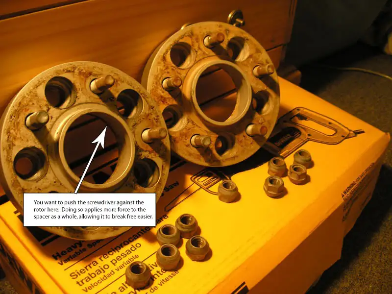

Pictoral explanation

Therian's picture helps out a bunch. I can see my last suggestion is impractical. I would NOT use a slide hammer w/ lug attachment either. You will essentially be pounding the C-clip in the differential and may damage or even shear it. The best way to do this at home will be with a torch. The aluminum will expand more and much faster than the axle hub. Use MAPP gas and run it around and around the spacer near the hub. It may take several minutes, but it will expand enough to just pull off (wear gloves!).

Therian - Thanks for the pic. explanation, I will try tapping inside there. I tried prying on the inside with a pry bar, with no luck, but didn't try tapping a screwdriver.
