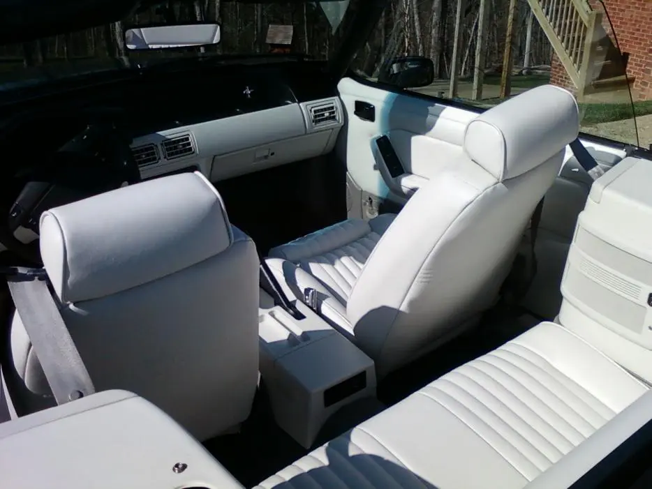

finished interior...
I finally finished and reassemble the interior. Once I cleaned them up, I did not need to paint some of the pieces. Basically, the plastic needed paint the vinyl did not. I must say that it turned out great. Even the vinyl seat skins look just like the factory leathers that they replaced for a fraction of the cost.
