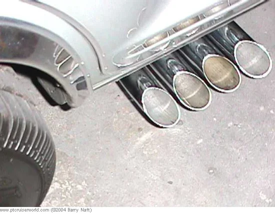

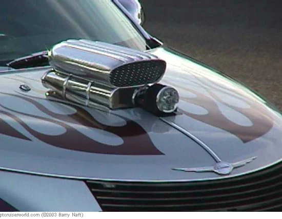

I had true zoomies custom made by a muffler shop a few years ago 4 into 2 into 1, looked and sounded great on my PT Cruiser, also made a fake roots type blower with a functional scoop. It's all fun...
