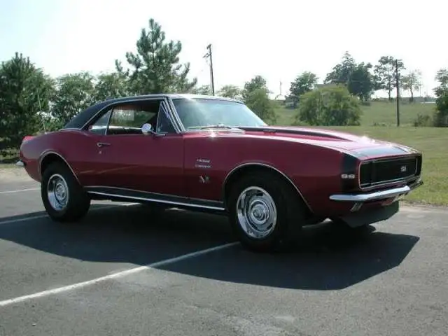

I feel you on the camaro....my friend just got done restoring a 1967 Camaro that had homemade floor pans and rust everywhere. He added up his reciepts the other day and he was just shy of $34,000. But now its perfect....even the underneath is clear coated. He had the newly built 427 dynoed at 588 RWHP!
I know this doesnt really belong on Stangnet, but here is a picture of his car:
