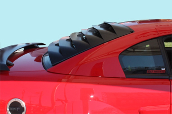

I happen to like the rear window louver look, and some years ago I bought a set from Visus. They've worked great all these years, I have no complaints. However, the latches that hold the louvers down were always a bit loose - and they've gotten worse with age. Visus has been out of business for some years, but MRT now has the rights to that louver design - did their parts fit Visus louvers? I called MRT and asked, and their techs said Yes. The latches were redesigned to fit better but they should still fit the Visus louvers. So I bought the replacement latch set.
The new latches arrived today, and I installed them as soon as I got home from work. All you'll need is a Phillips head screwdriver and a way to prop up the louvers. The new latches come with a metal bracket that wasn't in the Visus design, so I had to refer to MRT's installation instructions to figure out where the bracket fit. From what I can tell, the latch itself was redesigned to be easier to unlock by hand. The new metal bracket stiffens up the latch to help prevent failure, and both the bracket and latch fit tightly against the window mount. The MRT latch fits perfectly with the Visus window mount and holds the louver securely to the window. The old Visus latch allowed some play, which caused the louver to rattle against the window. But the new MRT latch has absolutely zero play in it - the louver might as well be bolted down. I highly recommend these latches for any owner of a Visus louver.
