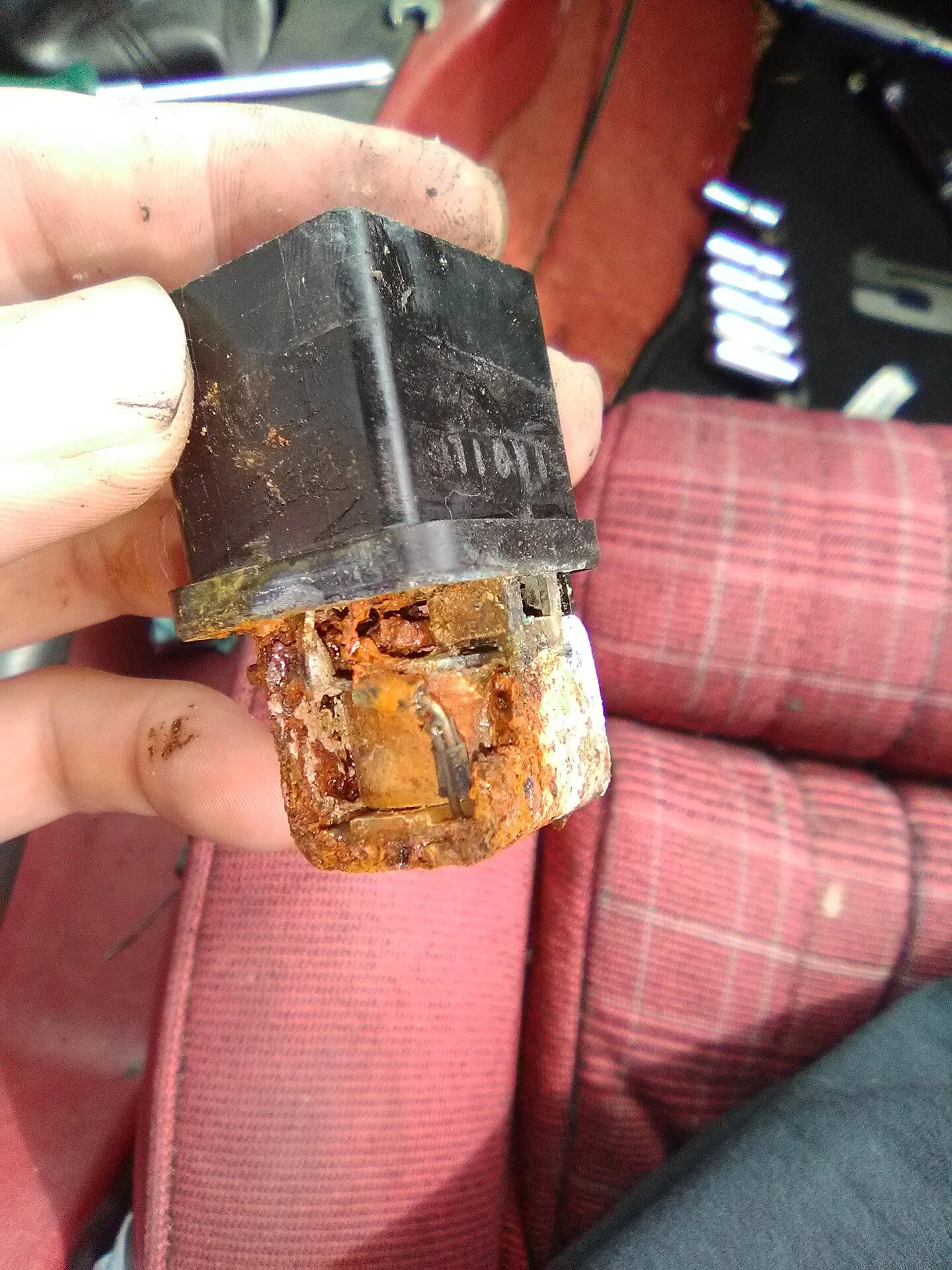

My PCM relay went out couple weeks ago. Was running fine, i was beating the :poo: out of my car just prior, drifting. Then i bet it heat soaked for its final time, and cut out as inwas heading home driving normal..
But this is what i found... Lol.
I lost all fuel, no prime and spark. I bought mine from LMR. Its been good so far.
