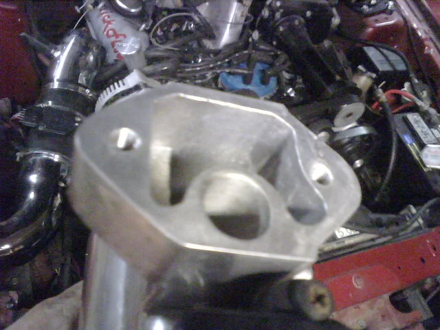

I was following the checklist for resolving the surging idle issue I had when I came across the culprit. My Performance Product throttle body doesn’t have the same air port as the IAC. I found that 90% of the IAC's flow was blocked off by the gasket. I ended up ditching the gasket and using RTV. My idle is now almost normal.
