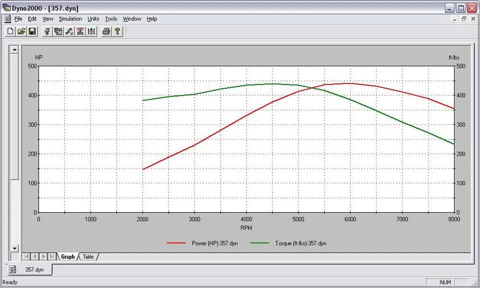

In my opinion a "hot" engine should have at least 200 ft/lbs off-idle. You have to get moving from a stop quickly, and you can't go around town dropping the clutch at 3,000+ RPM all the time and a 3500 stall converter is getting pretty loose for street use.
As has been mentioned everyone has a different opinion on the meaning of "streetable" but that engine (above) is not streetable according to my definition. it is not a matter of right and wrong, simply one of preference. My engine should have about 400fw ft/lbs from 2,500 all the way to over 5,000RPM, with the assistance of a longer stroke and more displacement of course. Horsepower will peak at 6K in the 425fwhp range and drop off from there.
Here's what Desktop Dyno showed:
EDIT: This is with 357 cubes from a '69 Windsor block, 2.02 intakes/1.60 exhaust in aluminum heads, cam is a 224/236 .506/.506 custom with 110LSA, Holley 750 vac-sec, 1-3/4 long tubes, and an RPM intake, compression kept low at 9.5 for cheap gas and AT/PDB.
All good points Edbert. To tell the truth, my rule of thumb is 175 lb/ft @ 1500RPM as being really & truly streetable. I picked the parts for my first go round in about 5 minutes, and since I had some time later, I re-did the 289 combo with *gasp* AFR205s, 10:1, 650cfm 4bbl, PerfRPM, TriYs, and a custom solid flat cam (secret specs ). It put out 398hp & 357tq, with 155tq @ 1500RPM, which seems do-able enough for the street if you're hell-bent on 400hp.
