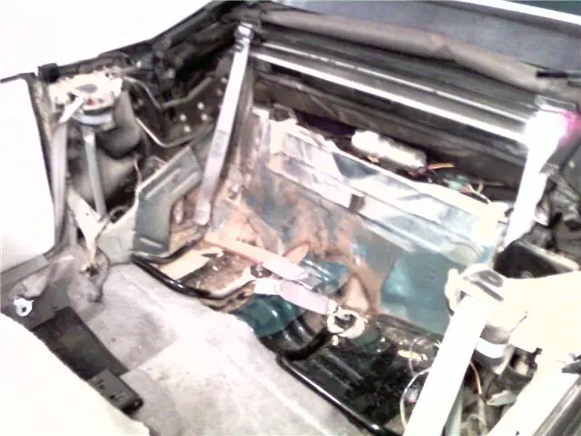

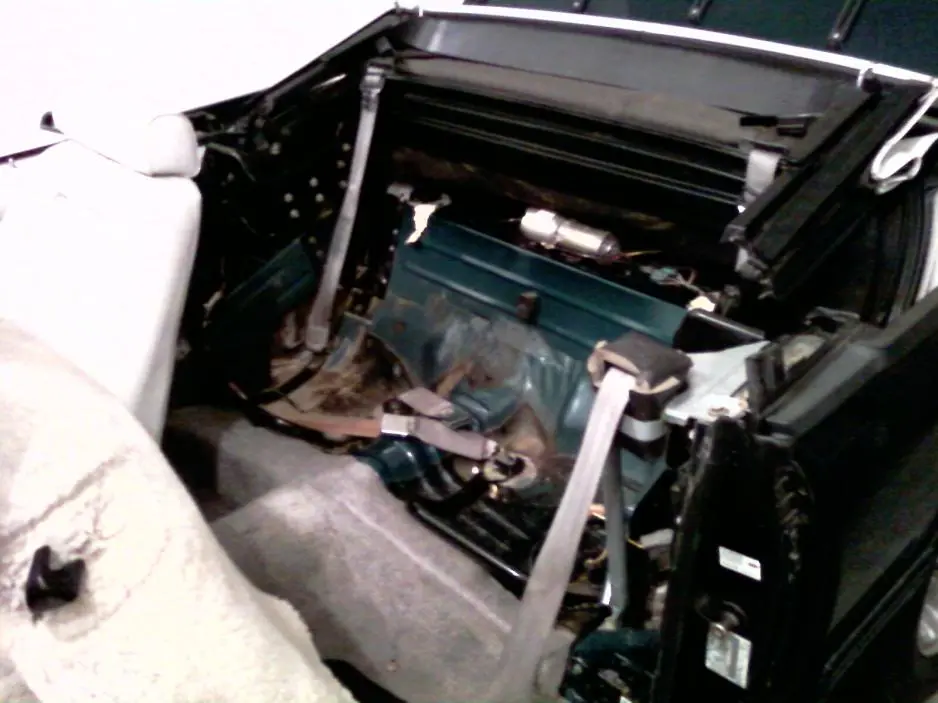

Well... Most of the interior is out. Now I just have scrub and get the balls to paint.... You would not believe how much dirt was behind the panels... One picture before wiping down and one after.
While it is apart, I am going to replace dash light bulbs, scrub and clean anything my hands will reach. Find a factory CD head unit to replace the cassette, freshen the electric front windows, etc....
