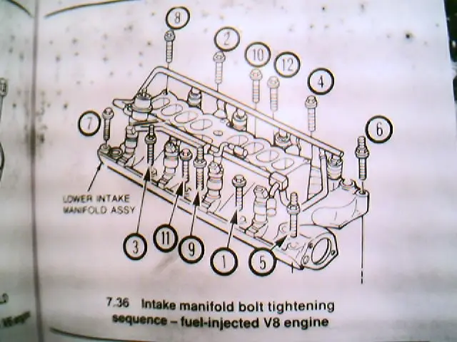

Silly question but I was out putzin in the garage when I decided to throw a torque wrench on a few of the lower intake bolts..the two inners I checked were near perfect so I jumped to the outer corners..they did take some tigtening to make torque. My question is being this is my third torque on the lower bolts, once at 100 miles and second at 300miles...can any harm result from not using the torque pattern secified and just doing the outer corners in the X patern?

The proper torque pattern on the lower intake has the 4 most central bolts torqued LAST in the sequence, not first. Perhaps you used the wrong torque pattern in the first place -- if you did, my experience has been that they will keep loosening up on you.

It's hard to describe the proper sequence without a picture. But I'll try.
There are 12 bolts for the lower. The 4 middlemost bolts (2 each side), the 4 corners (2 front, 2 back) and the OTHER 4.
The proper torque pattern is to tighten the OTHER 4 first in an X pattern; then the 4 corners in an X pattern; then the middlemost 4 in an X pattern.
If they're not staying tight, I'd pull the upper, lightly back off the bolts one at a time, and retorque them in the proper sequence.

good to know, i'll admit i did mine wrong, - i think i'll back them all off and do it in that sequence... i don't feel like pulling my upper off more than once after it's done - i think i'll prob have to adjust my roller rockers when we get the car running anyway, so when i adjust my RR's, i'll also retorque the lower intake, heads, and header bolts - nething else i should torque? lol glad i read that
