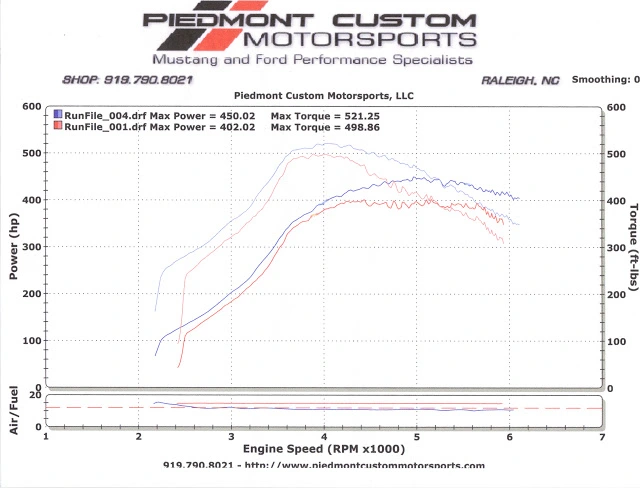

.....450rwhp/521rwtq SAE @ 12.5lbs boost!! Very happy with the numbers, boost is falling hard(down to 9/10lbs) after 4500rpm, need turbo smart boost controller so it will hold the waste gate closed. The eddy intake is the cause of the boost drop. Also I have 4-6 bad COPs and also the O2s are also bad. My Brother said w/ just installing new COPs/O2s it should pick up 15-20 more hp. Just from the tune I picked up 50rwhp and 21rwtq. Not bad after two pulls. I dont have a before and after intake dyno sheet, however I have one before and after tune. I did look at the old dyno sheet and It looks like I made 67more rwhp @ 6000rpm over the stock intake! VIDEO YouTube - New Dyno Tune Numbers Turbo 2v Mustang GT <----Recorded on cell phone cam..

yea, i dont see that engine lasting long at all at 450hp and 12.5lbs of boost. good numbers tho. to bad there sae.
Im kinda lost here? "to bad there sae." <---- how so? SAE is industry standard for dyno numbers. The car w/ STD made 470rwhp...so im kinda lost here? Also I've been driving around with 14+lbs of boost for months now... Also ask sneaky there, I hot lap my car at the track till they closed and then drove 2 hours home, no issue:shrug:

Yep same thing happened to me as well. I think the intake is flowing so well and the waste gate cant keep up. Im going to need to install an electric boost controller to adjust the boost at higher rpm range.

I hear this all the time and it's bull-*****. There are plenty of members around here pushing the 400+rwhp mark on stock blocks. I've been pushing 428rwhp for over 2 years with no problems and had a blower for 4 years. It's all about how you treat the car, if you don't dog on it every day and hit the rev limiter doing donuts and launching nonstop and you change the oil on a regular basis then there is no reason why you can't have a healthy 450rwhp on a stock block.
There is one member around here pushing upwards of 470 on the stock block with no problems.
