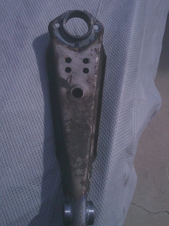

I did just that with the open tracker kit.
butt load of work. You'll need an air grinder to grind off the rivets...then we punched them out. an air chisel would have made easy work of it. You then need to open the opening a little by simply grinding it, then welding on the sleeve
