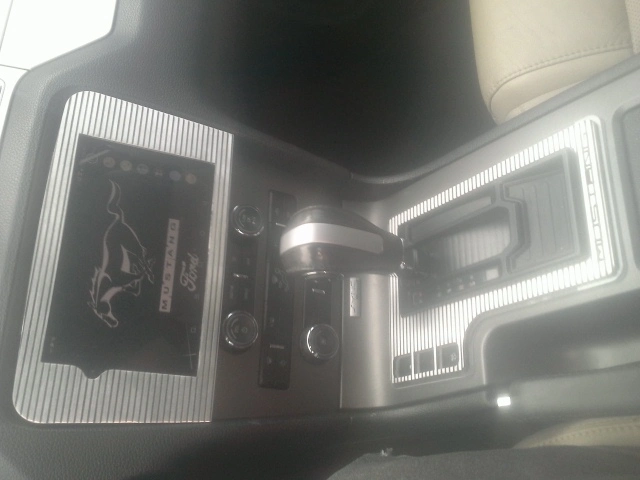

Hello all from Ventura CA.
I own a 2014 V6 convertible premium edition. by trade i'm a fabrication specialist (metal mostly) and I have lots of ideas for this car and have already made some small custom parts. Right now I'm trying to expand on my rgb led ambient lighting. I'm trying to find a part number for the leds but even ford dealer ships can't find anything. I've tried buying ones off the net but haven't found one that works right. I've made a custom billet cover for my center console around my shifter with plexiglass trim. so I'm trying to hook up some leds to it. maybe someone has already done something like this and can give me some help, thanks.

Yes, specifically the ones that attach to the cup holder. I don't know much about led lights either. the only thing I've been able to find out is that they're RGBWA lights for red, green, blue, amber, white. I did get one kind of rgbwa to light when I wired it. but when I changed the colors it wasn't matching up with the rest. I can purchase the entire lighting system from ford parts but I don't need the entire system.
