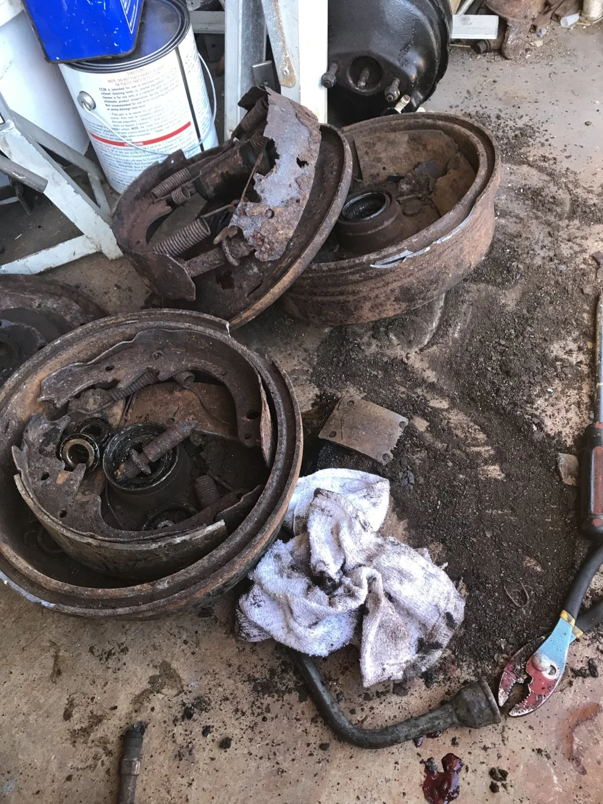

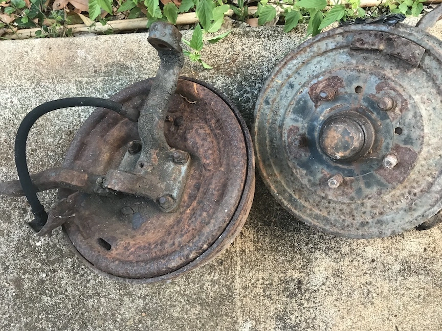

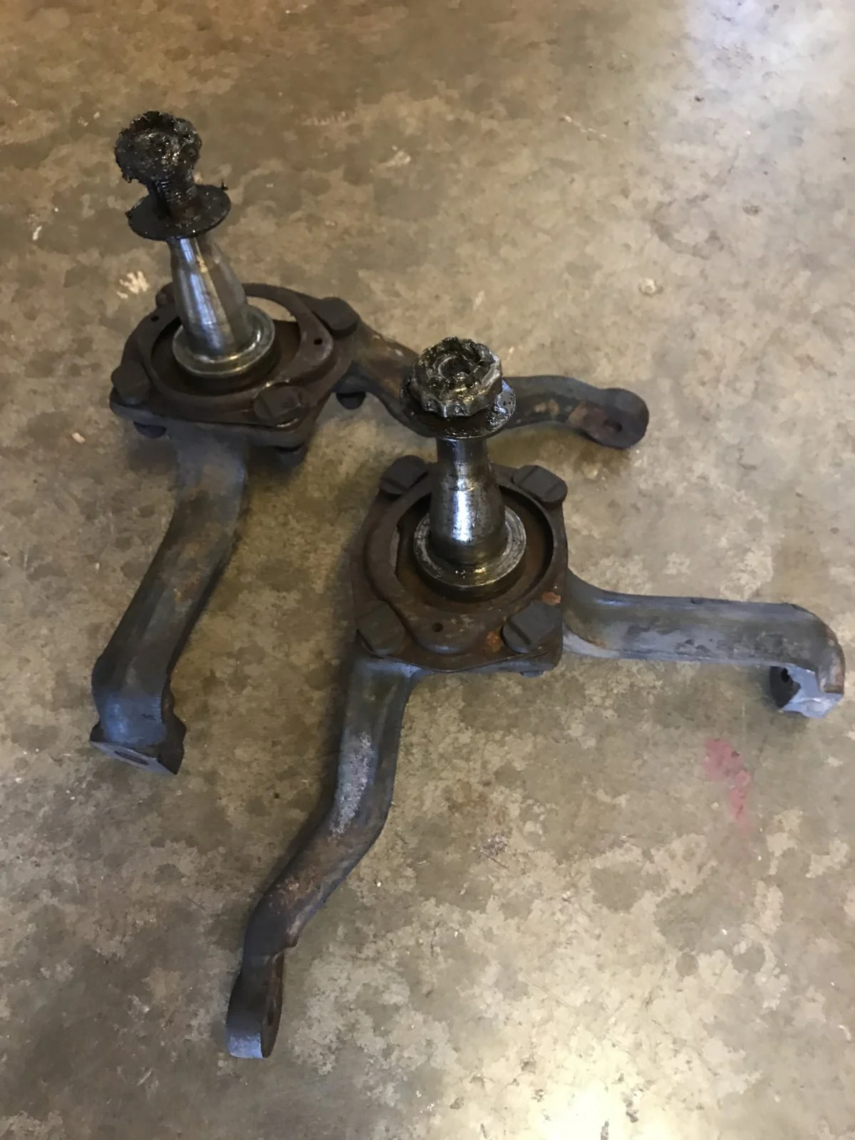

I harvested this pair of spindles a little while ago for Member seanw
Was a bastard with the shoes fused to the drums and all hardware rusted solid ( 30+ yrs sitting in shed)
I hit it with 2lb sledge... a lot...Spray...most of can...Torch... till tank ran out...many new and colorful verbal language enhancers and finally beer helped
Being on the car would of been easier to do...maybe
good luck!
