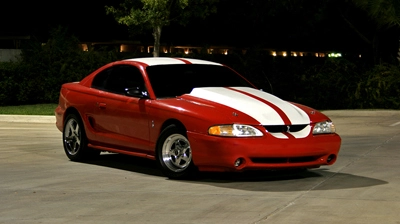

Does this happen to anyone else? This is my wheel set up (daily driven)
and I've never had my abs light come on.
It's because all your tires are 26" or so in diameter. The ABS light will trip when it sees a substantial difference in revolutions of the tire, front vs. rear. For example if you had a 275/60-15 rear tire, which is 28" and a 275/40-17 front tire which is a 26" it would trip the light. The car doesn't care what diameter the rim is, it cares what diameter the tires are.
If you wanted 17s up front and 18s in the rear, something like a 255/40-17 or 275/40-17 on a 17x9 up front and say a 295/35-18 on a 18x10 in the rear would work fine, because the tires are all around the same diameter.
