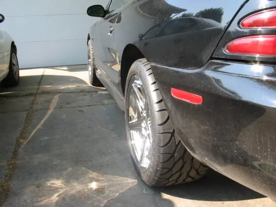

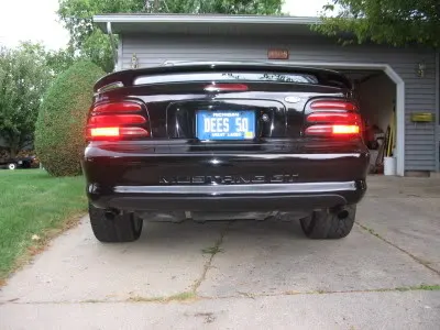

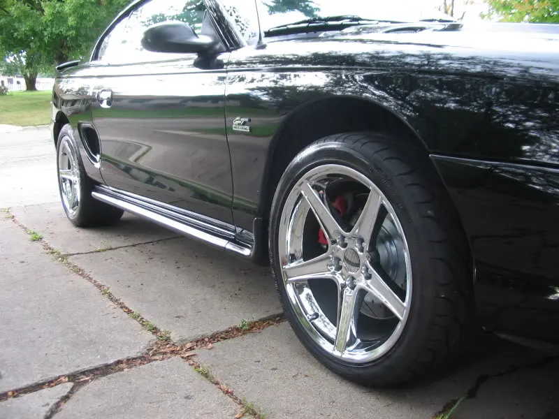

I would recommend a 295/35/18 for the rear on a 10" rim. I would stay away from a 315. You probably could do it, but a 10.5" would be much better suited and would fit better.
I run BFG TA KDW's and they do a great job and look great.
I don't have any closer angled shots to show you the wheel protection of the tire, but it's good.
