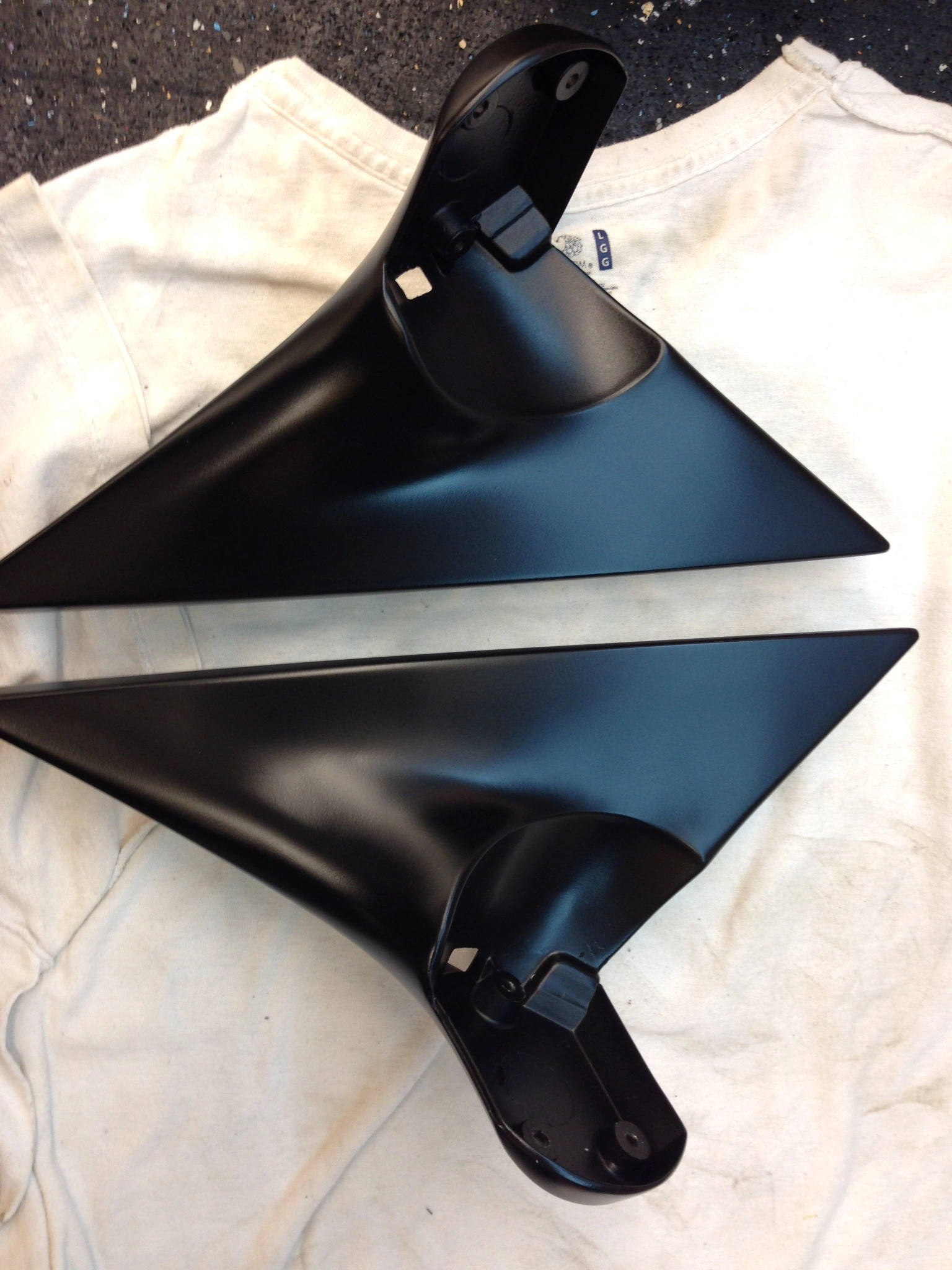

I just keep finding more things I need to do. Now that the carbon fiber cowl is done and in place. The mirror bases not matching are bugging me. So lets get some carbon fiber ones done.

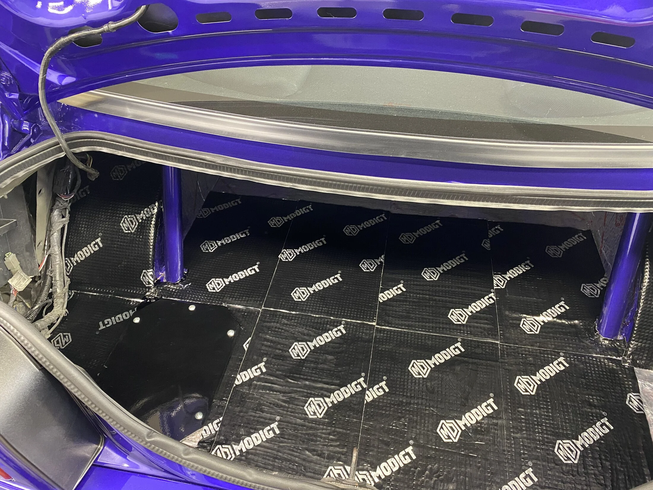

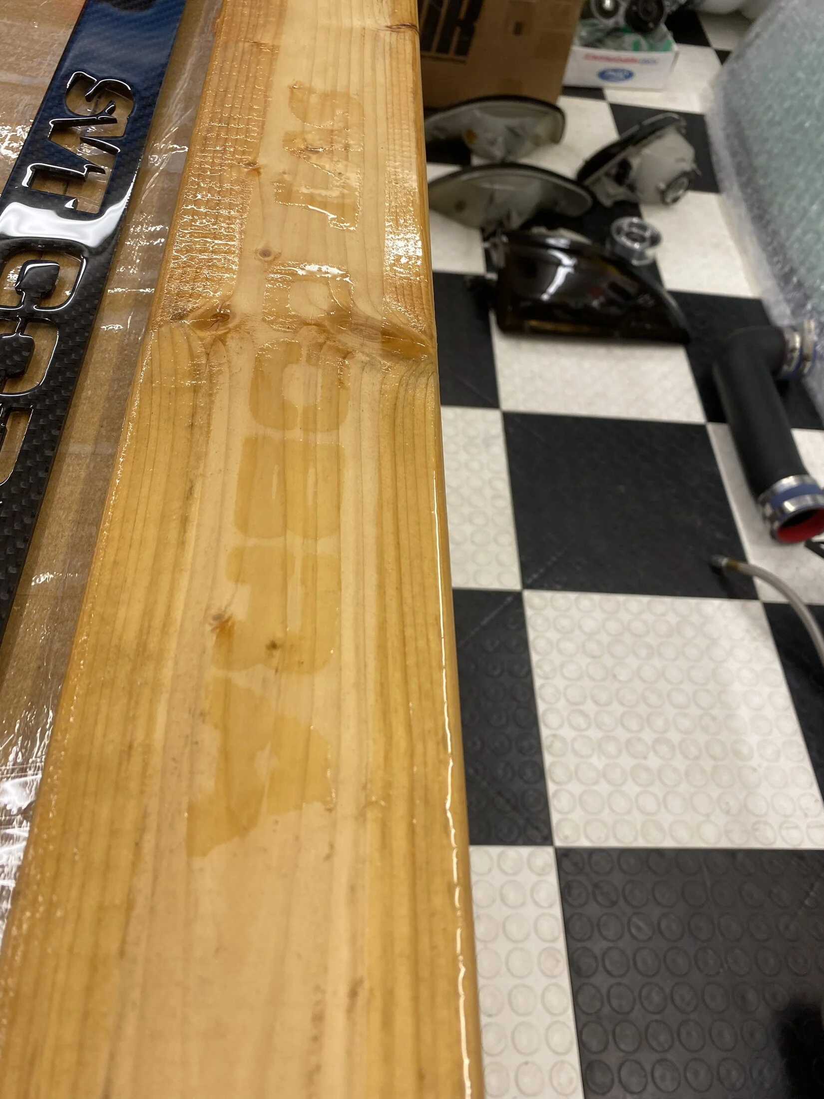

Getting the trunk ready for some finish work.

Why do I always see dynomat (and/or the like) installed in patches? How much more dampening do you get from wall-to-wall deadener?
You need all you can get on a mini tubbed car with sheetmetal trunk floors and tubs. It makes a huge difference on roofs but the rest is more window dressing

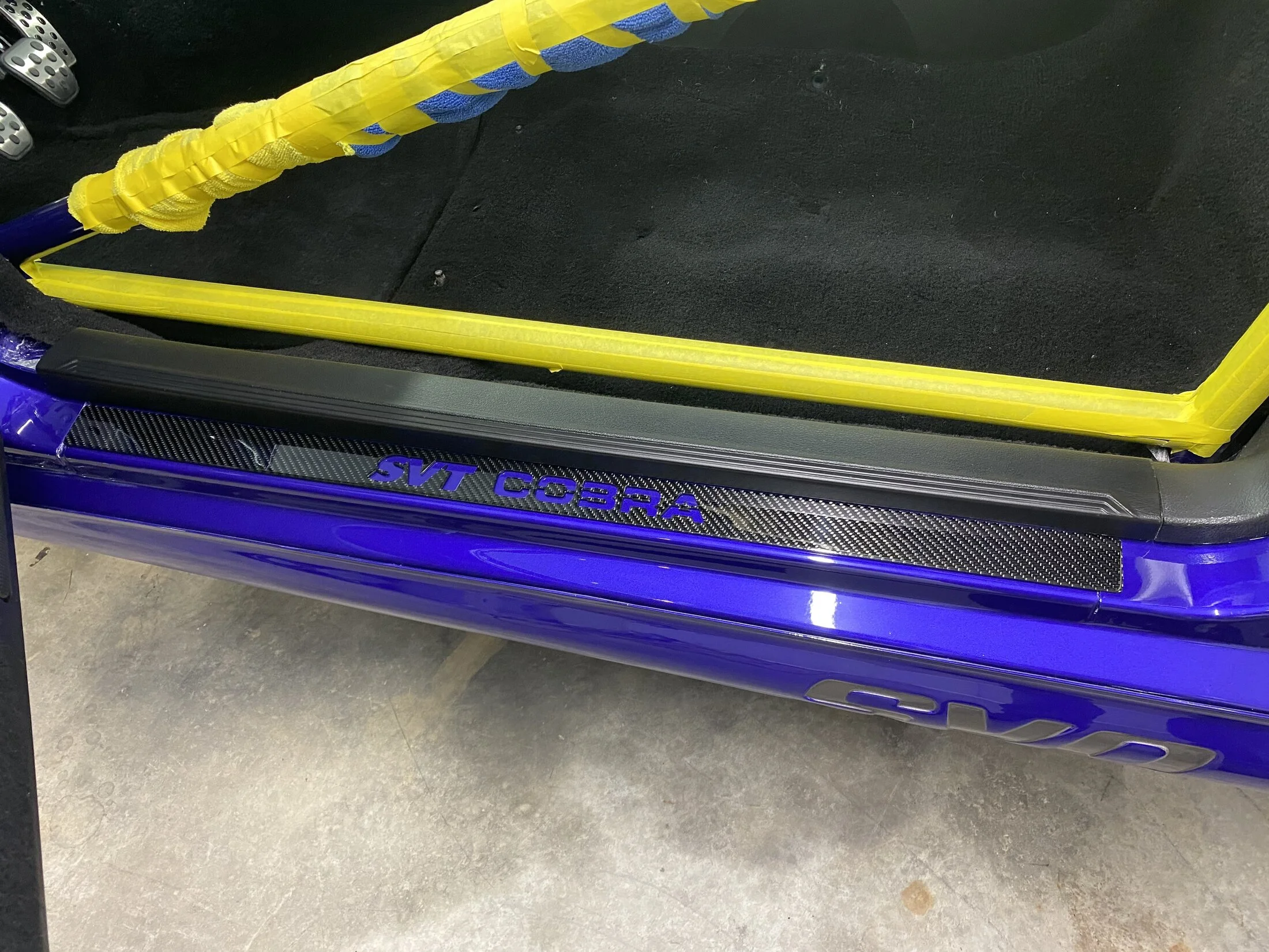

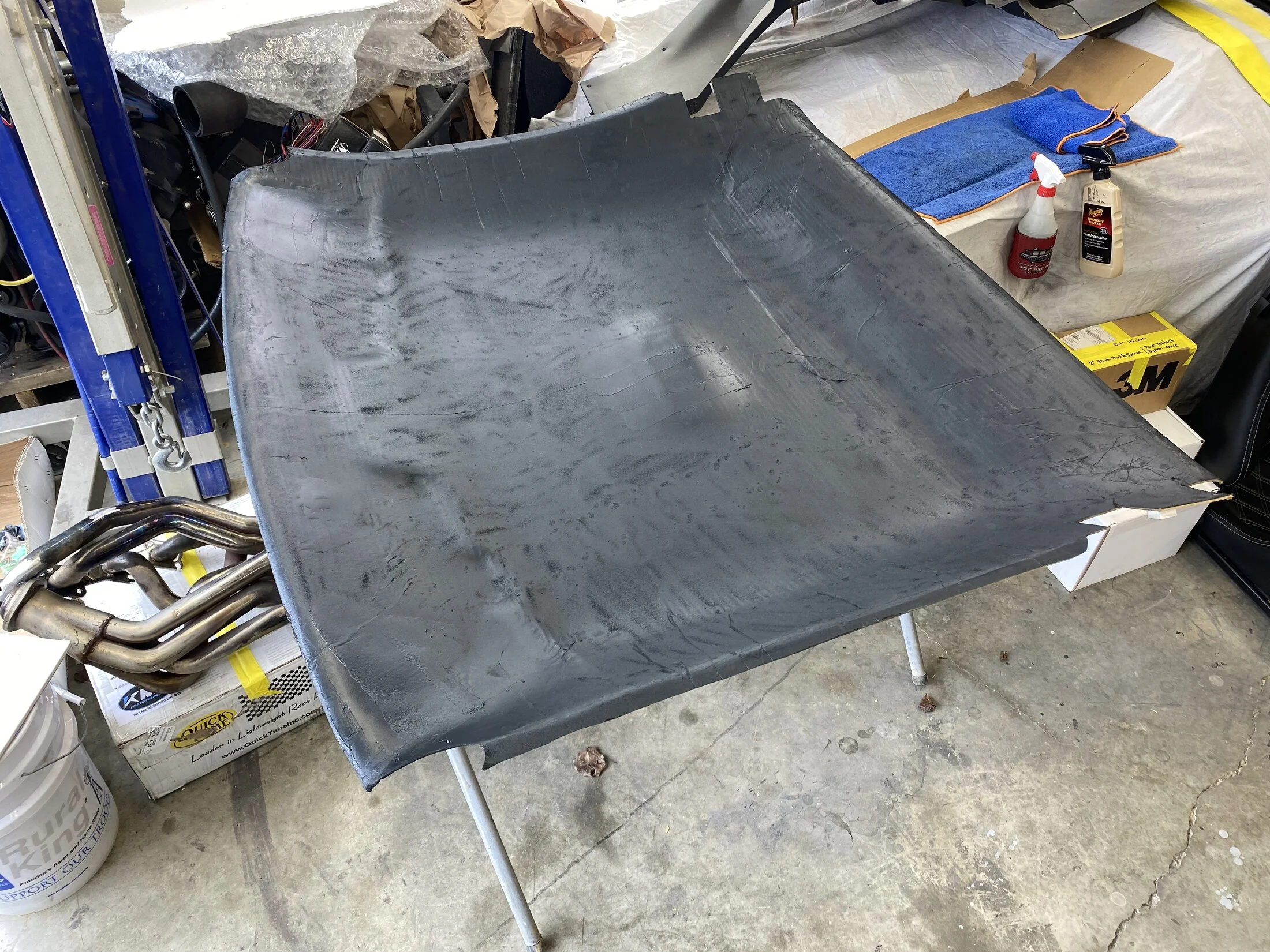

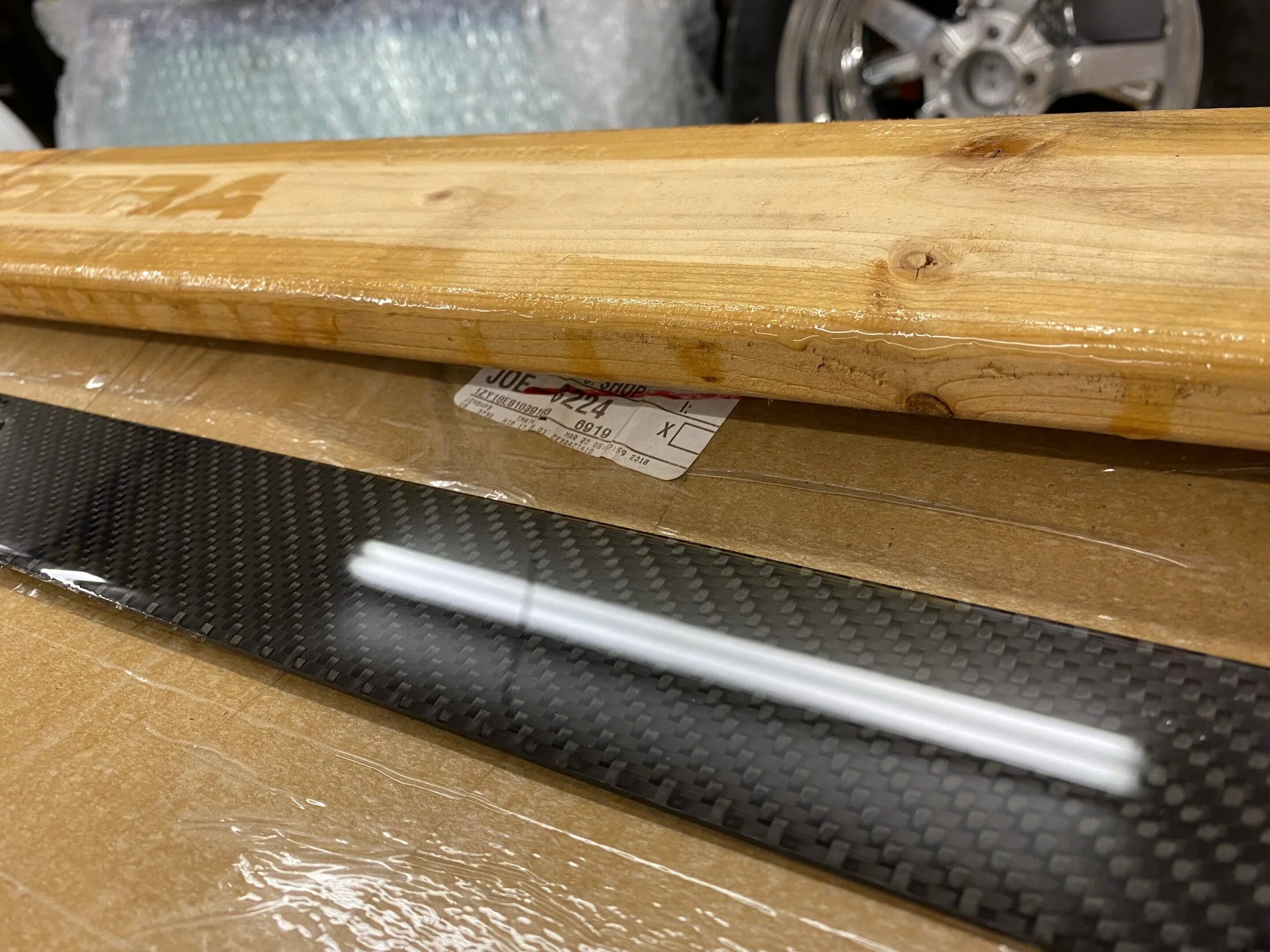

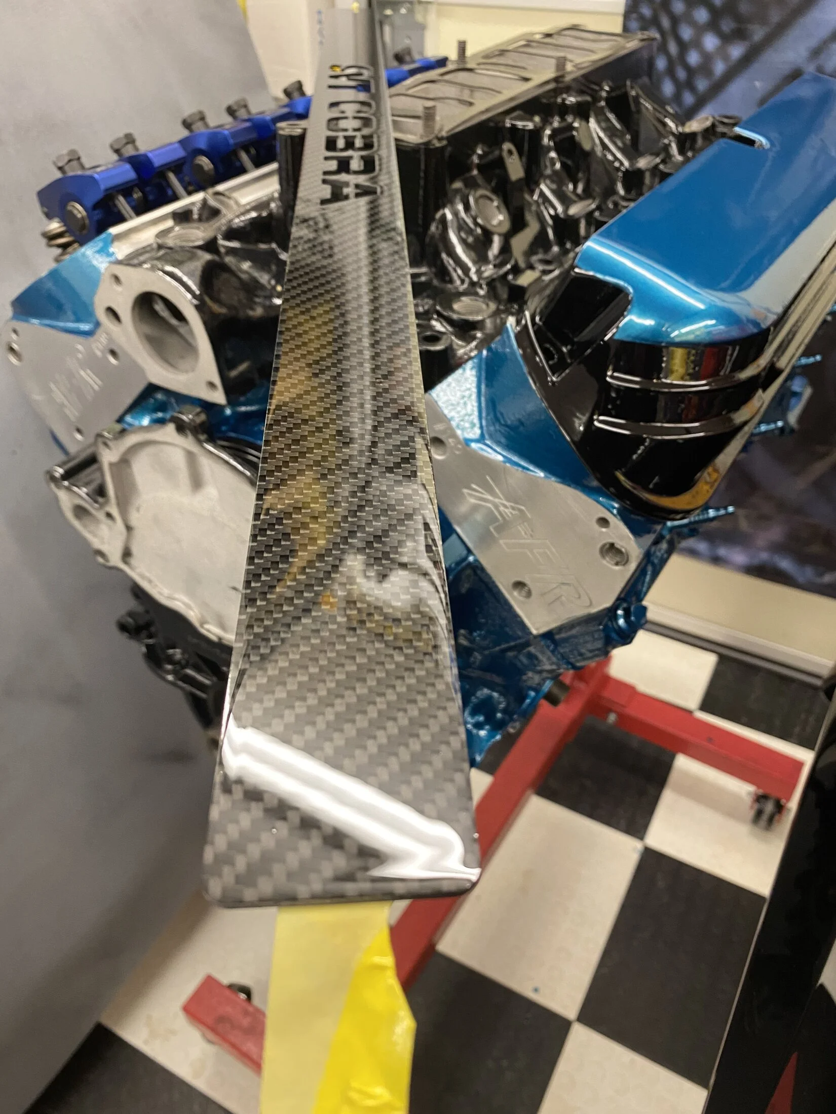

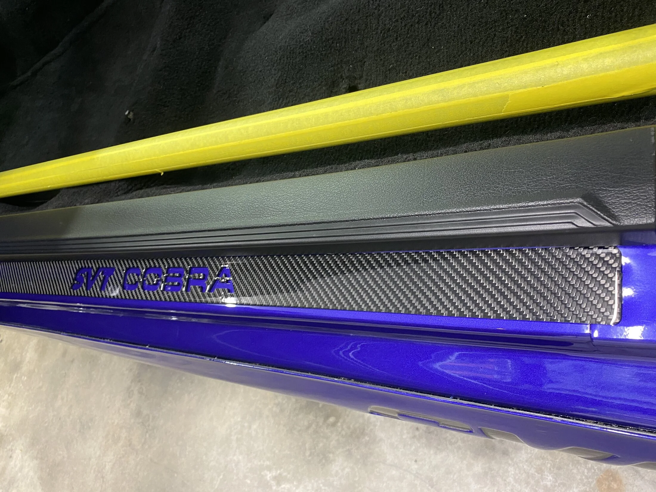

Headliner board is done and ready for leather material. More cabon fiber (door sills) and just like paint, I love burying it in clear.

Wait a minute, what is that black/blue AFR headed engine going in?
You kno how it is. Always got cool
Stuff in the background. Thats a 363 Dart that I built for a customer car Im doing. Getting the look right now/

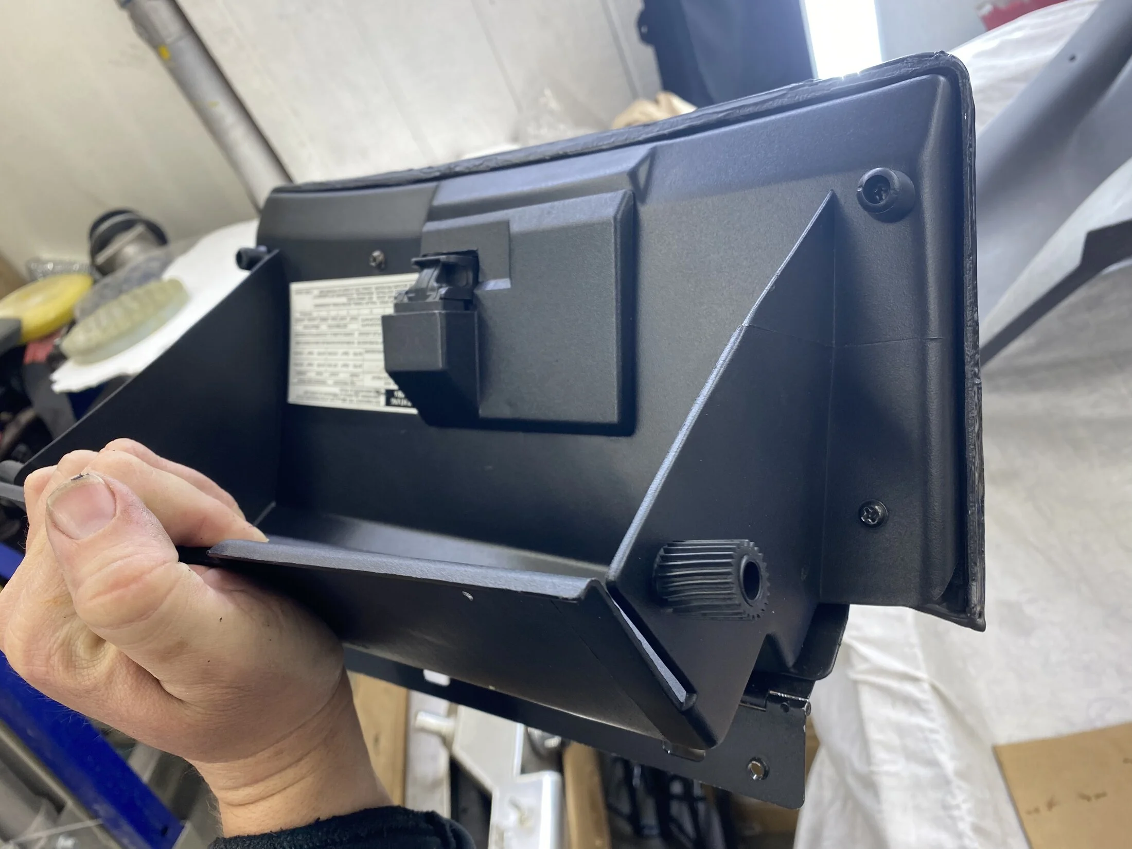

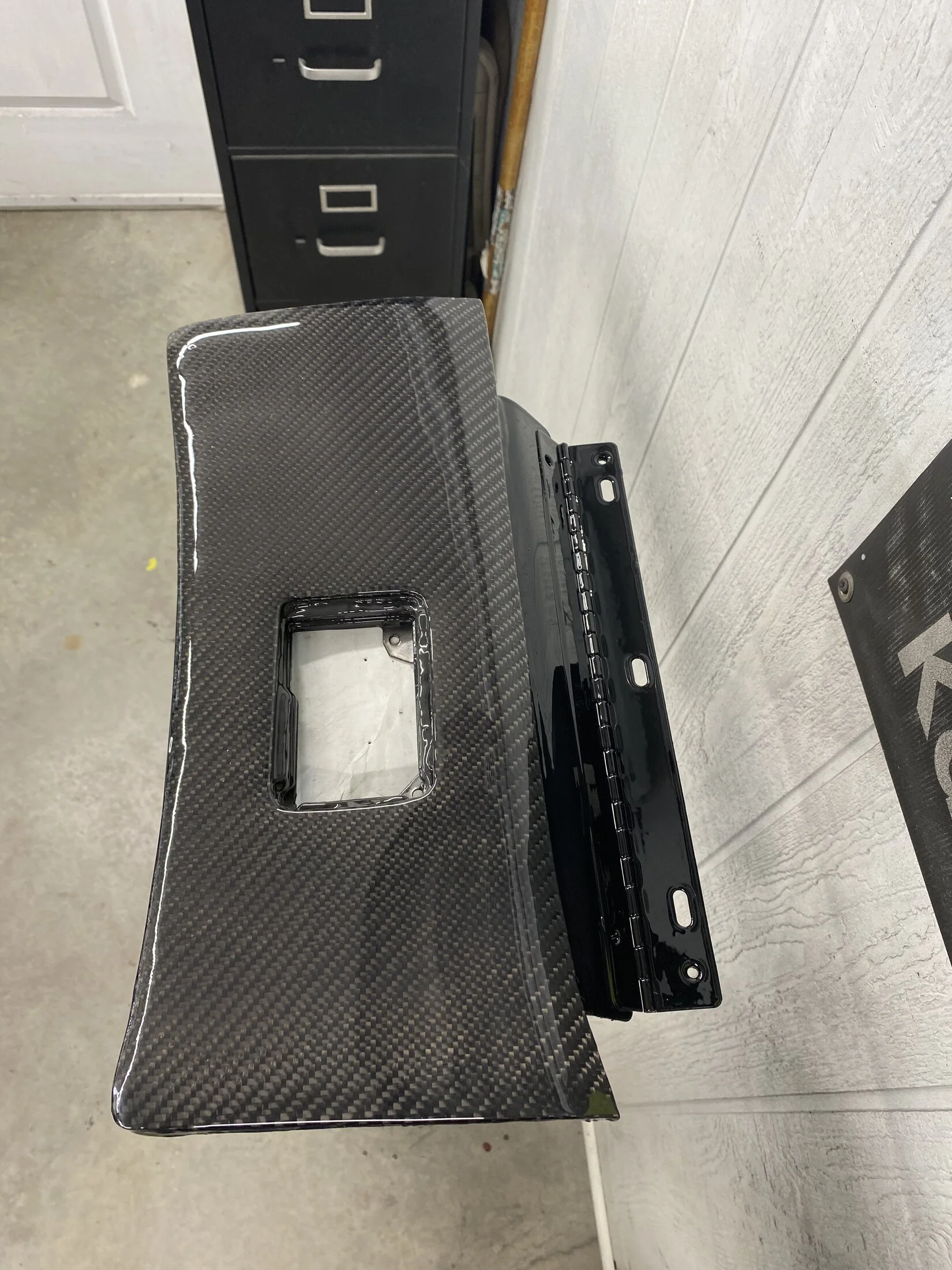

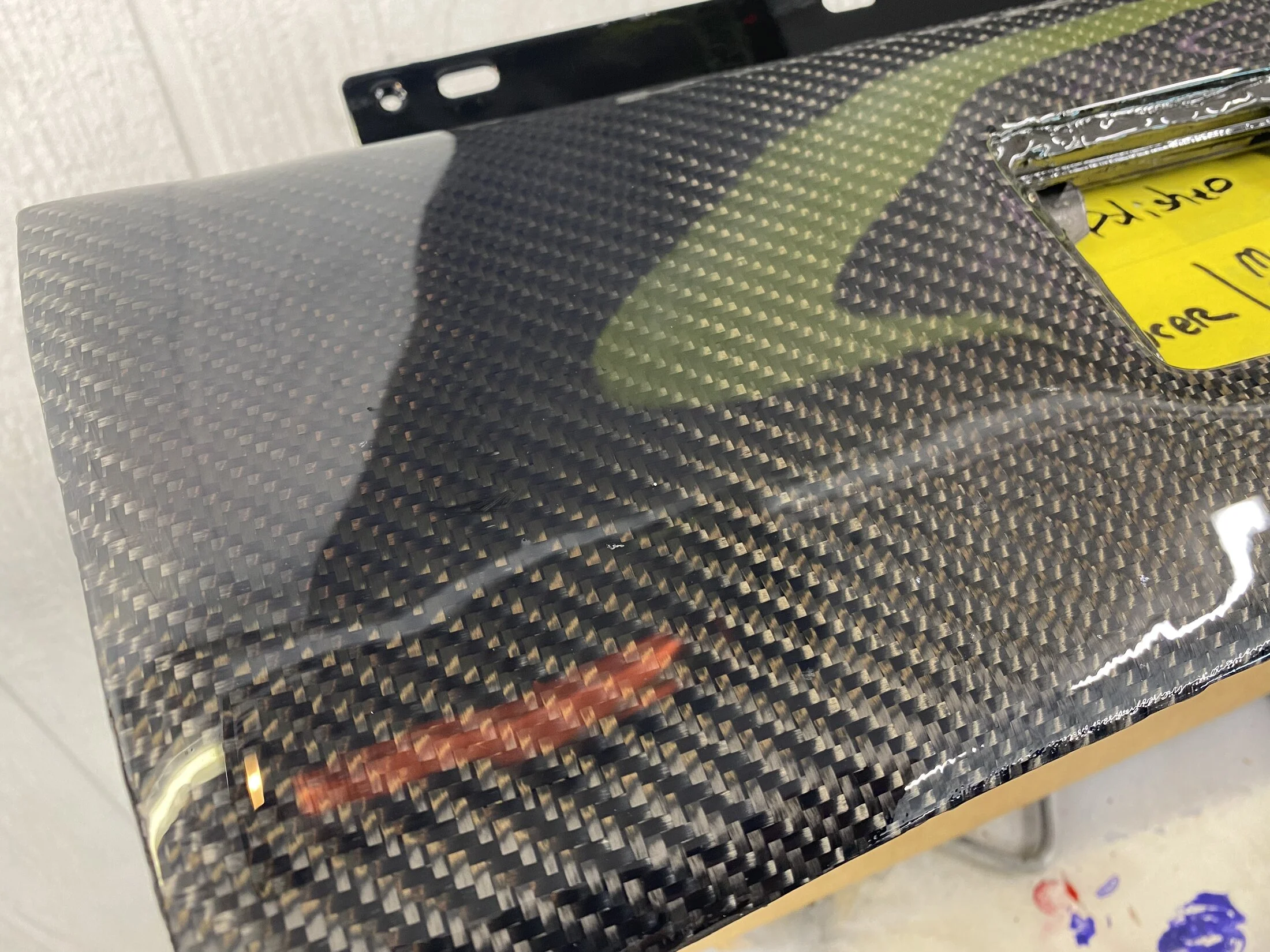

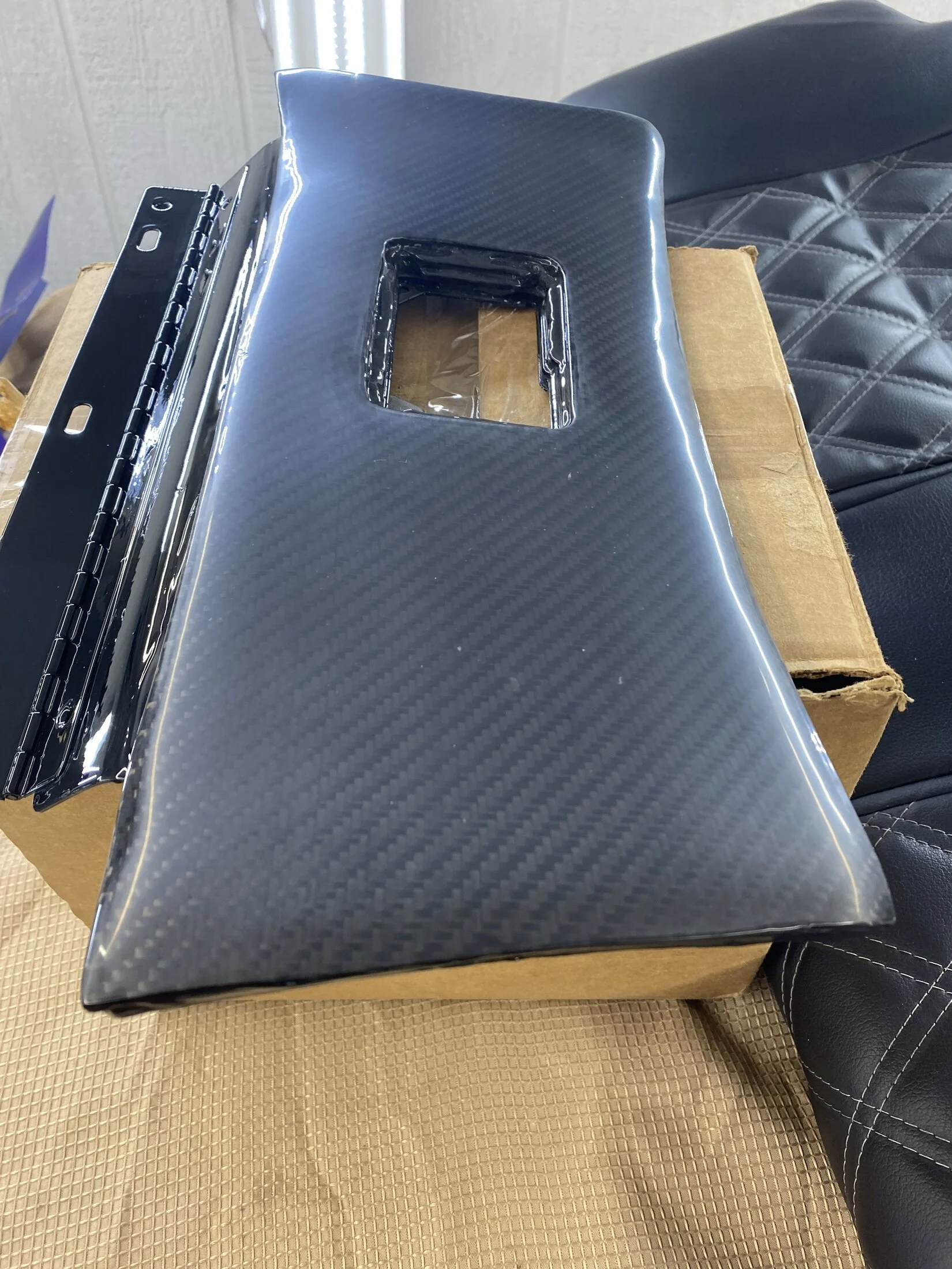

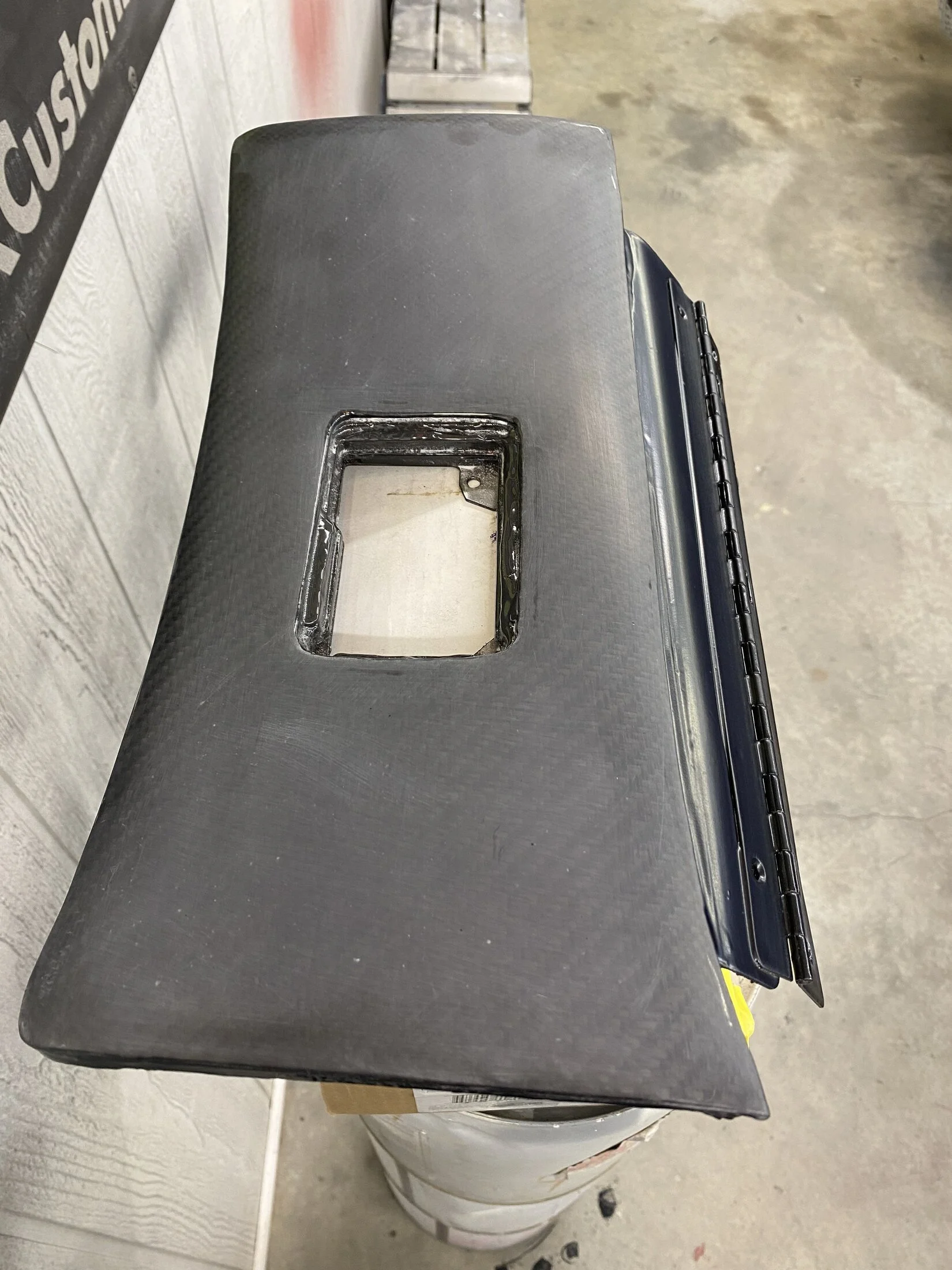

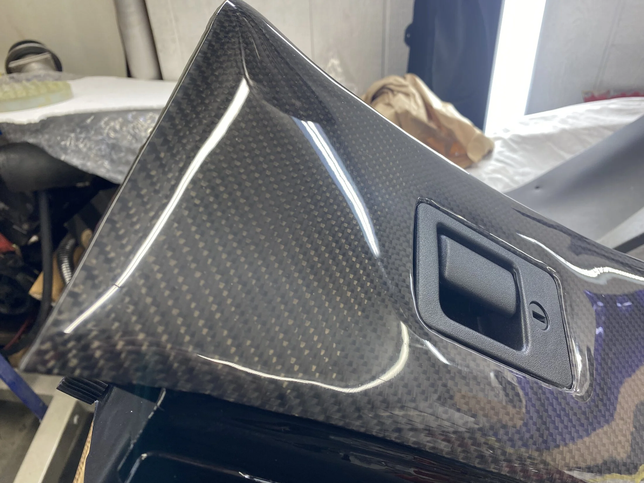

Working on a carbon fiber glove box. Thought I would show how it comes out of the mold. Then its lots of sanding and either resin or high grade automotive clear. And repeat for best results.

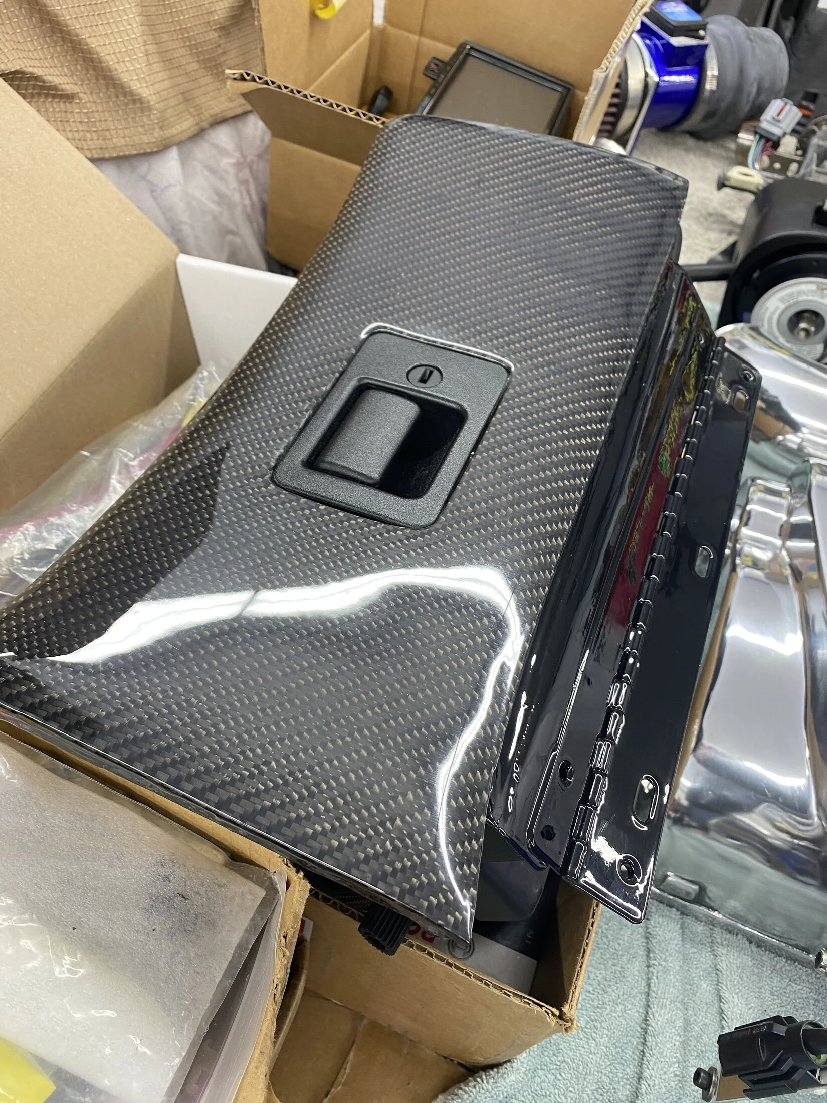

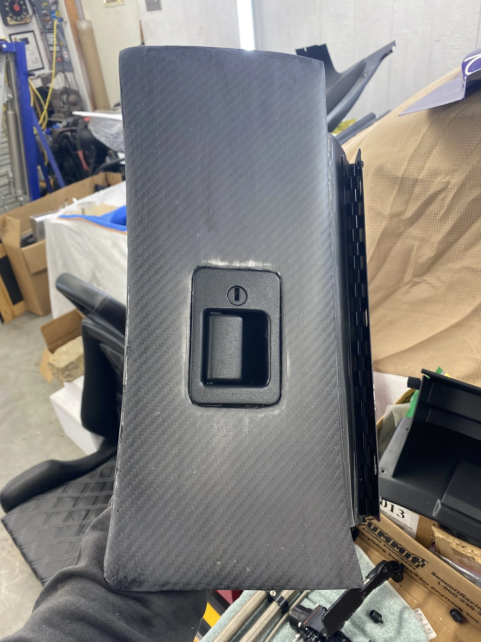

Eights coats of clear later. Sanded between every 2-3 coats. Glove box done
What are you cooking the part between coats with that you get this done so quickly?
Baking it in my paint booth. 15 min bake cycle and good to go. I did that on my final clear this morning and already got it sanded with 1500, 2000, 3, 4 and 5000 grit ready to be polished tomorrow

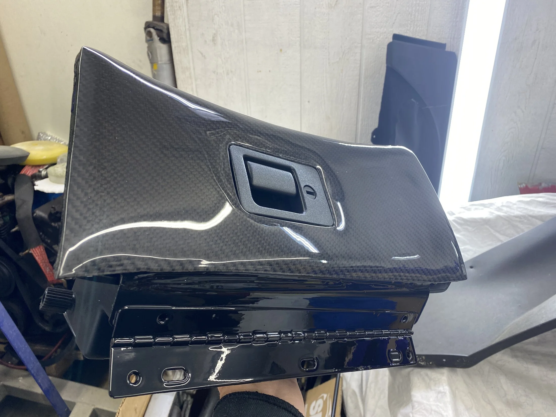

One finished up glove box. Now I need to finish wrapping the dash.

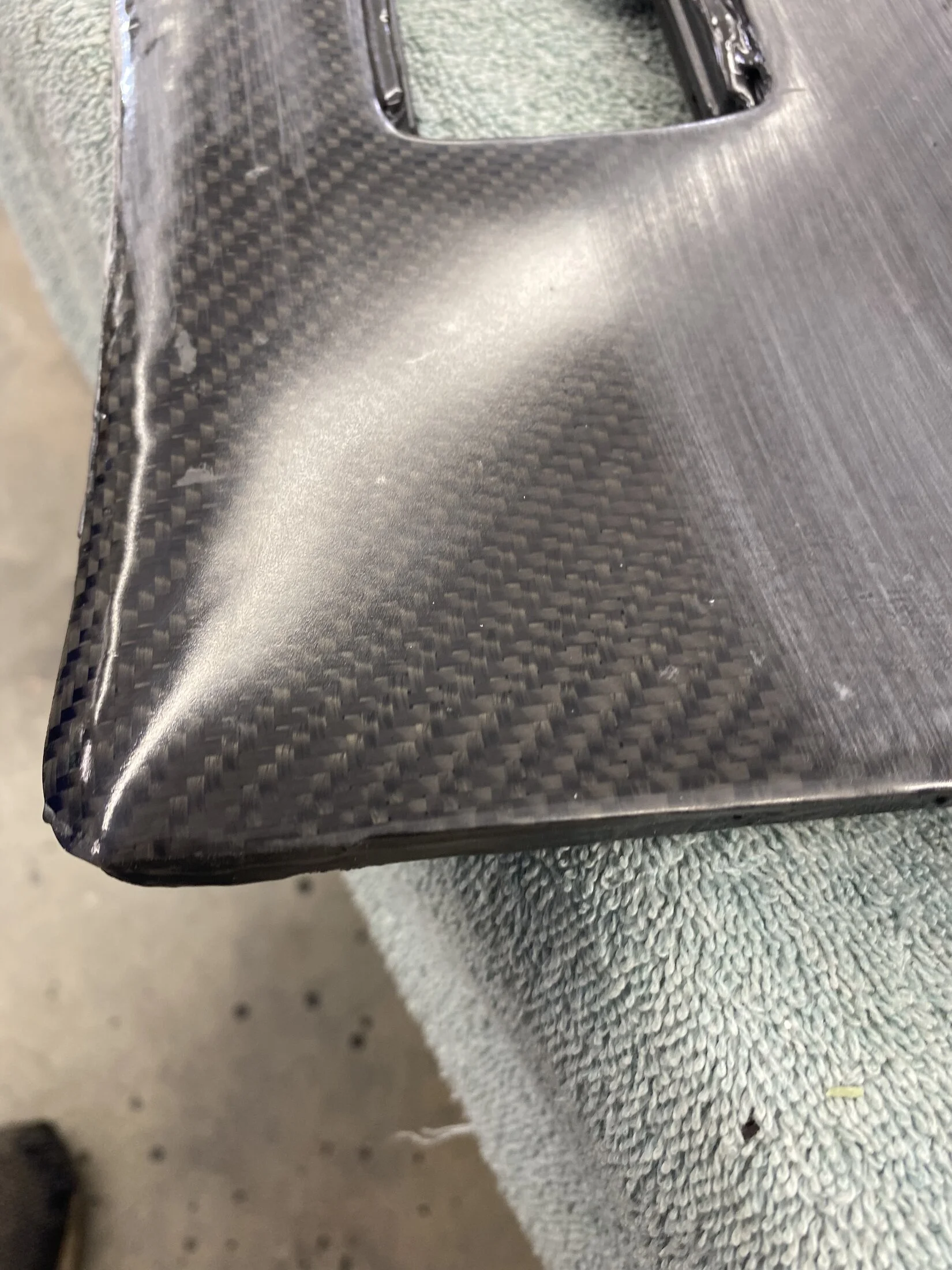

Lots of sanding.
Lots of sanding.
How good does all of [that] hold up? Is this a show-car only kind of finish or can you street these when they're done?
Its just a grocery getter. So mainly Plan on driving it. Doubt I’ll do many shows after the first one. It will hold up to street use.
