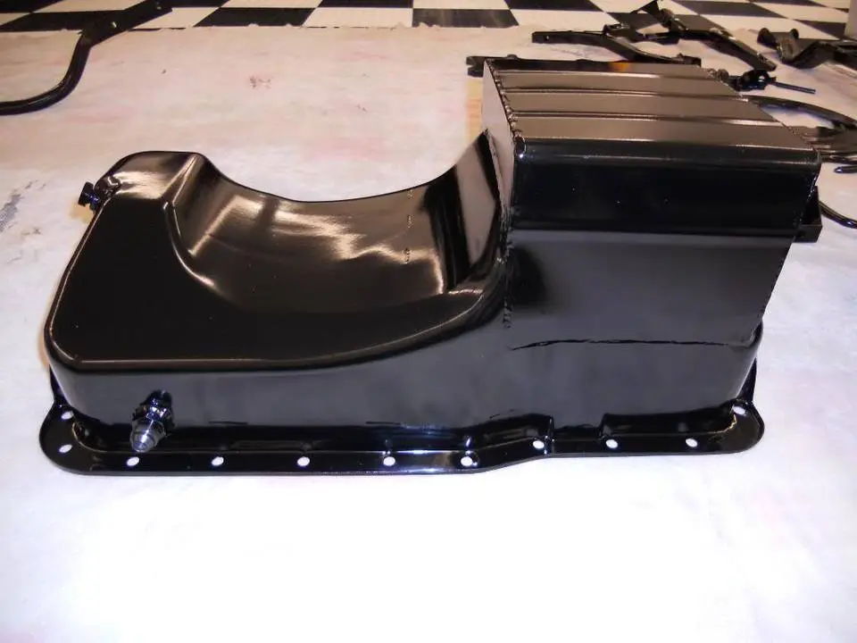

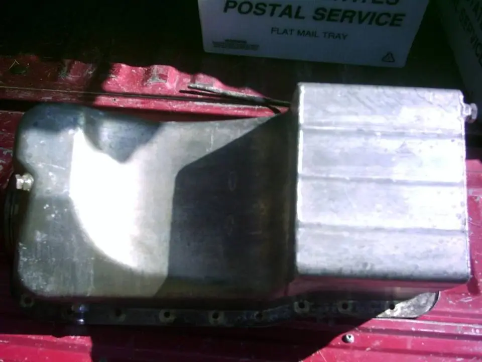

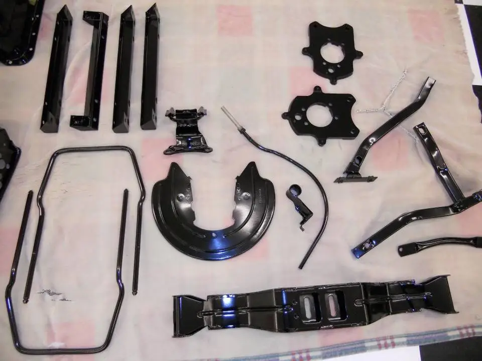

As promised parts fresh baked out of the oven
Oil Pan off my old burnt car.
Hopefully it will pass now

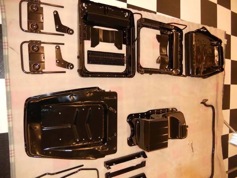

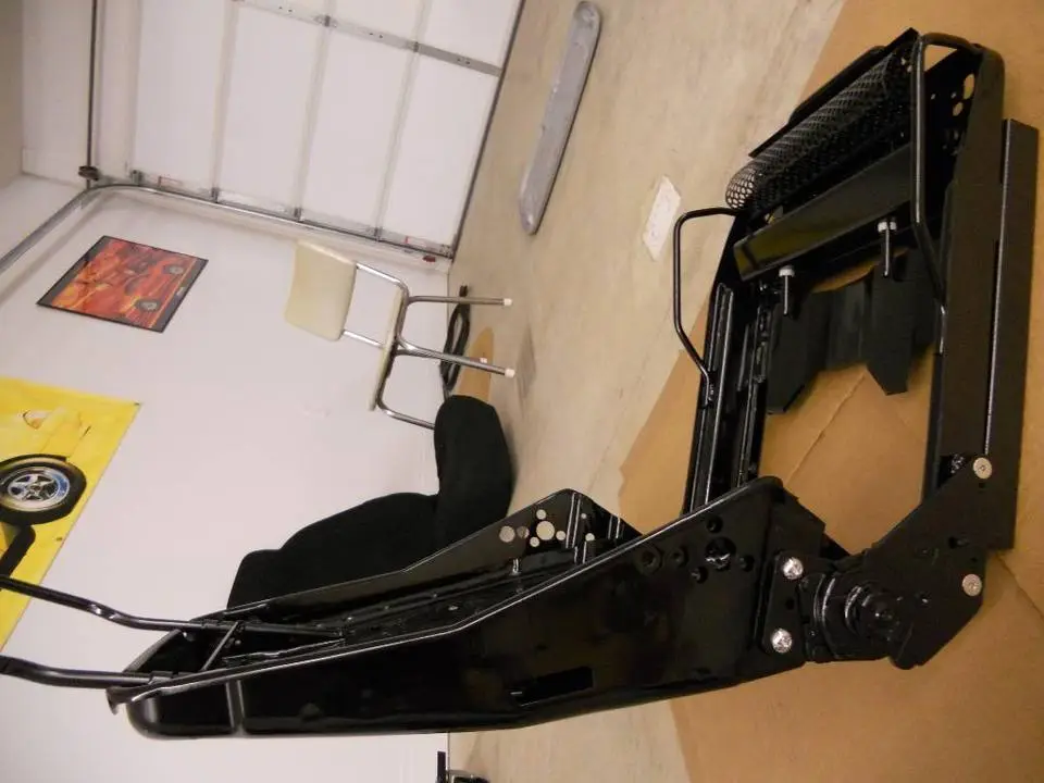

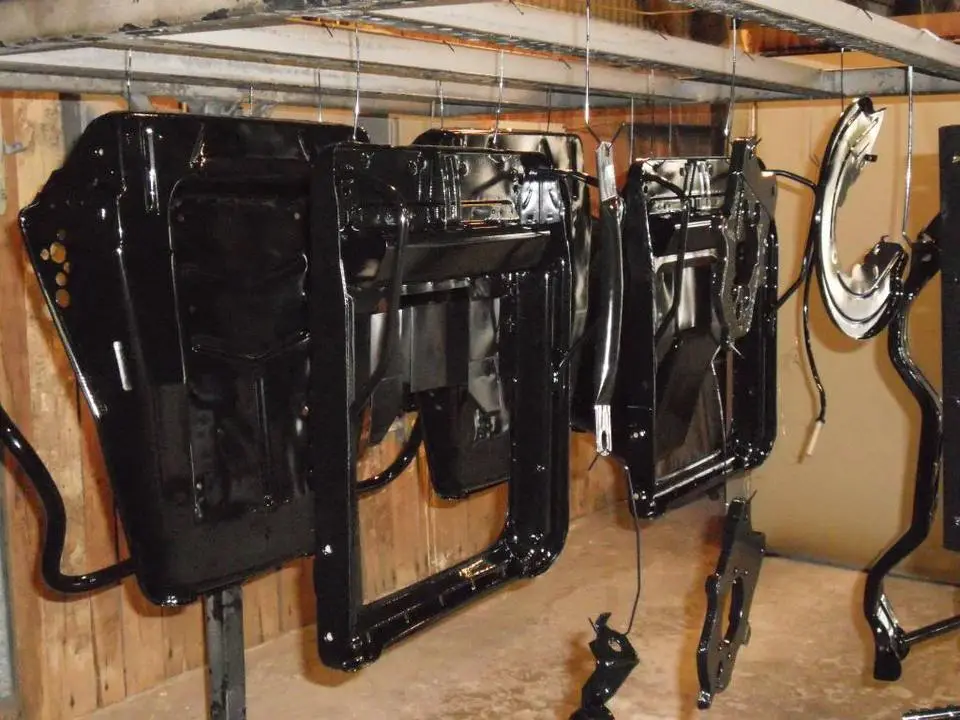

No more rust for these Recaro seats- now I can start on upholstery and putting these back together.
Got a bunch of misc. stuff done as well...Recaro halo frames, seat track adapters, rear brake parts, rear sway bar, rear bumper bar brackets, crossmember, oil pan dipstick.
Im going to weld up the axle tubes then Powder coat the rear end.
Not sure if I want to do wrinkle black to blend into the rest of the undercarriage or gloss black to set it off and match to the oil pan ,crossmember and brakes?

I vote gloss black, but then again, I think your control arms and axle should match...

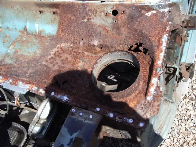

Wheels for my project car will be here Thursday.

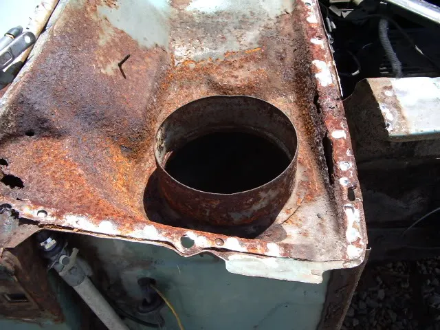

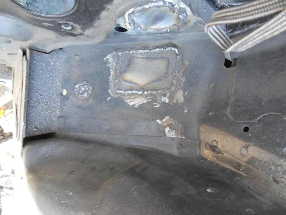

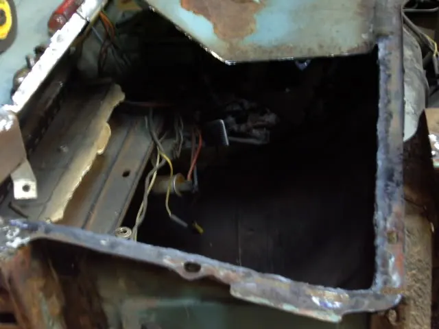

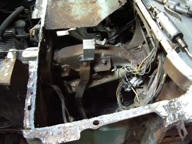

Waist deep in an old rusty Mustang...
Cowl panel looked rust free on the surface but he said it leaked inside...drilled out the spot welds to uncover this...

95steedamustang said:
Thanks!
have fun with that! I just finished up a cowl repair like that on my 67.

1987LXragtop said:
I dont miss doing rust repair. Love the powdered coating bits. Such a great thread.
Thanks man! Only way to deal with it is just cut it out.

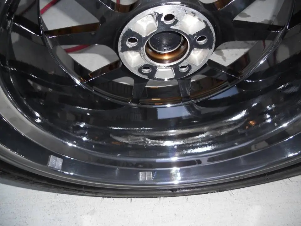

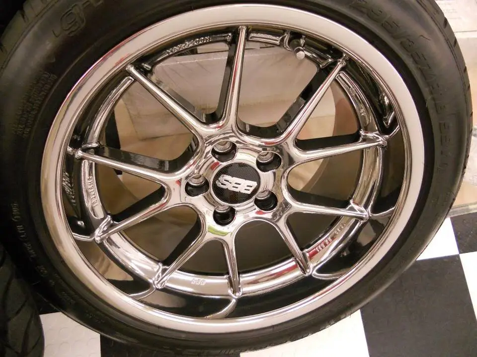

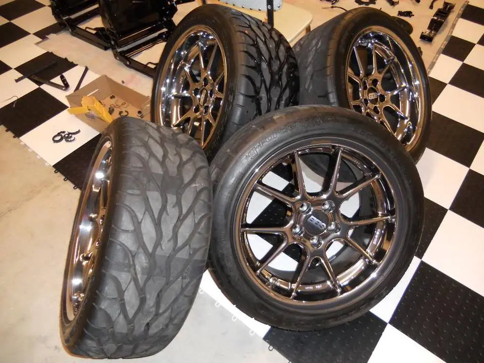

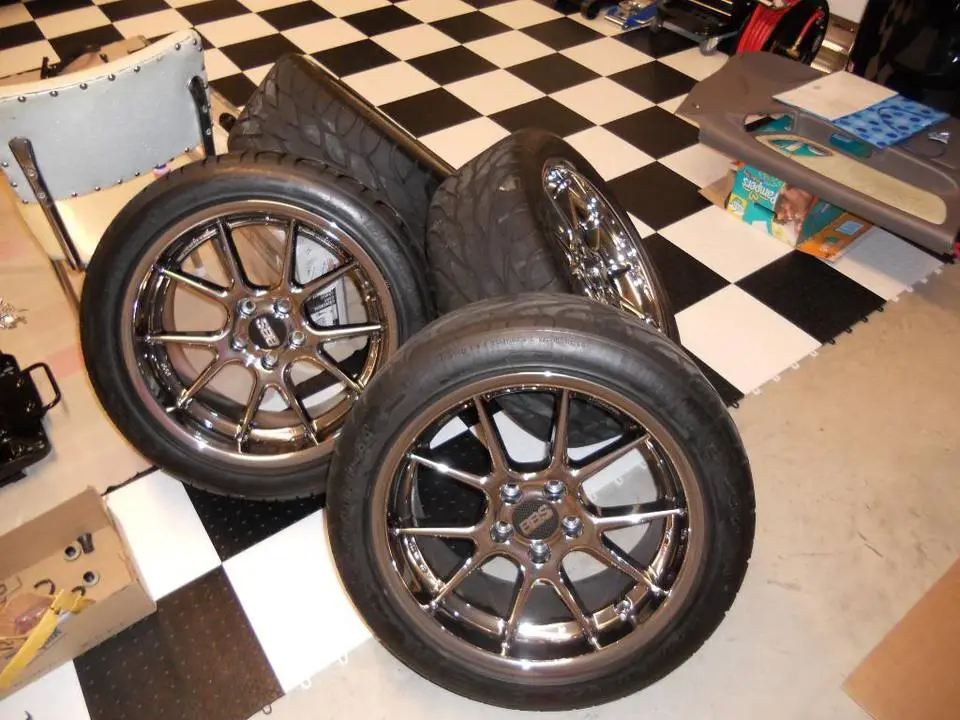

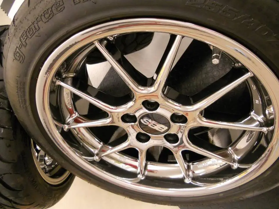

If I could have my pick of any wheel/tire set up for this 94, I would pick these. I have wanted a set of these for years. They were discontinued in 2006 and according to the previous owner, he bought the last staggered set sold in the US in 2007. They are mint with only a few hundred miles of show car use.
BBS RK plasmas 18 x 10 rear and 18 x 8.5 front with BFG KDW Tires.
These weigh 48 lbs each so they will be perfect for my suspension setup.

They look like the FR 500's. I do believe they will look awesome when it's done

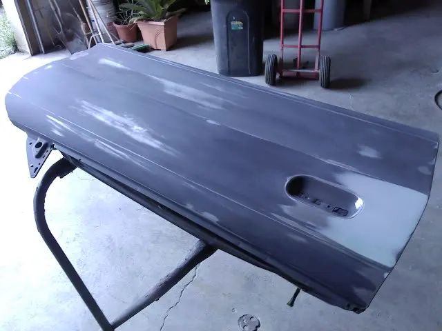

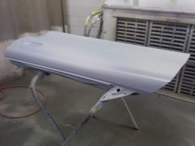

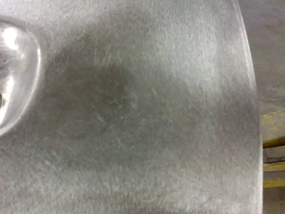

More progress on the 94
Passenger door lock welded up
SPI Epoxy applied and filler work done

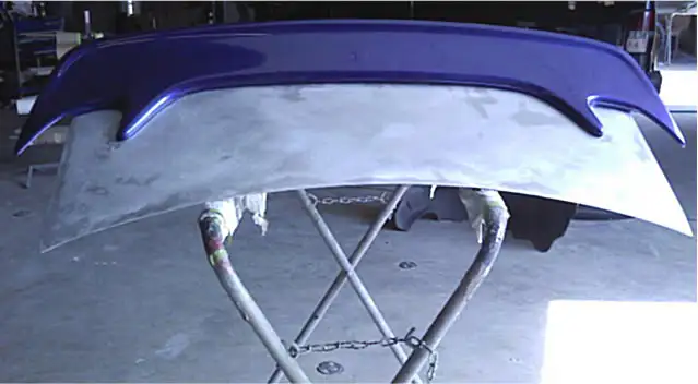

Cobra spoiler holes welded up
S-281 spoiler mocked up on the Cobra decklid
More epoxy primer for the passenger door and a couple of coats for the decklid
Finally SPI 2K primer for the driver door

I didnt realize they made those wheels in a staggered version. Very nice find, I like them a lot as well.

Thanks, I have been after a set of these wheels for years, Saw them on a Mach1 that was for sale in California and was able to make a deal for the wheels/tires...and was able to sell the wheels that came on 94 to offset some of the cost.

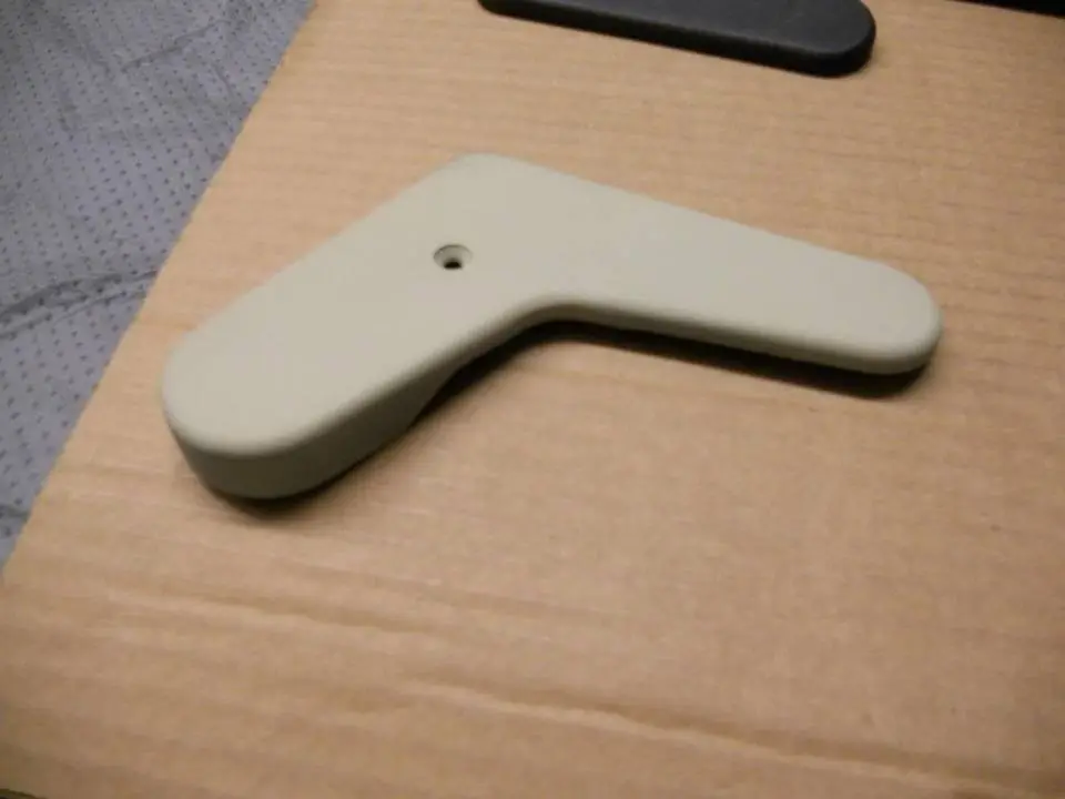

Got some more done on the 94...

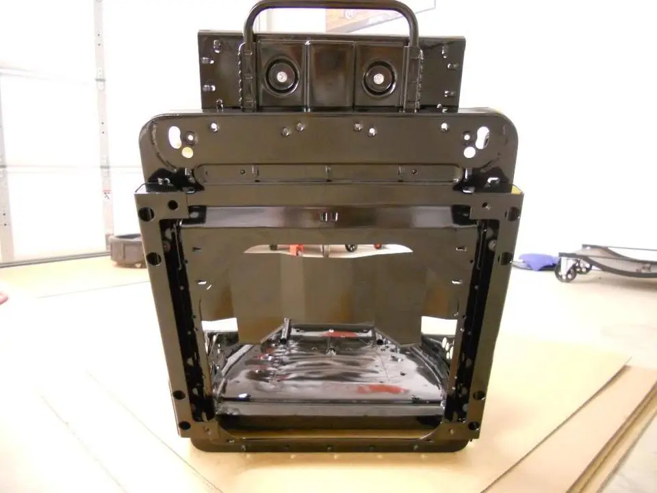

Got the recaro frames back together and replace the rusty hardware with stainless.

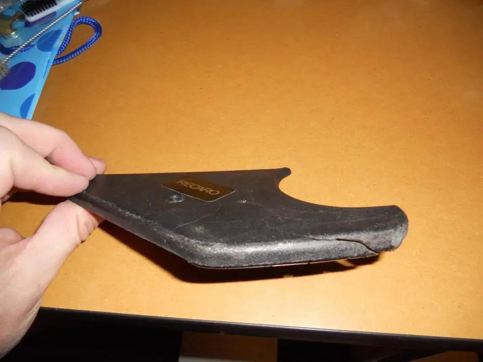

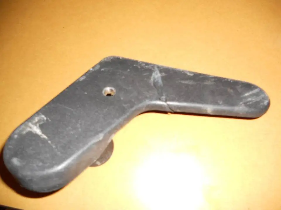

Started to fix the covers since they are hard to find in good shape.
After plastic welding, sanding, and some flexible primer for plastics.

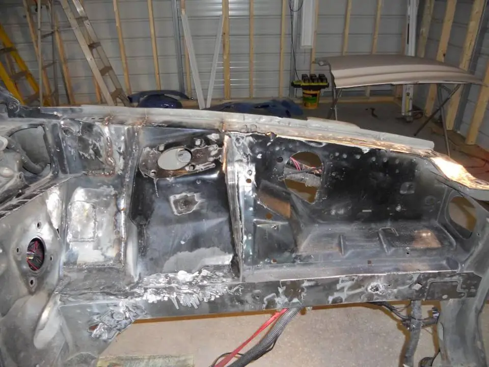

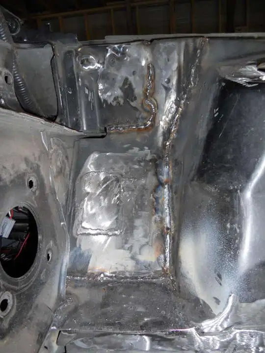

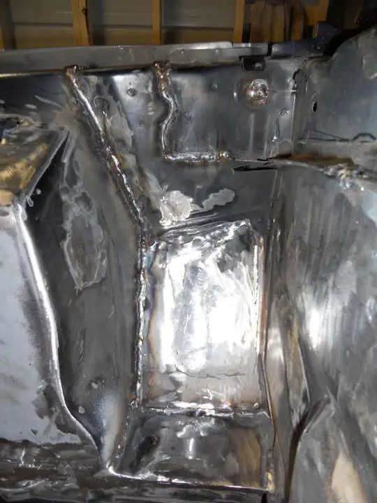

engine bay work
Going to start making panels for the frame rails and inner fenders today. I'll have a lot of hours in this part.

talk to me about plastic welding
please
please
Plastic welders and plastic welding kits.
I have the HD professional plastic welding kit.
You use it the same way you would fill cracks in fiberglass. V out the crack and apply the plastic weld and then sand off the excess. repeat if not completely filled. For added strength, you can sand the back side with 80 grit paper and epoxy.
This repair is most commonly used to repair cracks in motorcycle plastics. I'll post some pics of my repair on that if anyone is interested.

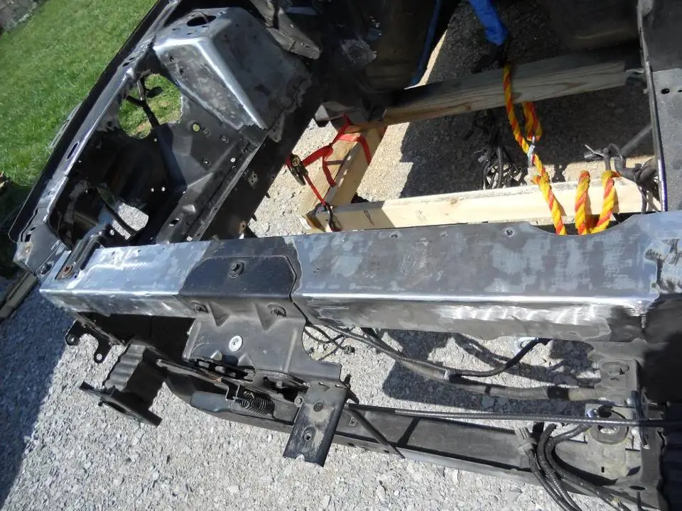

Haven't posted any progress in a few days. I took four days off last week to go to the Rod Run. Lots of nice cars up there.
Plus most of my progress on the 94 has been pretty boring.
Welding and grinding, welding grinding....
But here are the latest pics
