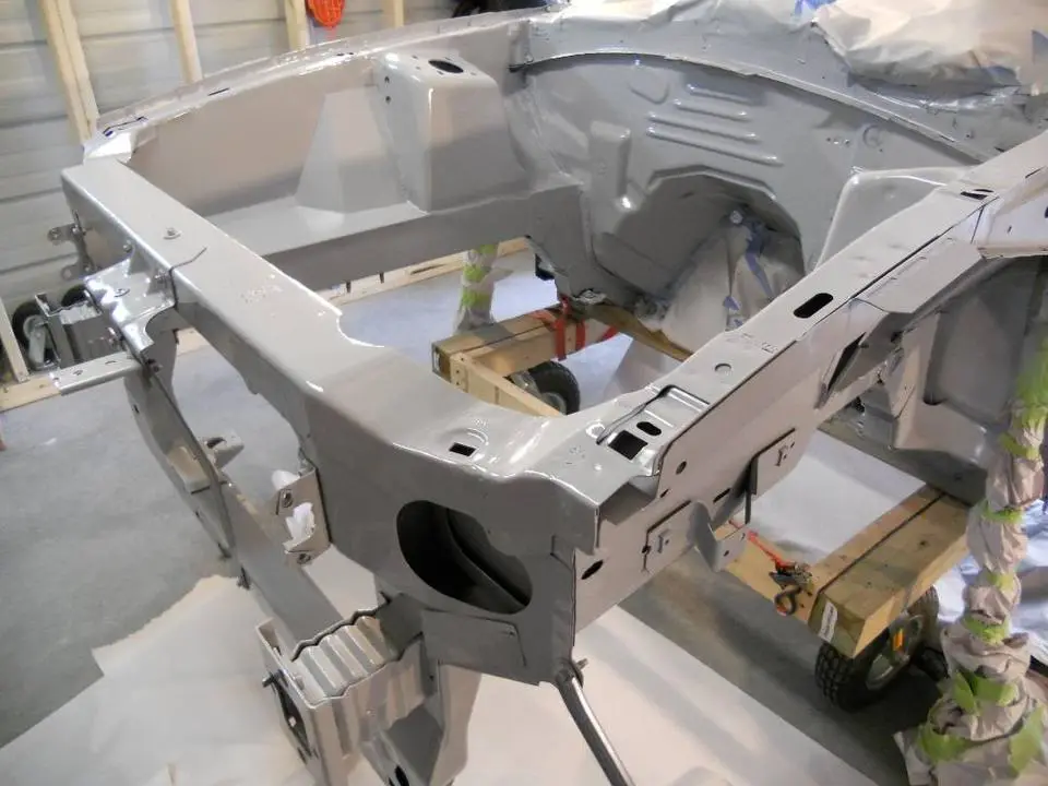

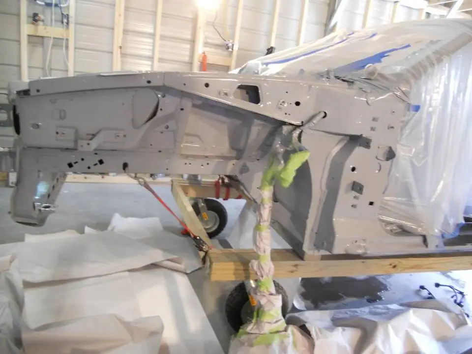

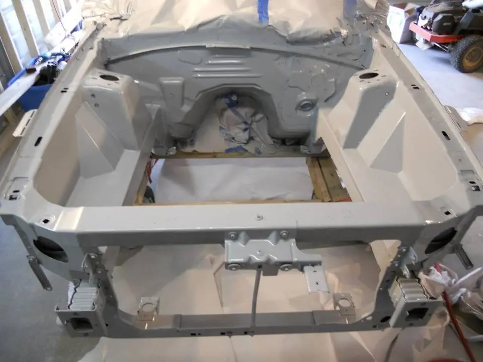

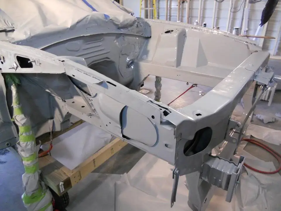

Finished welding and metal work.
Got the entire front clip striped and cleaned, 3 hours of taping.
SPI Epoxy primer to seal.
Next up will be body and filler work on the engine bay followed by more epoxy primer then 2 K primer.

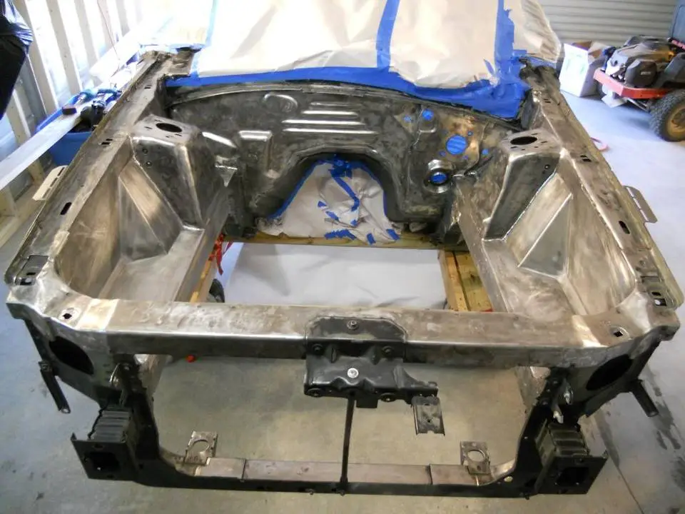

Do you use a media blaster to strip it down to the metal?

Engine bay was stripped by hand using wire brushes, roto discs, and 80 grit flap discs. Rest of the front I media blasted.

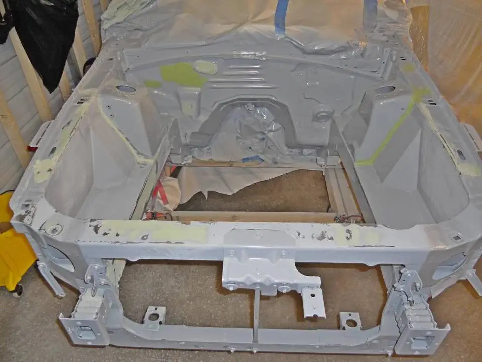

Started the filler work and sanding primer
