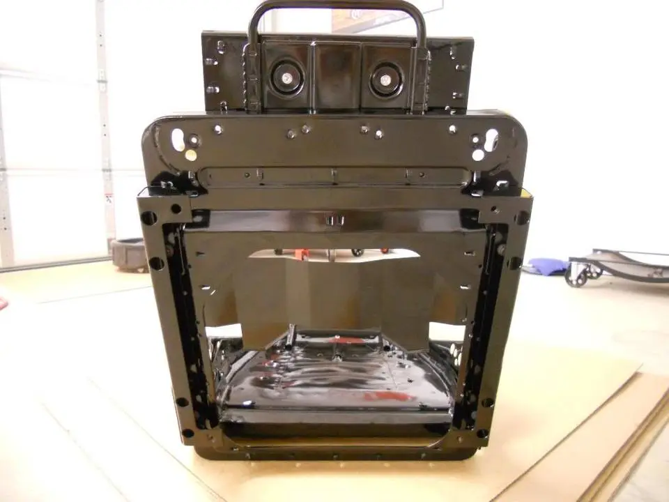

Kevin talk to me about those seat tracks.
Im tall. I want my seats pushed back a little. Maybe 2 three inches.
What is your process for moving the seat tracks back if you dont mine me asking sir.

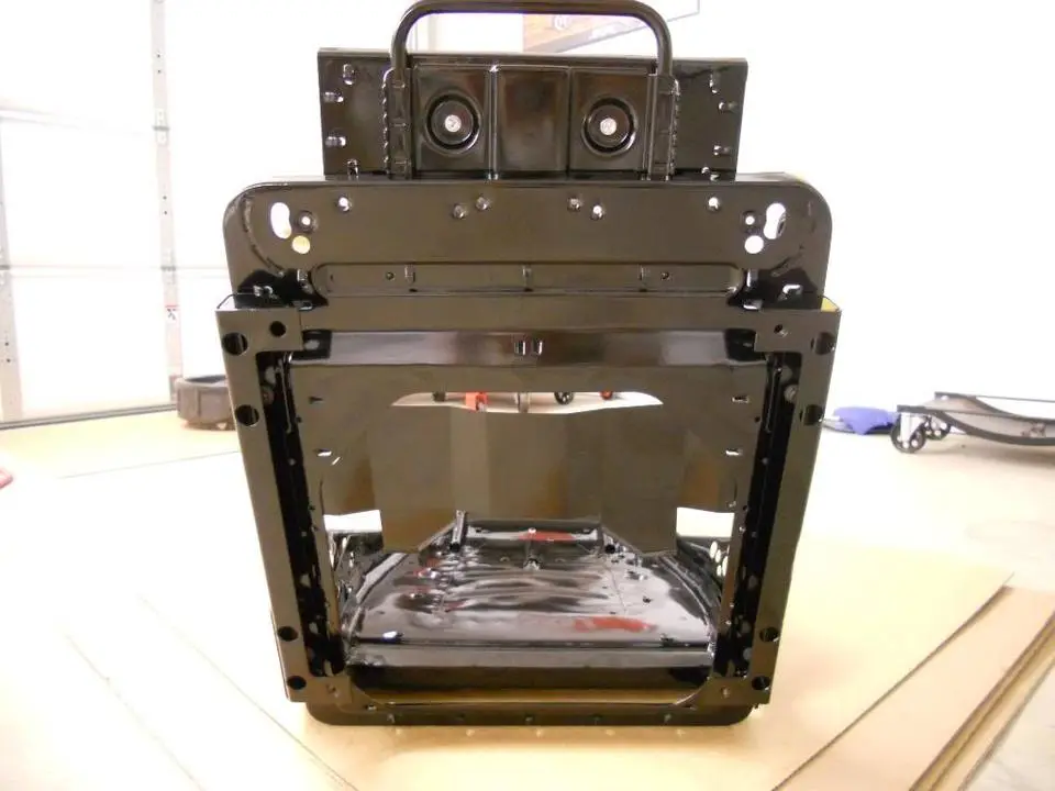

Thanks...I'm glad you've enjoyed my thread. This car will be much better than the previous. I will try to post some pics of my seat rails. You can buy seat track extenders from American Muscle but they also raise the seat which I don't like. The easiest way to do it if you dont have a welder is to take the tracks loose from the seat and redrill them thus moving the mounting points and seat back 2 inches. The only down side is you loose 2" of forward room.
I am using 79 pace car Recaro seats for this car and so I had to make adapters to go to the seat tracks because mine didn't come with them. So I just made the mounting points in them further back. I have not made my actual tracks yet but I have the measurements I need.

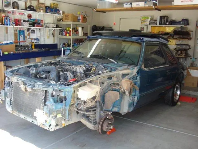

I have a 93' coupe on a body cart as a project - it's been hard to just really 'tear' into it / dismantle it - but after viewing this thread (your work) - I'm going to start this up-coming weekend - AZ vist 002 116.webp ......Just dive in.
Thanks for checking out my thread. Glad you enjoyed it. Good luck tearing into that coupe. I have built a lot of foxbody coupes, so if you need any help, pm me. The 64/65 coupe is done. I will try to dig up some pics.

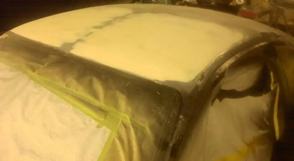

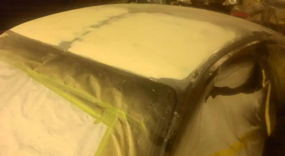

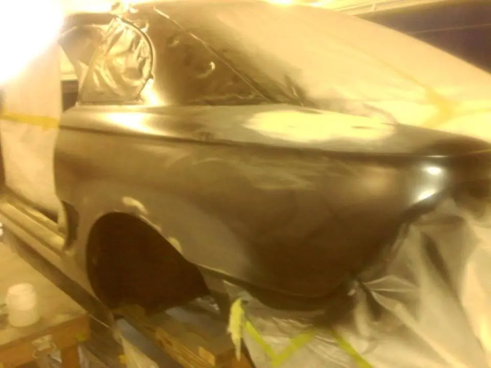

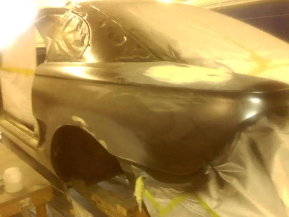

First update in a while. Bodywork continues...
