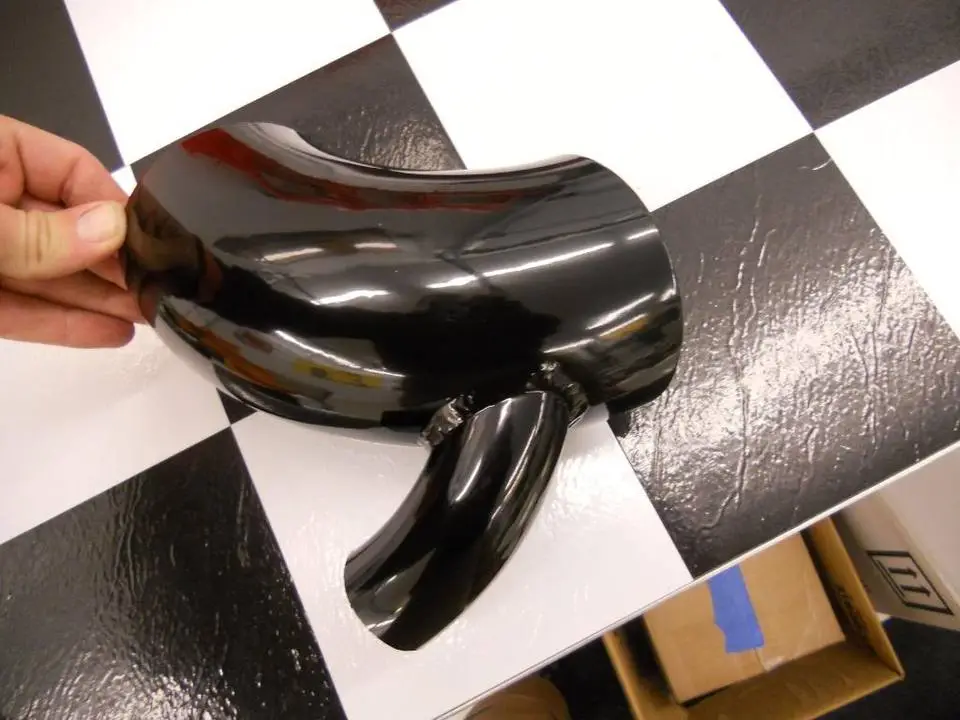

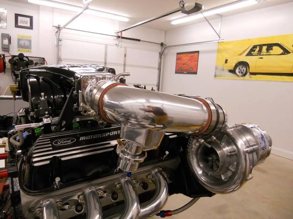

Coupler came in and was able to get the discharge mounted.

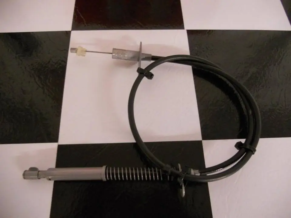

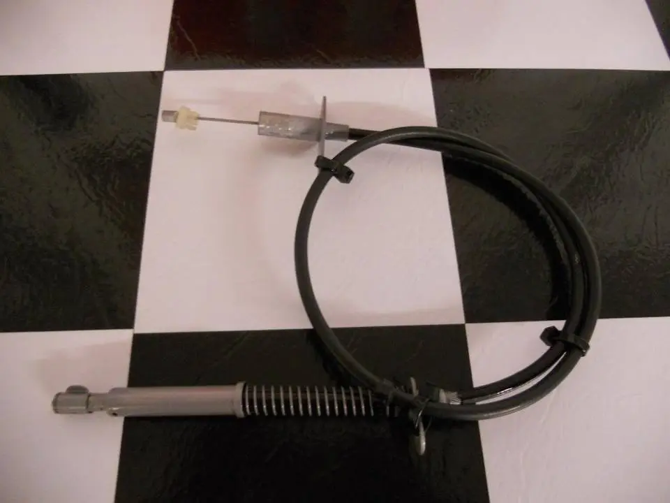

I found an oem fox throttle cable and got it detailed to match.

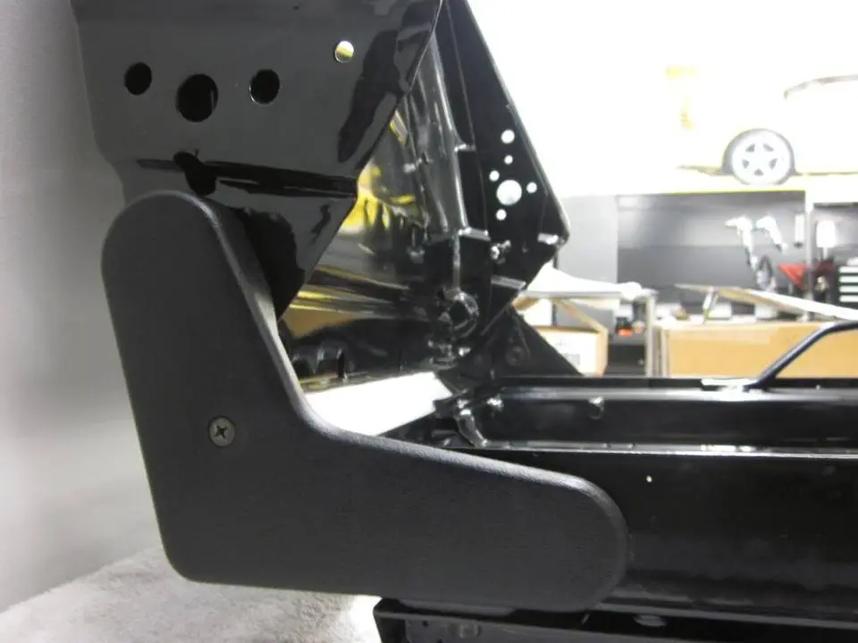

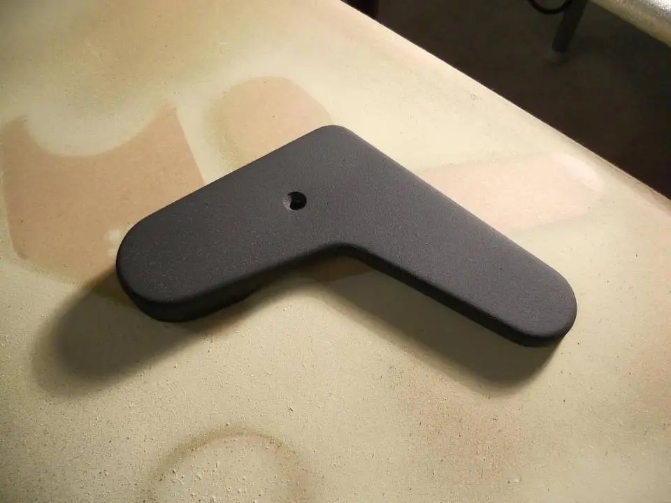

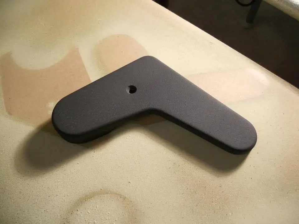

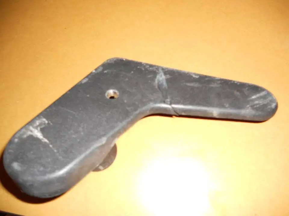

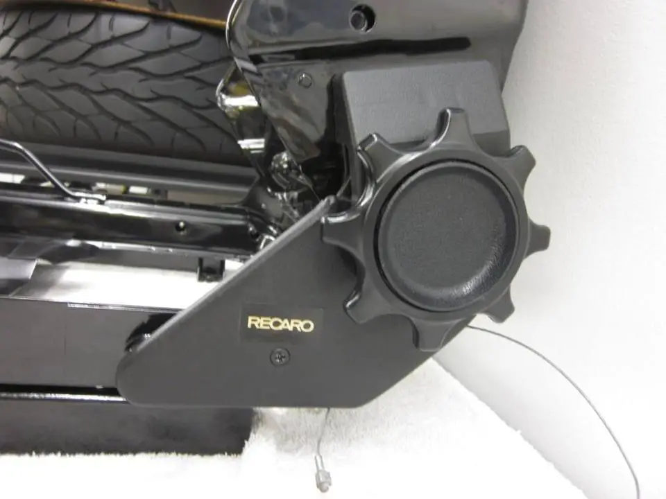

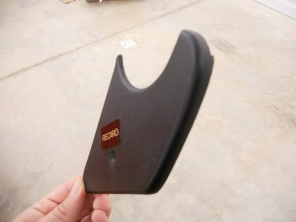

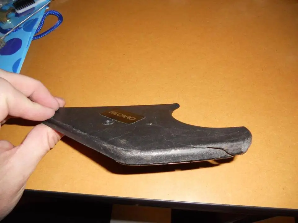

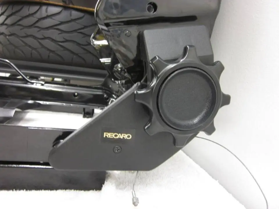

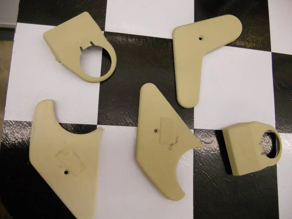

I finished restoring the Recaro seat plastics.

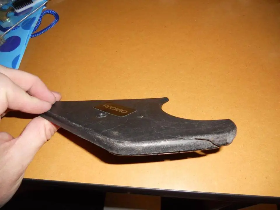

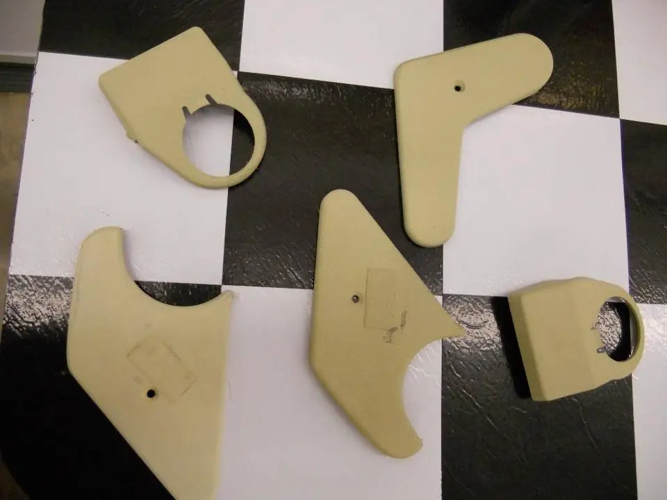

Here was my start.
After plastic welding, sanding, and some flexible primer for plastics.
I then sanded everything smooth to fill any remaining imperfections.

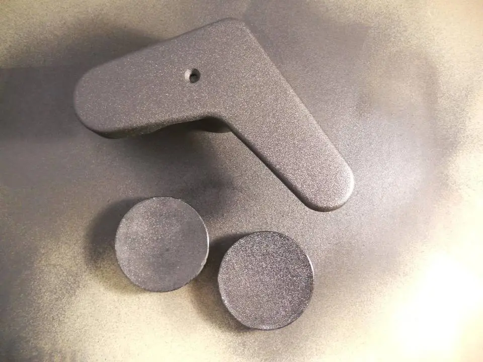

Then used a texture paint to recreate the grain in the pieces.

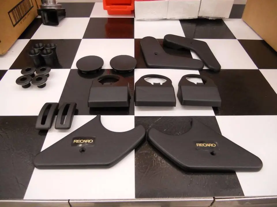

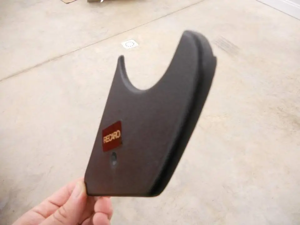

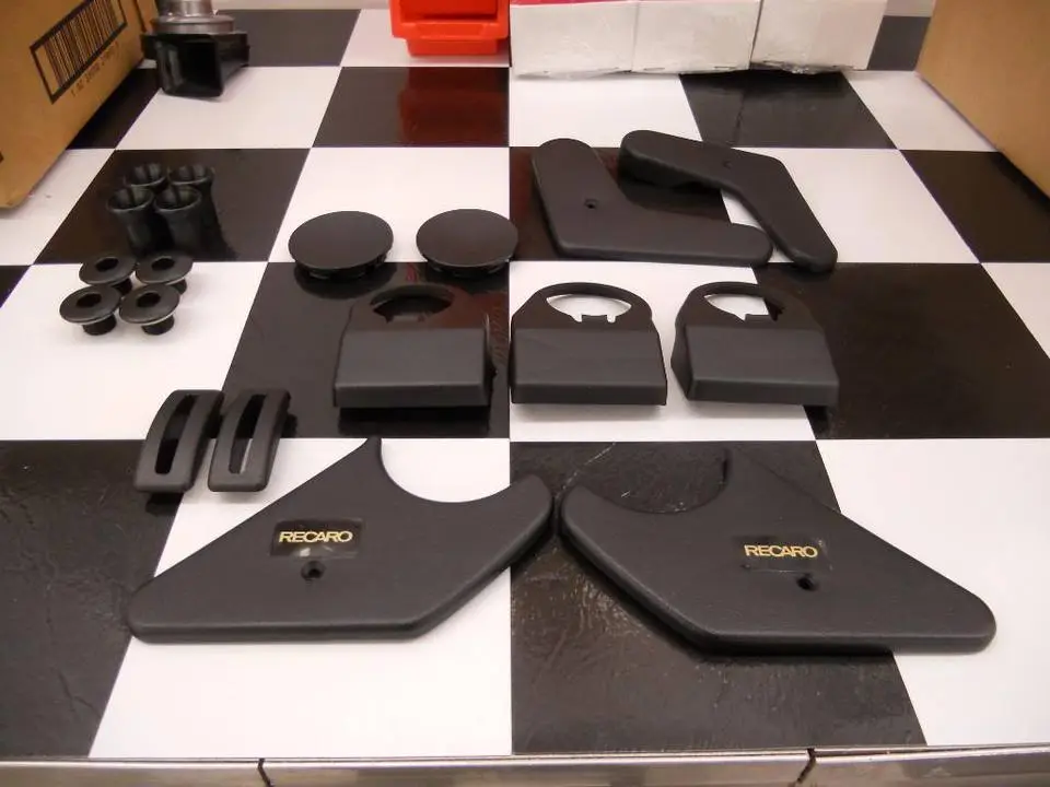

Then applied a factory match to my 94's black interior. The grain match is pretty good.
All the pieces done. I was really happy that I was able to keep the factory Recaro stickers through all the welding, sanding and primer.
This was a time consuming process, but worth it in the end.

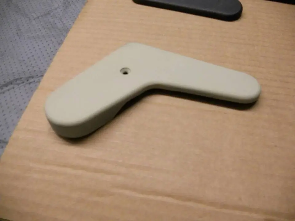

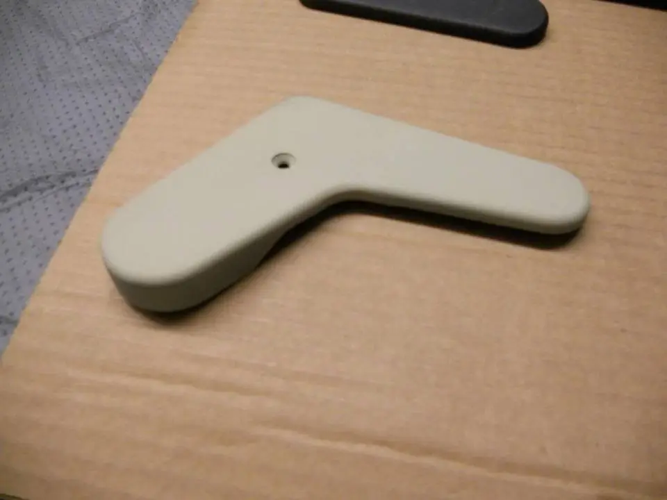

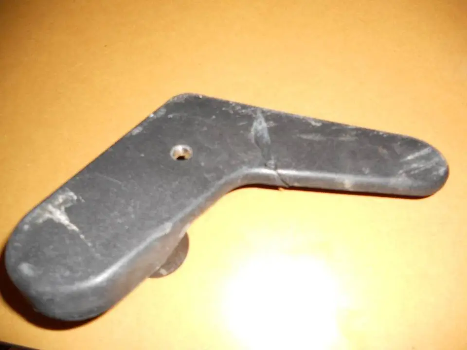

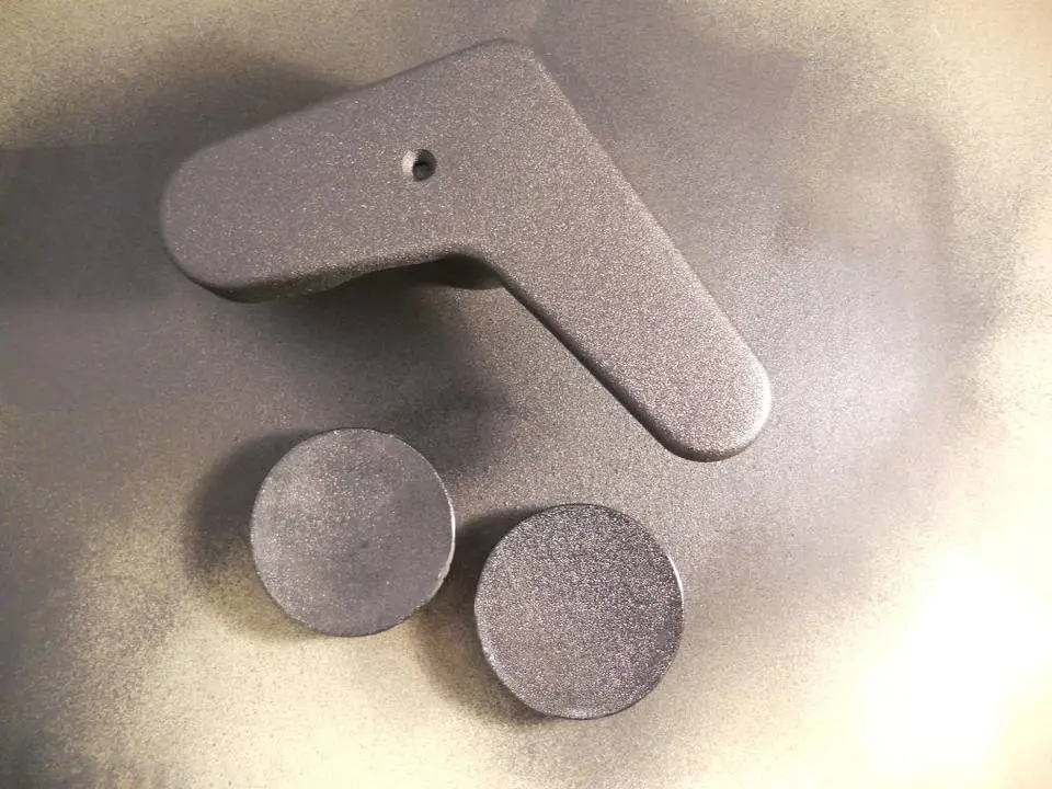

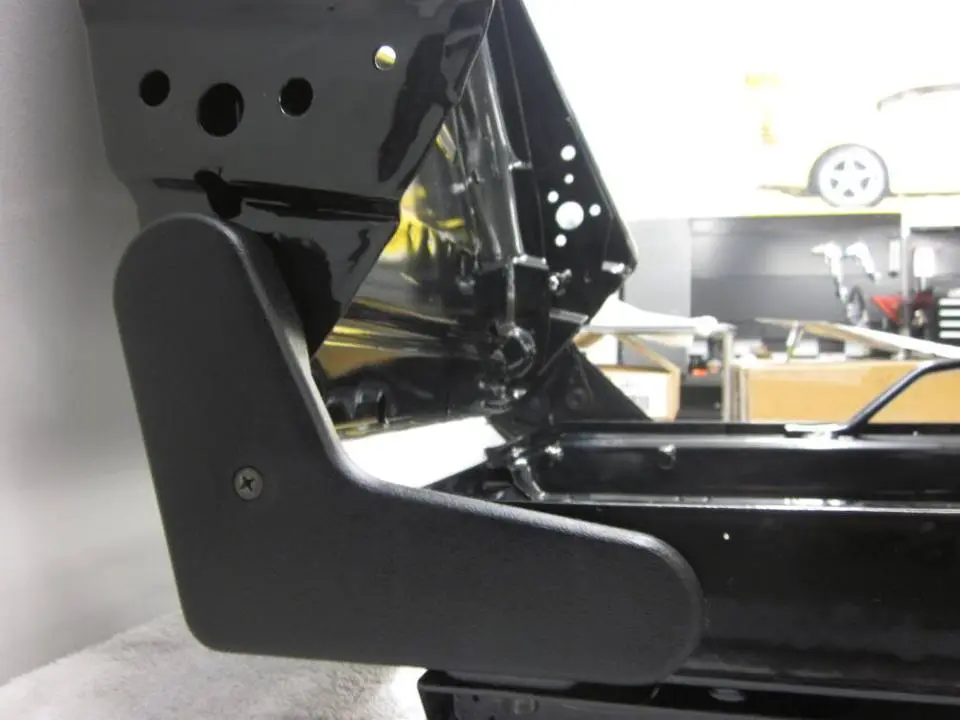

My 8 month hunt for recline knobs for these seats had finally ended. Which is what actually inspired me to finish the rest of the covers this week. The only foam that I need to replace is the lower bolsters. I have decided to try to make the new jackets myself. I 'm probably going to go with black leather on the outside portion of the seat and suede on the center section. I'm going to use the old covers as a pattern. I have covered dozens of seats over the years but never tried to make my own. It may be a disaster...we will see?

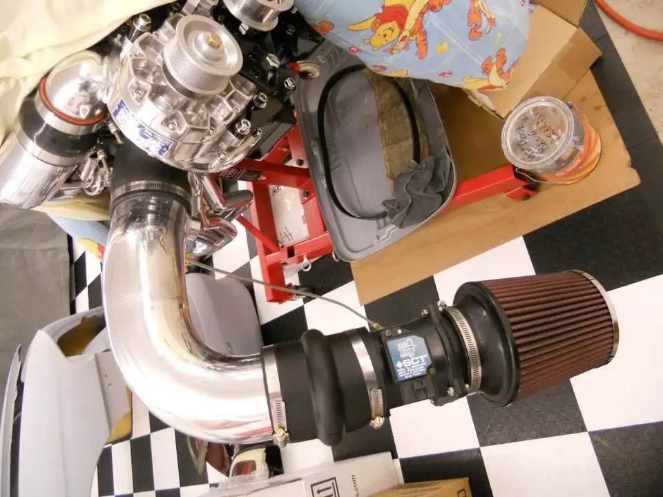

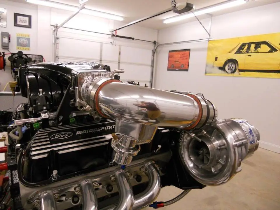

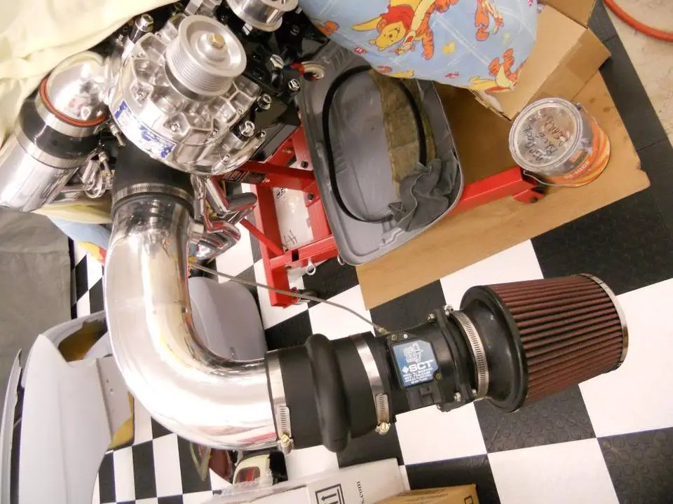

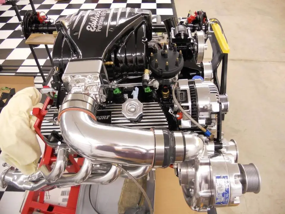

I decided to sell my 42 lb injectors and 90mm meter in exchange for some 60 lb injectors and an sct meter. I also got a power pipe so I can check one more thing off the list.

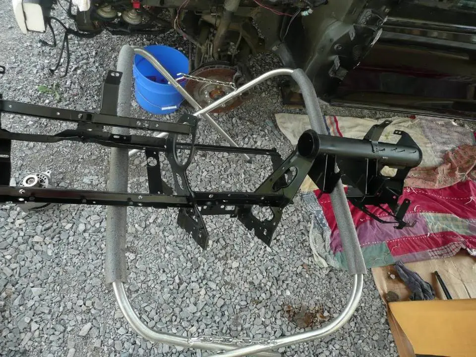

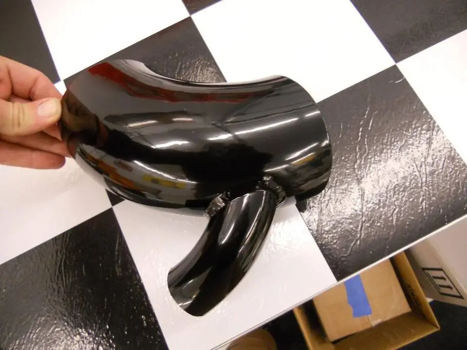

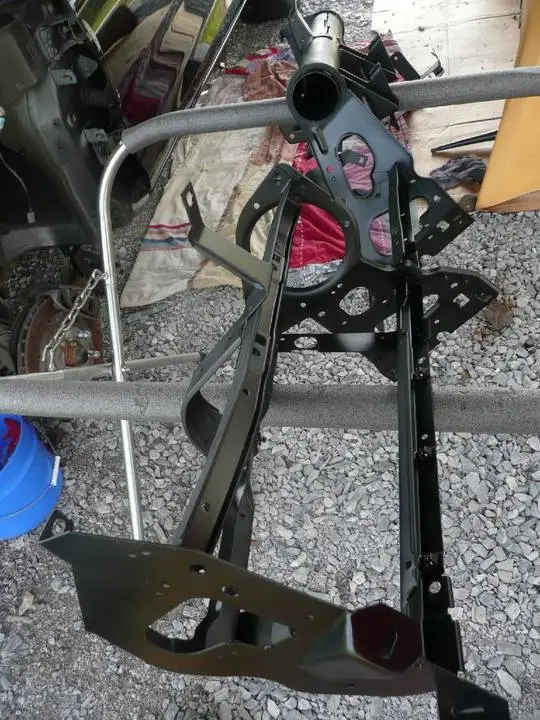

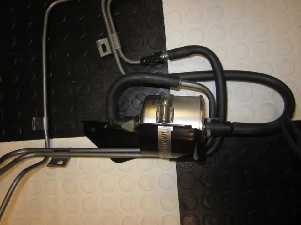

I am not using the rubber 90 that came with the power pipe so I replaced it with the metal pipe and welded a 2" tube to connect to my mondo bypass and then powdercoated it black to blend it in.

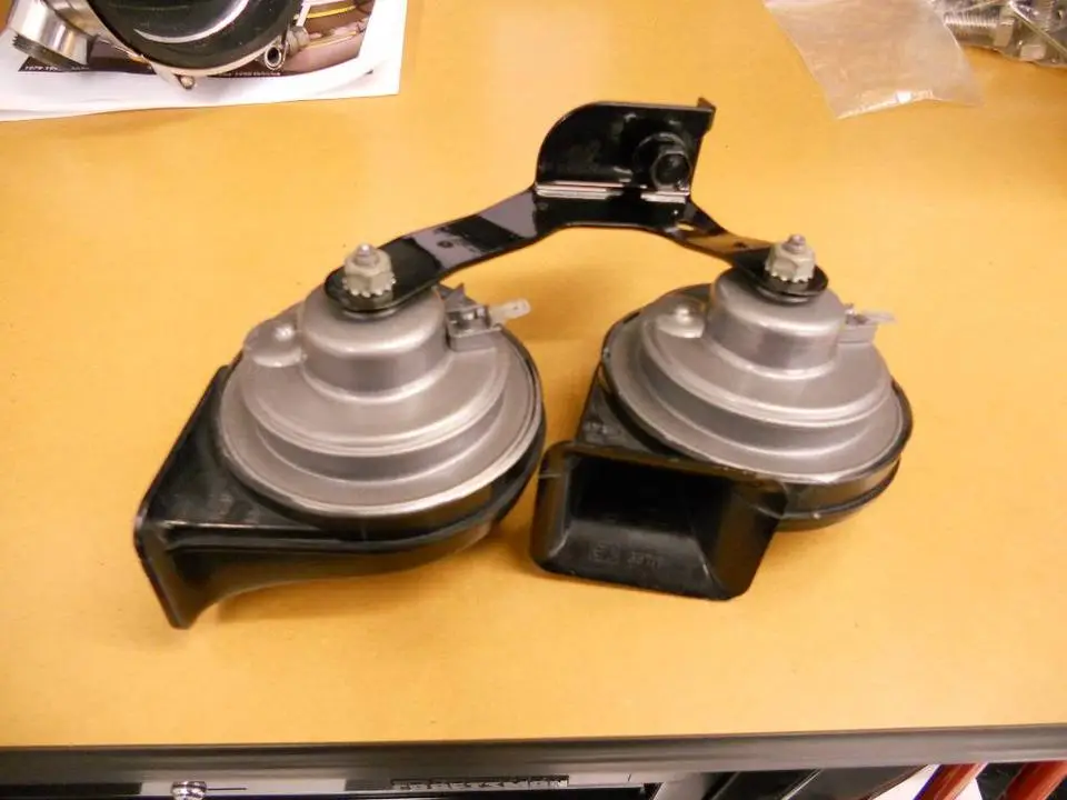

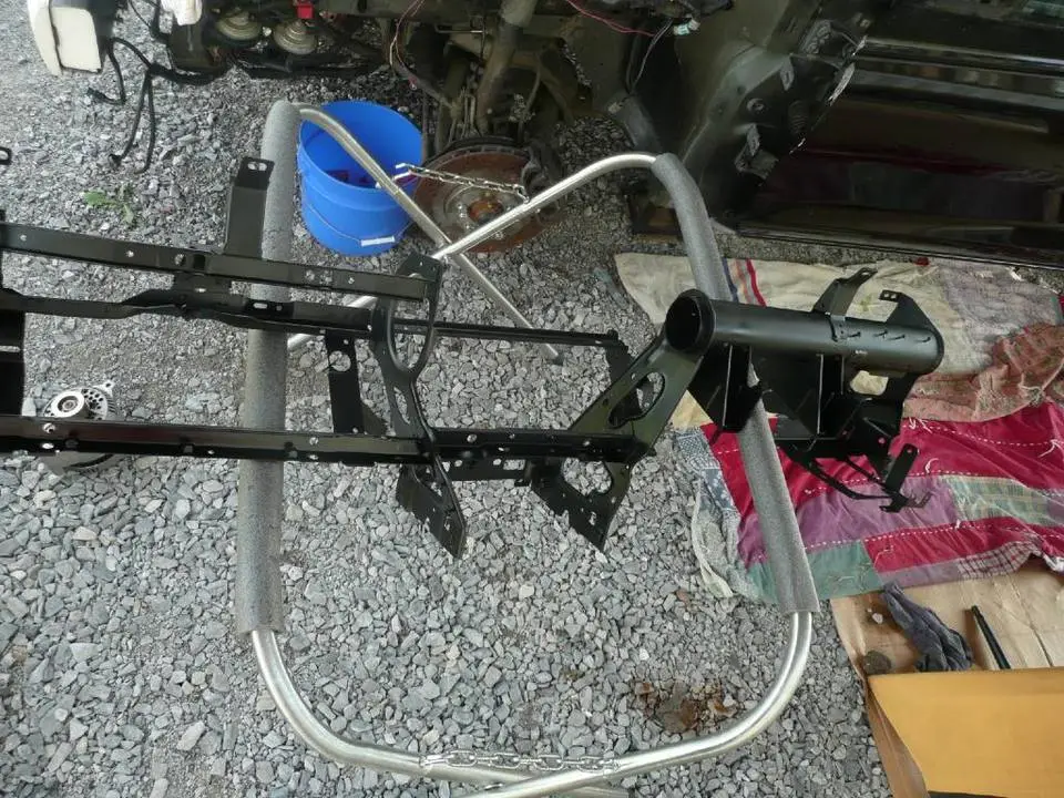

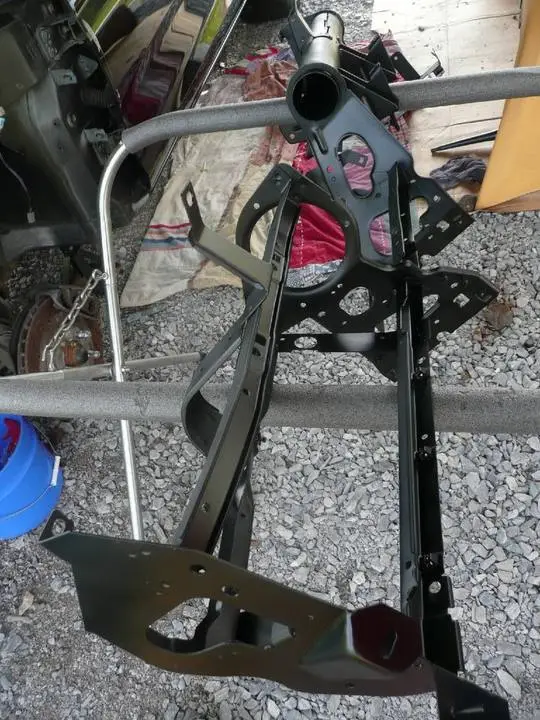

Also got a bunch of little things blasted and coated, ready to install.

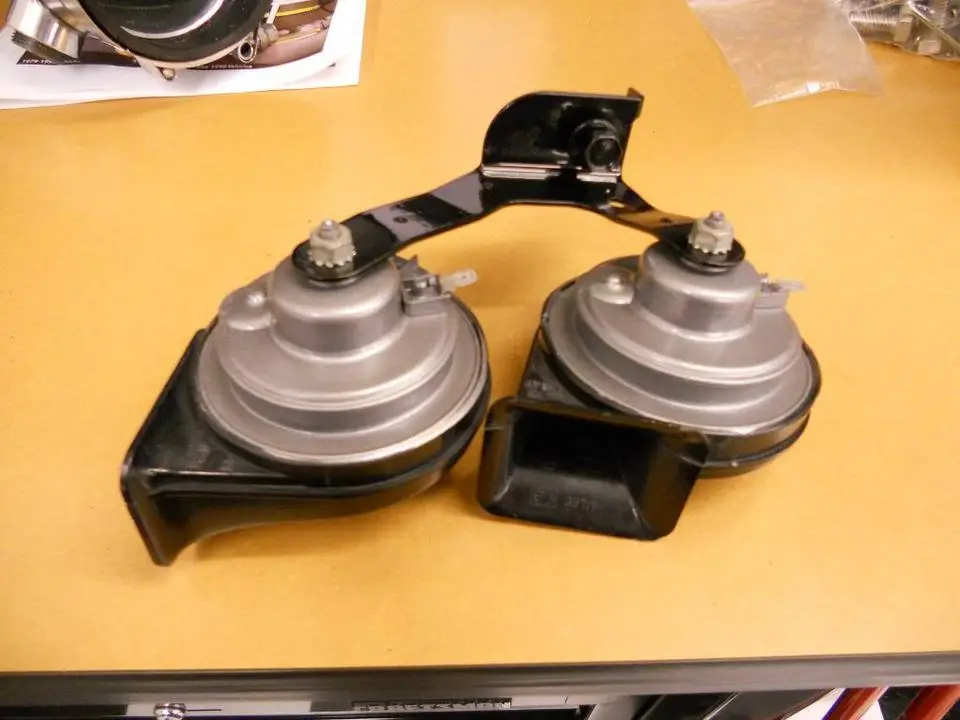

Horn

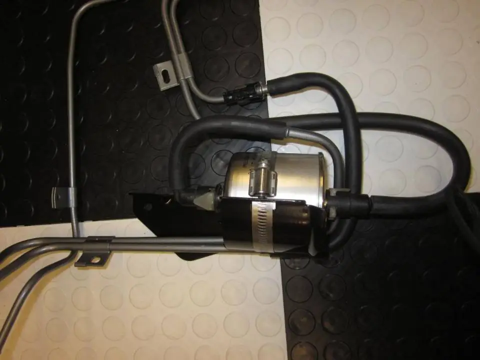

New motorcraft fuel filter anf powdercoated bracket to finish off the fuel lines.

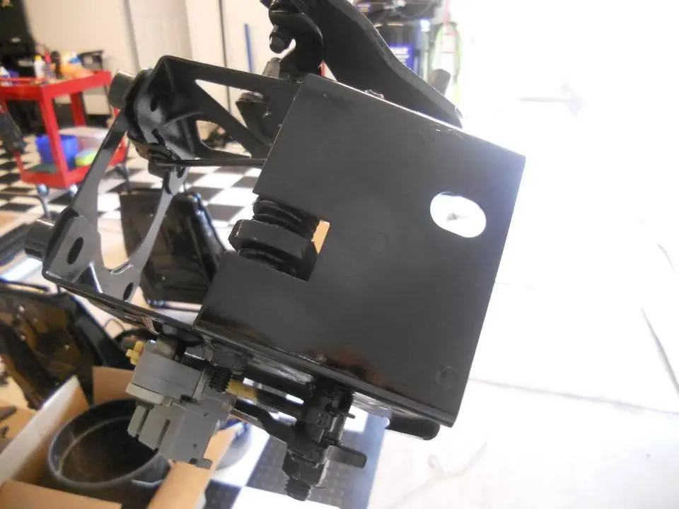

Pedals
