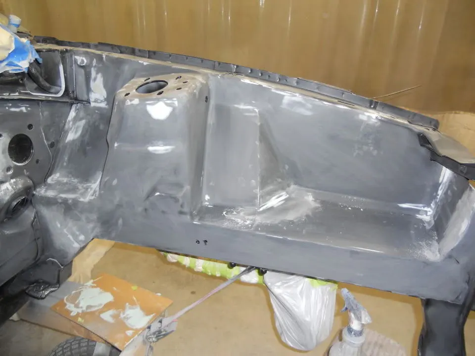

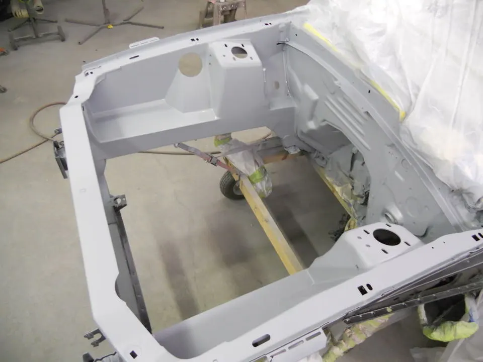

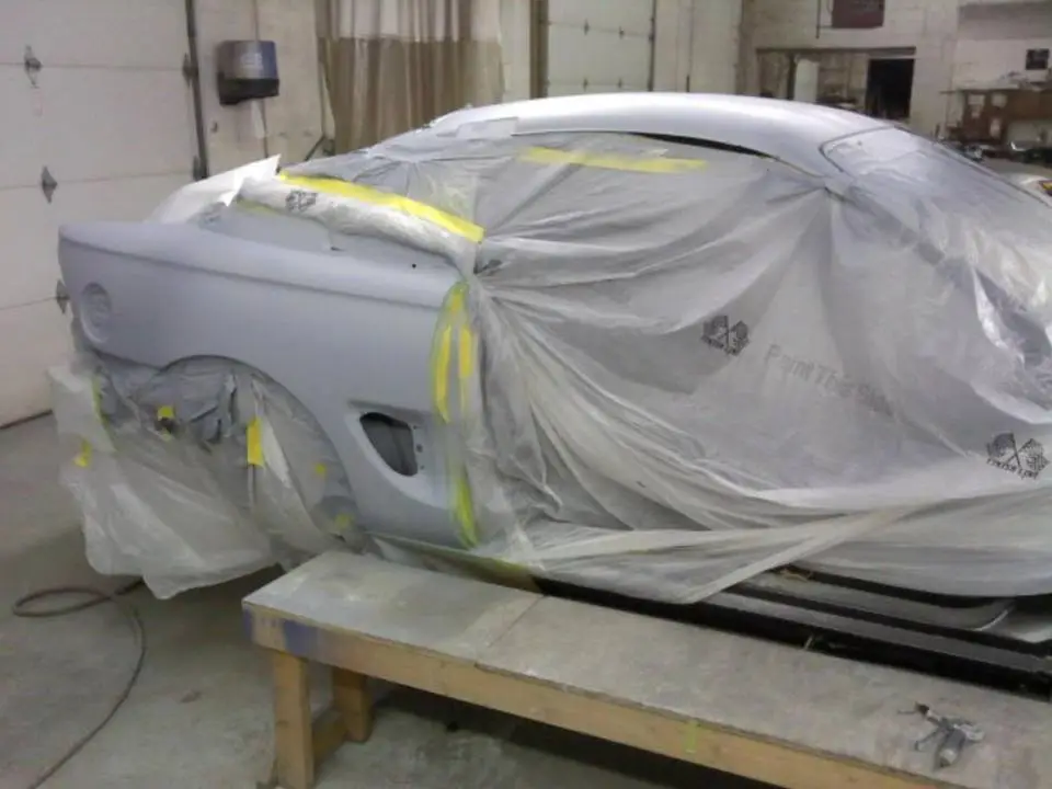

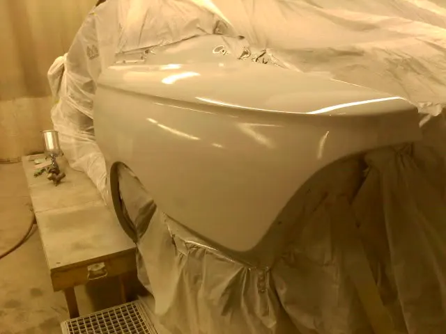

Latest update
Etching primer
And finally the whole car and all it's panels are in primer

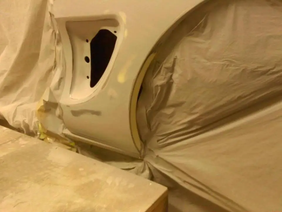

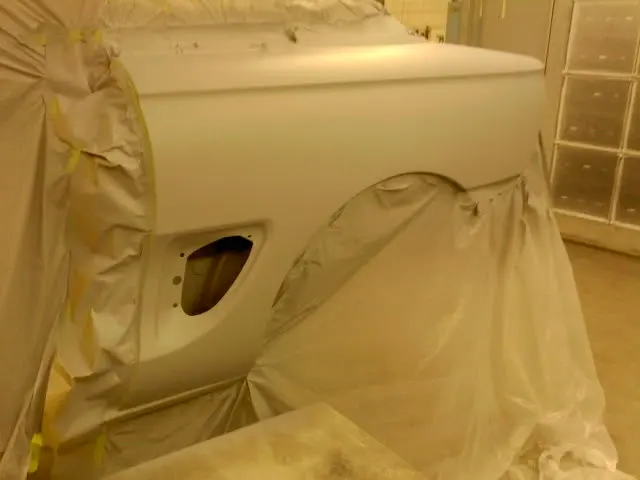

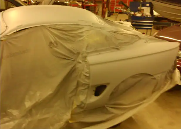

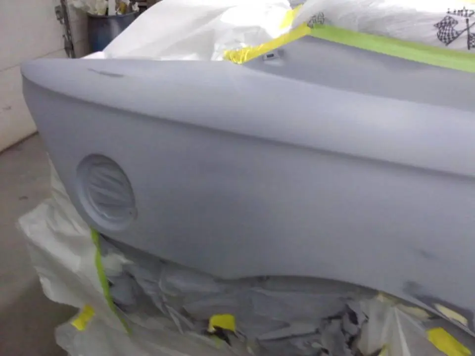

First primer block on the driver quarter done.

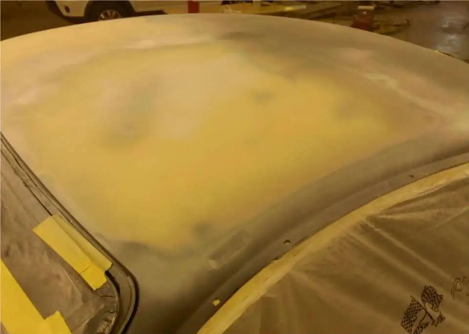

Latest progress is a 2nd block and prime of the roof and driver's quarter.
Smoothed out the spot welds on the rear quarter

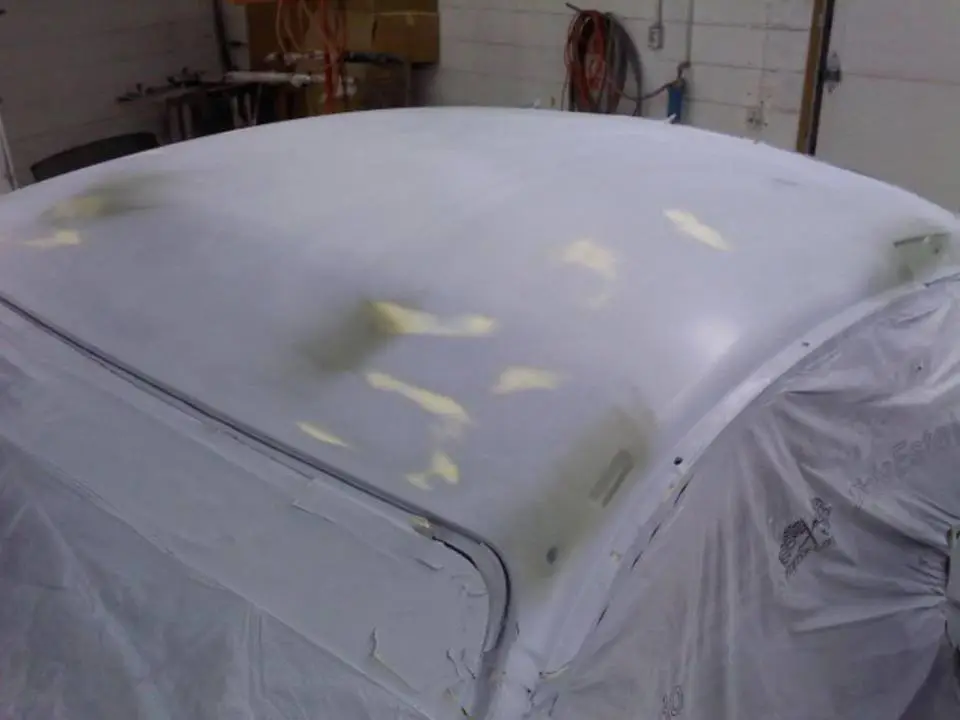

Got the roof and driver side blocked with 220 and then blocked the passenger side quarter. All three panels are now at the same point and all got more primer last night.

Yeah, although I'm not sure any good body man does the work for a living. I usually have way more hours in stuff than I charge for. But that's my own OCD kicking in.
The roof saw everything known to man. First a stud puller, then hammer and dolly, then heat to pull the stretched metal back in. Then a pick hammer to level the high spots from the stud puller.

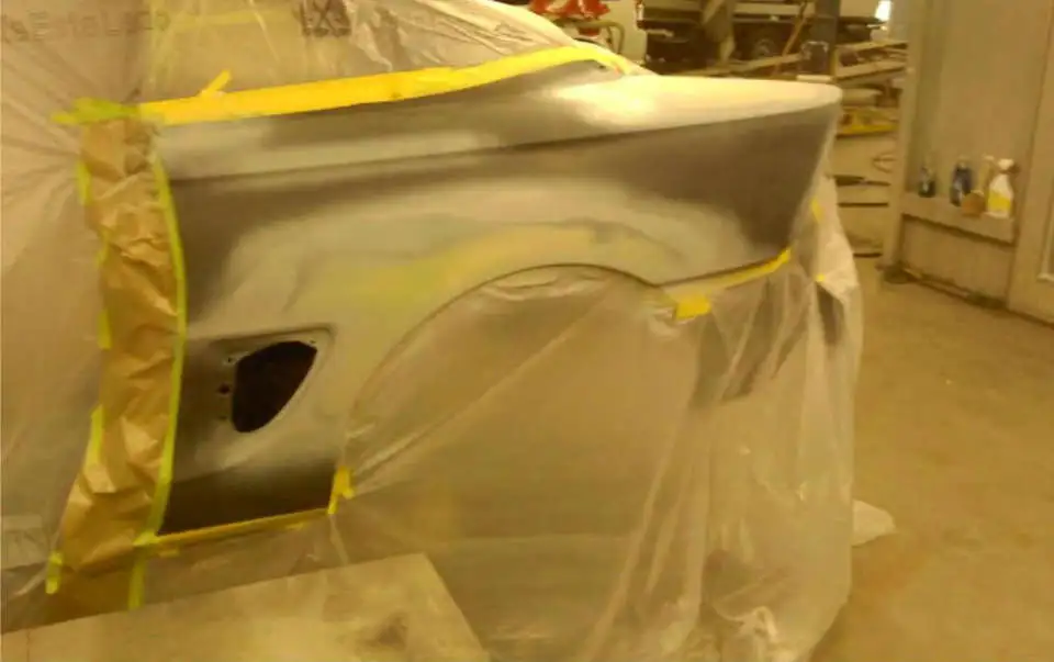

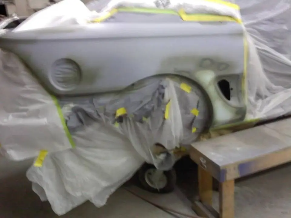

Worked the passenger side quarter over again.
still not quiet there...
Getting closer though...

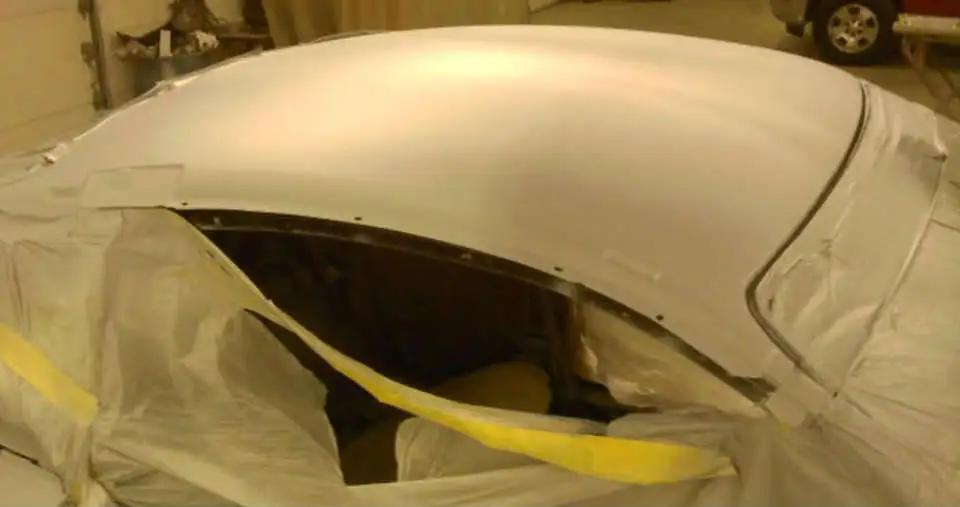

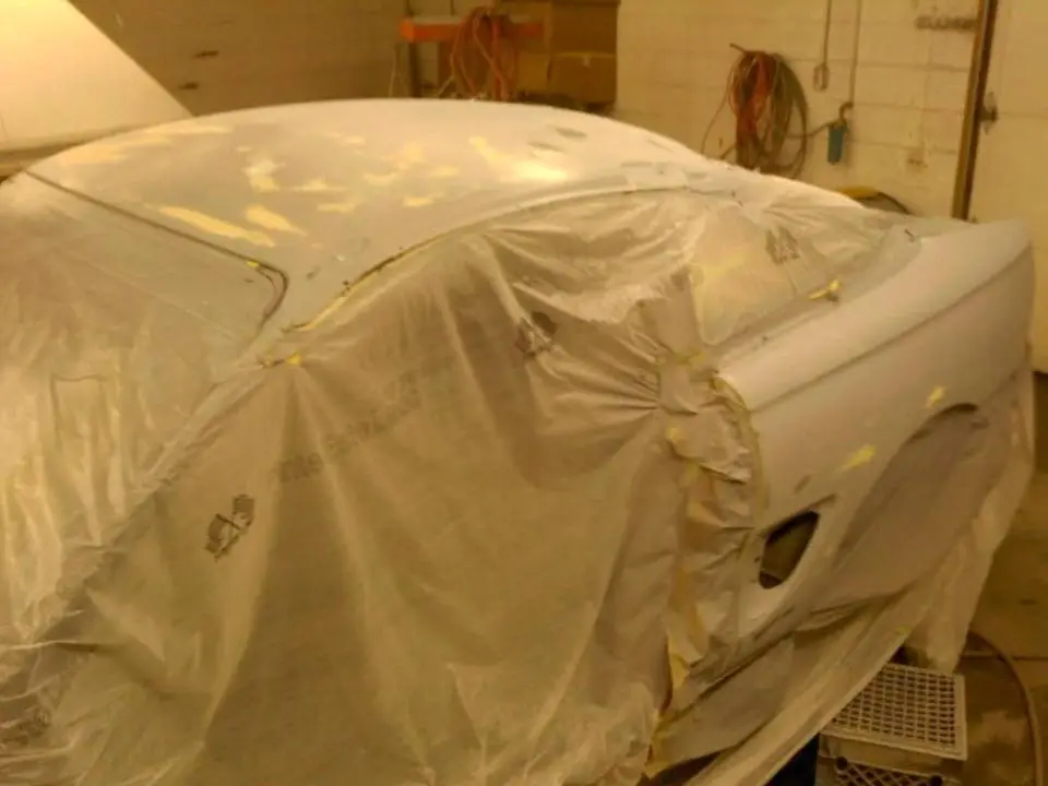

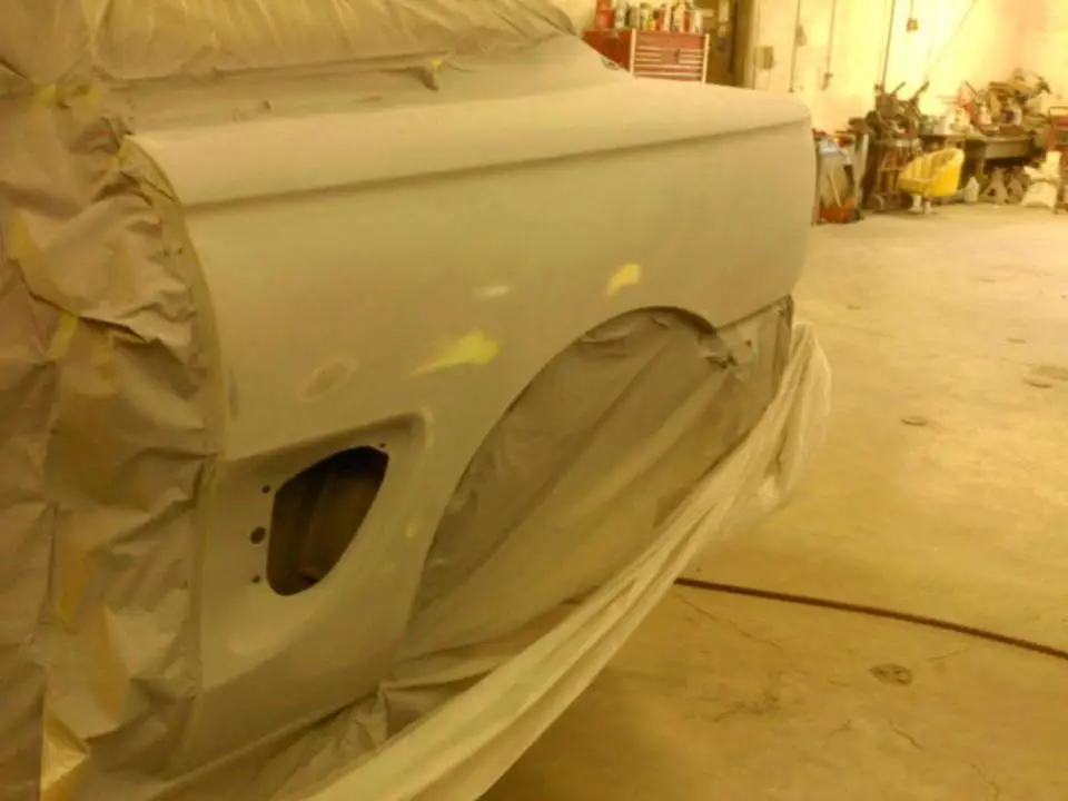

What was the worst part of the car is now done and ready for paint

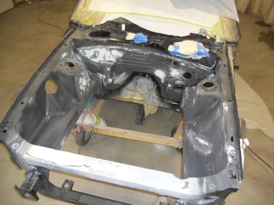

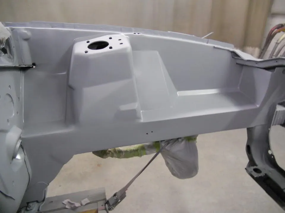

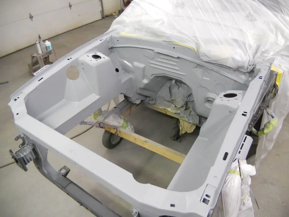

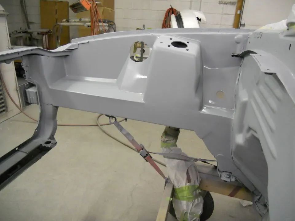

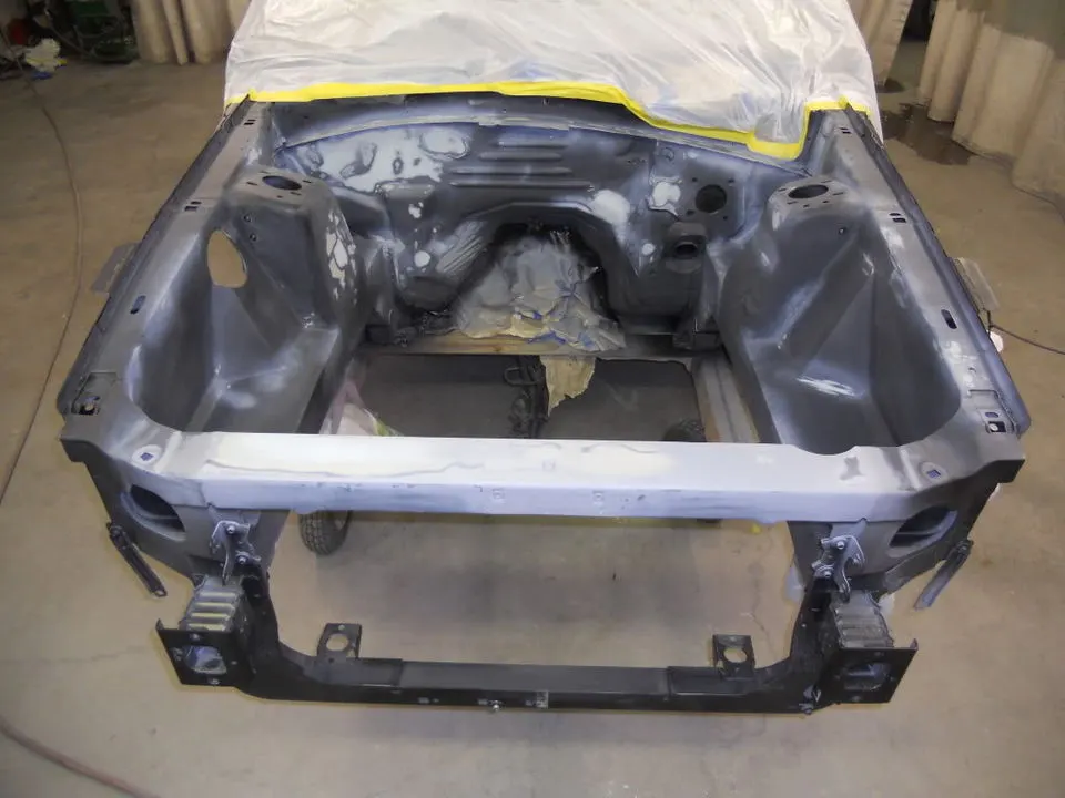

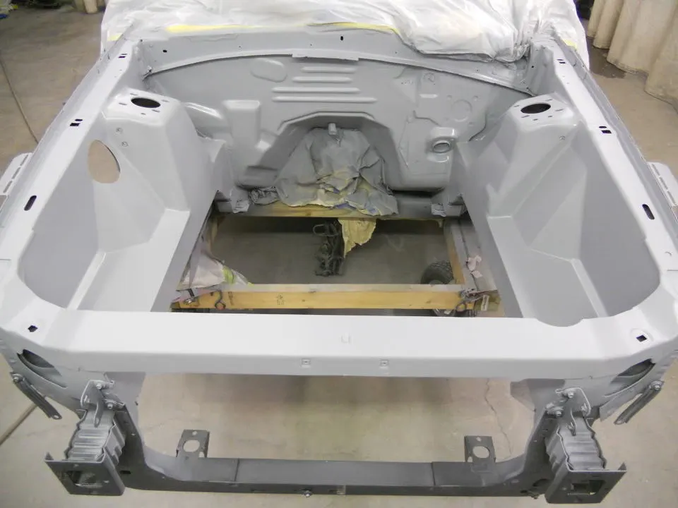

Another round of blocking, sanding and smoothing the engine bay.
And more primer
Except for some final small details, we can check another thing off as ready for paint.
Next up will be putting the doors and fenders back on and setting the gaps. Paint is coming...I promise
