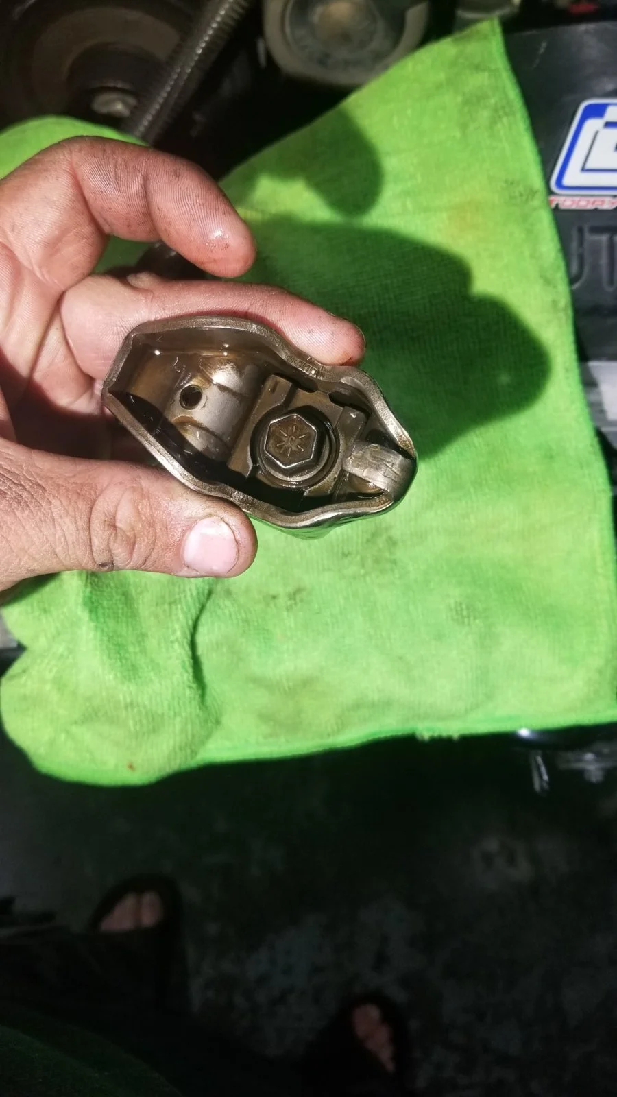

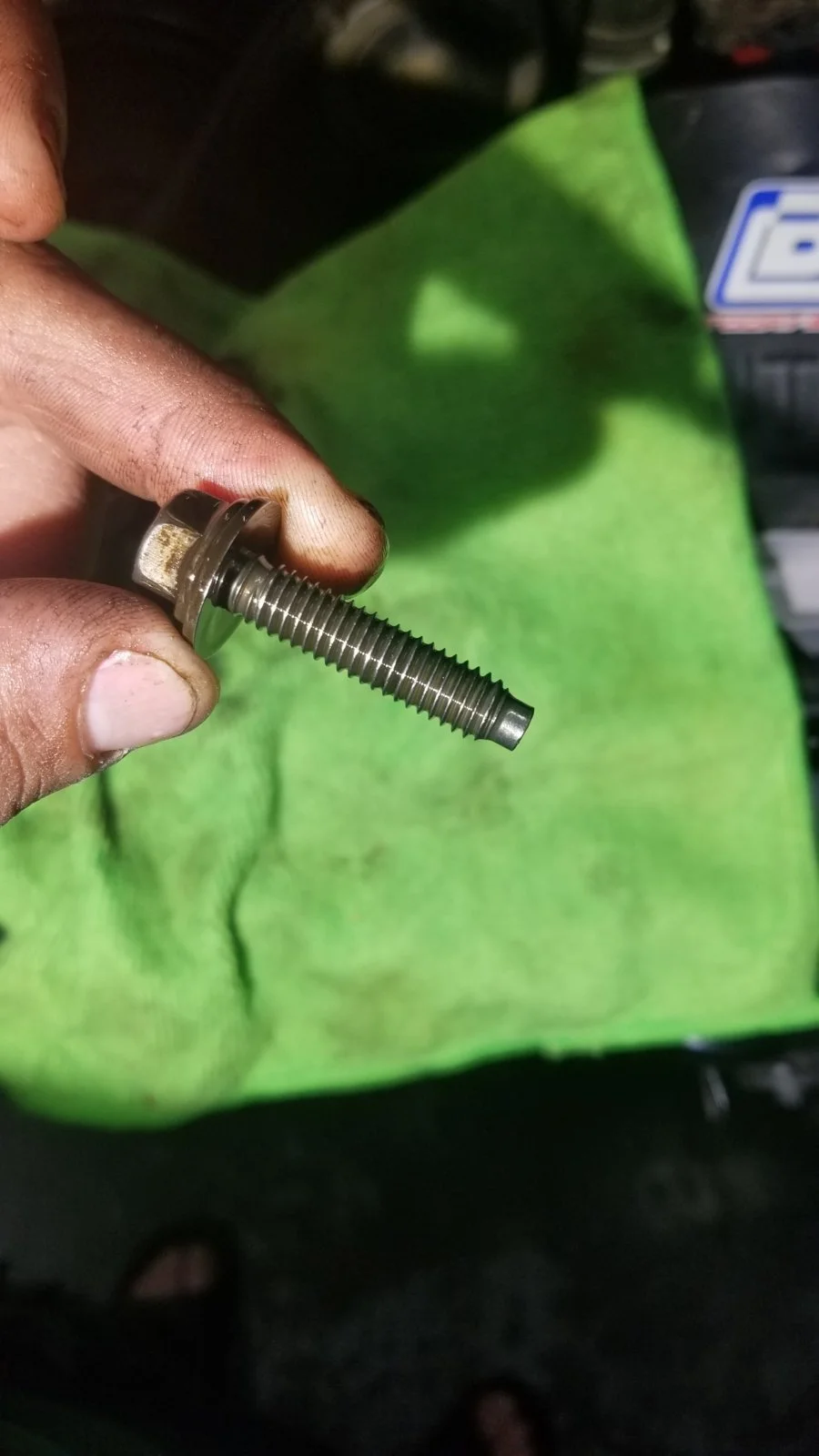

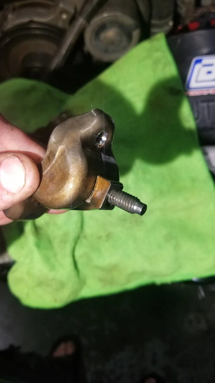

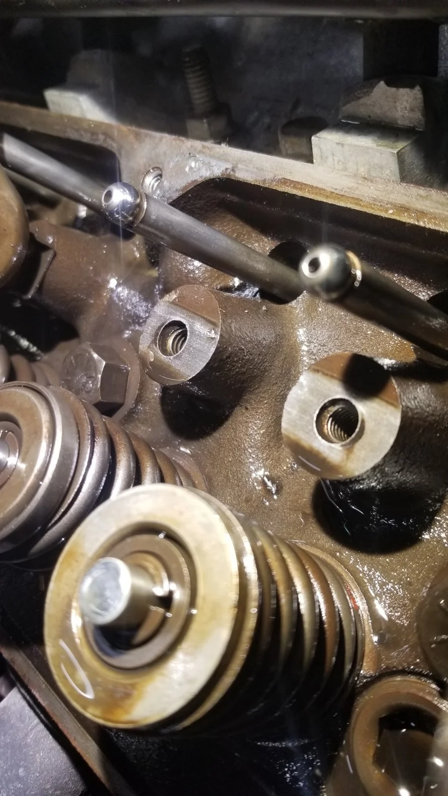

So I've just dropped a 91 f150 302 in my fox, and I keep having issues with the vavle train come loose. I pulled the push rods out and inspected when the motor was out and they went back in exactly how they came out. I've now adjusted them twice and have come loose both times after running for 5 mins. Stock motor nothing been changed.
What the hell am I doing wrong I'm getting annoyed please help
If putting back exactly as they were with no other changes, such as different push rods, lifters, cam, head gaskets, etc., then you should tighten each rocker arm while the cam is on the base circle, meaning valve fully closed. This will mean that the engine needs to be rotated several times to get each valve closed. They should be tightened to 20 ft lbs.

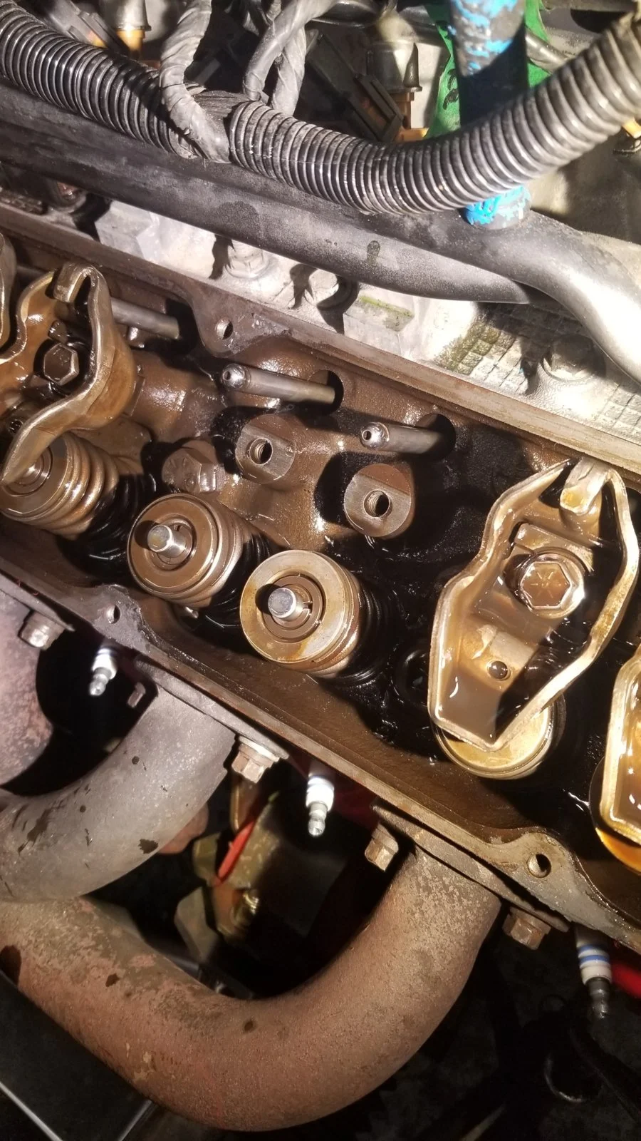

I may be wrong (imagine that) but I feel there is something missing. If you look at one of these videos you will see that there is a u shaped piece that goes between the rocker assembly and the head. I am not seeing this in your pic.
I don't think there's anything missing, its exactly how I got it out of a running truck, and it matches the motor I pulled
@General karthief is talking about the u shaped tray that the two rocker assembly's bolt through, this tray keeps the rockers aligned with the valve.
You may not be showing it in the pic but I can see the tray under the set of rockers adjacent to the ones you have pulled. This tray must be used.
I know what you meant by the "u" thing haha its there just not in the photos it connects the bottom of the rockers ! And it was installed

I'm just gonna go out on a limb and say cam failure. If the same two rockers are torqued down and the bolt backs off, that's one thing. But if they aren't loosening, and the pushrod is all kinds of loose after running....I'll take dead cam for 1000 alex.
I don't believe a bad cam would cause them to back out. Did you use the procedure I listed to tighten them?
If you do it with the valve open, the valve springs and the spring in the lifter will absorb some of the torque load and give you a false reading.
Joe
I did it how you told me too last night, started tdc of cylinder 1 on compression stroke and tightened to 20ft pounds, and then just followed my firing order around, double checked through the order once more and then ran the car for 10 mins. Seems to run really good (besides doing the timing) cable train stayed quiet the whole time
