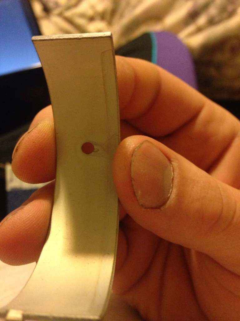

I ordered clevite p series rod bearings and i noticed that they have an oil hole in them where as the stock ones didnt . Is this a big deal ? I wouldn't think it is but i wanted to make sure .
HotFox
Nope no big deal. There made for aluminum rods with a dowl pin. Usually u can order with or without down hole. Should be a D in the part number.
CB-634 P-1 - these are my .001 over bearings and then i have standard size as well to get the clearance right . As long as the hole is no biggie i am satisfiedNope no big deal. There made for aluminum rods with a dowl pin. Usually u can order with or without down hole. Should be a D in the part number.

actually they were made for rods with full floating piston pins.

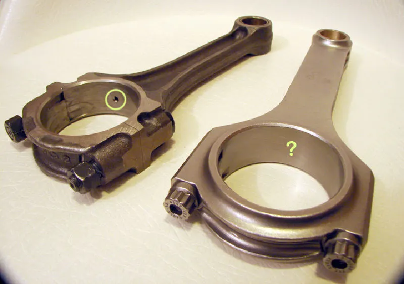

some rods are designed with an oiling hole drilled in them to oil the floating pins.

Here's what @rbohm is talking about as well.
