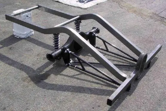

A back-halfed car has a half-frame under it like this:

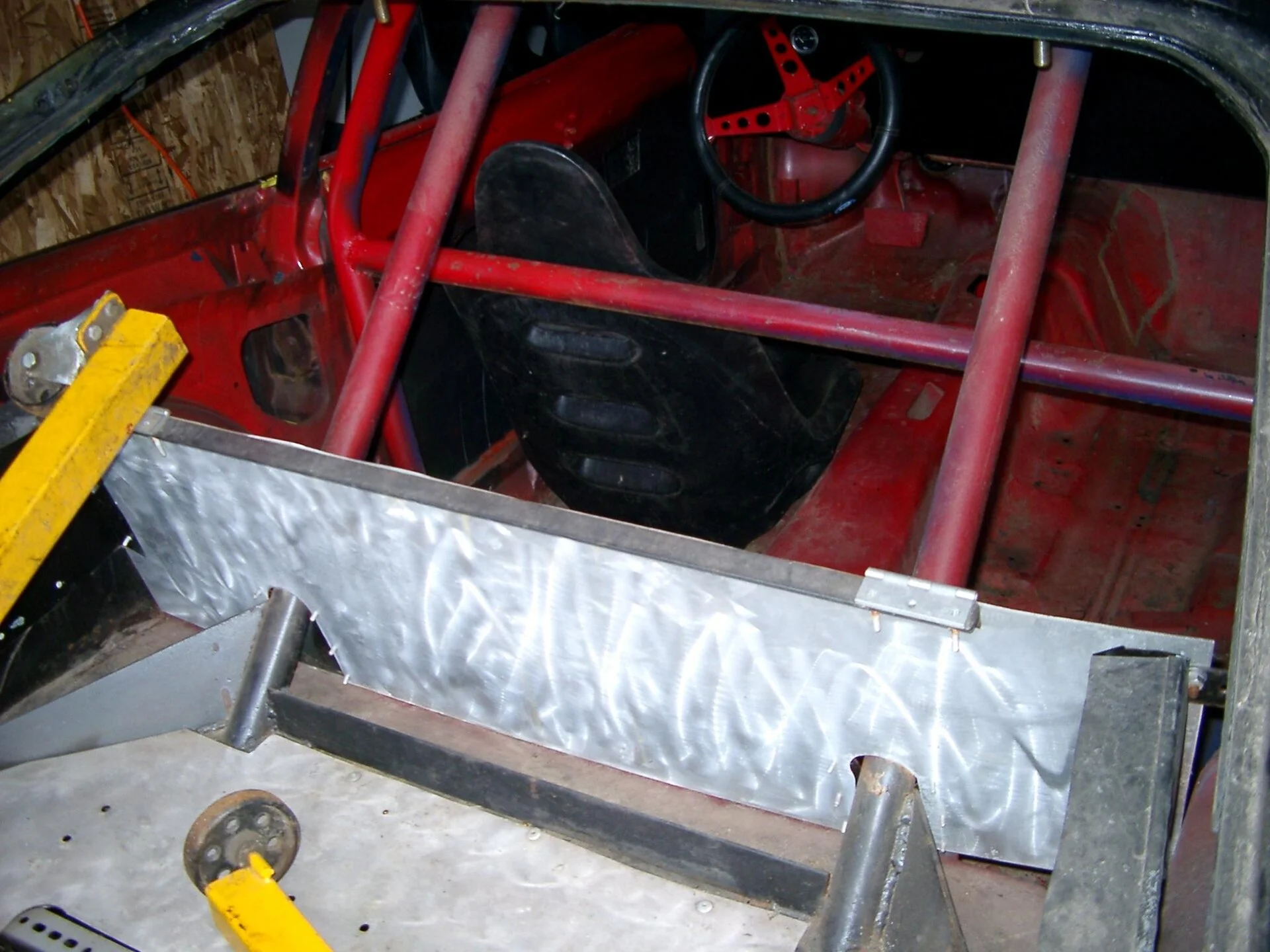

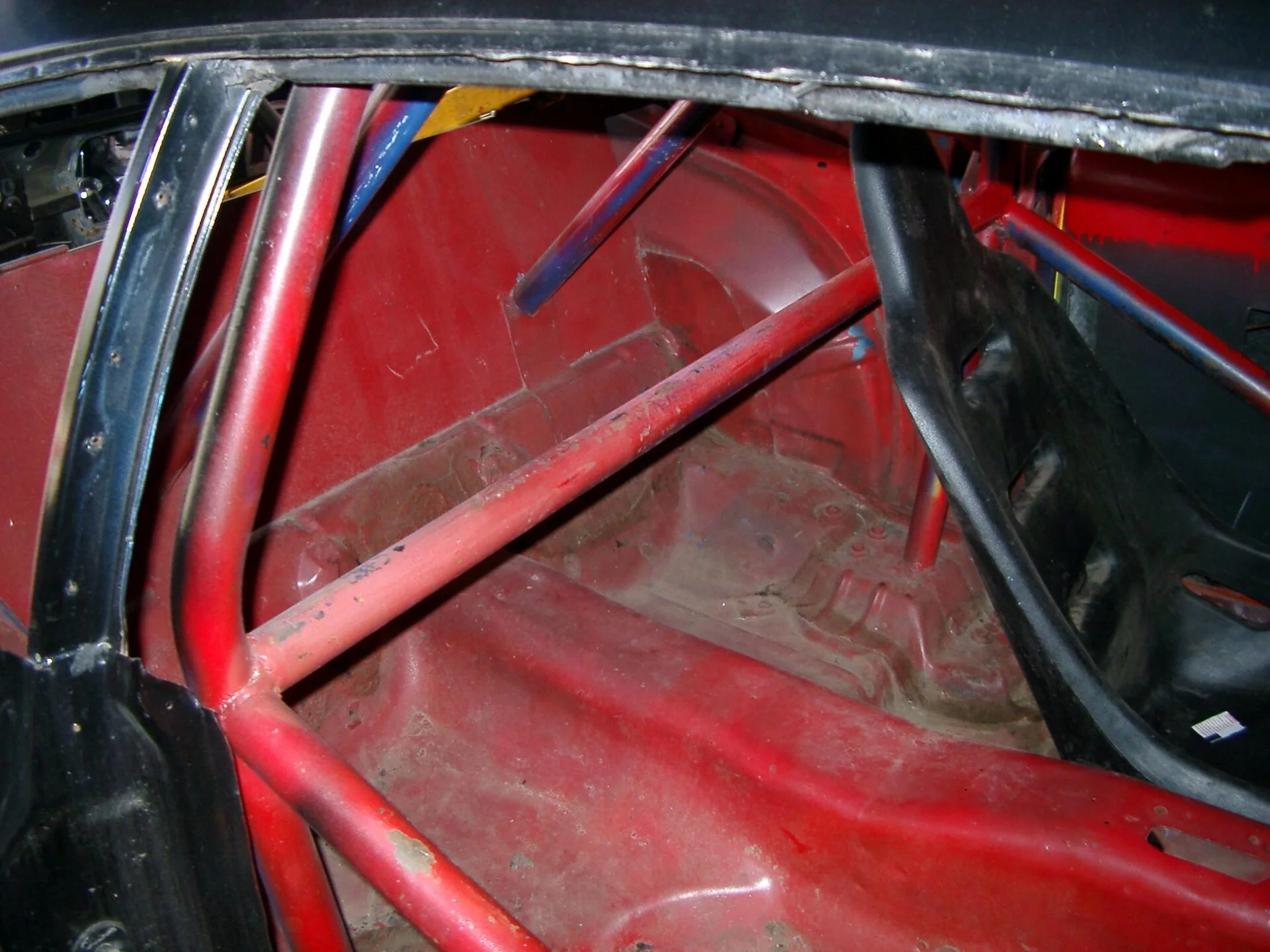

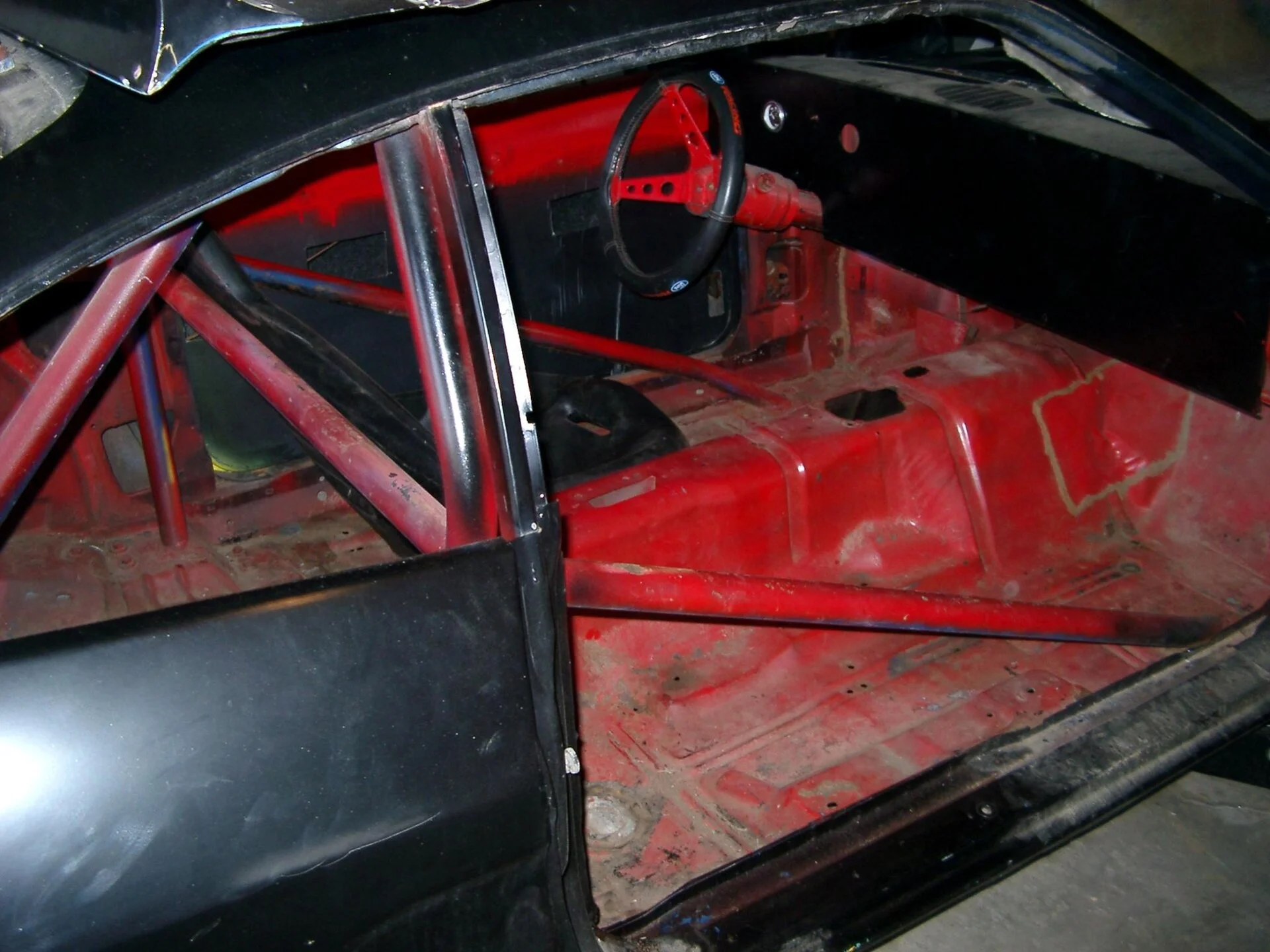

found some M2 roll bar pics online but this more race car and bars dont get along with stock interiors very well.
Think this cage one was by 'Auto Weld' and just for the M2
note plates at bottom of pipes and really big ones at the back

I think I know what I am going to do now. On the soutern polyurethane forum there is a guy who is building and orange mustang ii.
I like his roll bar design besides the door bars
I’ll probably go with that kit
Curiosity got the best of me, I had to search for that site to see who you were talking about. That's Rusty428CJ's car! He's a member here but for some reason I can't tag him. This is his build thread here. I don't remember if he mentions where he got his kit from, but I'd imagine that whatever you read on that other forum has been repeated here or vice-versa. He's got a helluva nice build going! :nice:
So I searched and cruised their site - I didn't see any door bars like Rusty has in his car. You might try to DM him and ask about them, they could be a custom job....? :shrug:
I don’t like his door bars.
They seem weak.
I think he has custom bars
Although I get they make it easier to get in they look like they would bend on an impact
I like the rest of the kit though

On a side impact I think I'd agree, they probably wouldn't offer a lot of protection. But if you're looking to strengthen the chassis, especially front to back, I think they probably do just fine in that regard. Obviously not quite as strong as a straight bar as the radii would give it a bit of weakness, but a whole lot better than nothing at all. Besides, you have to crawl in and out of that car, a big bar crossing your path just isn't conducive to driving it on a regular basis. I believe he is building this car as more of a show car as compared to a racer, so I imagine he wanted both the strength of the cage and the ease of entry/exit in his build. And, as Matt pointed out, he's not all that young either. I mean I'm 49 and am starting to have issues getting in and out of my car, and that pic in 71 was before I was born too, I believe he's in his 70s now. You might not have a problem crawling in and out of something like that, but trust me when I tell you there will come a point you will. I also don't think door bars are really meant to protect you from a side impact, I think they're more meant to keep the interior a kind of bubble in the event of a rollover as well as give the car strength as I described earlier. I don't think side impacts are what anyone had in mind when they designed door bars for roll bars or roll cages. :shrug: I could be wrong, if I am go ahead and correct me and link some resources. I'm strictly going off of my knowledge as a toolmaker and how I know things to work, not as a cage builder or engineer.

I know he is a good builder. The thing I was saying is a front or back impact the bars looks like they would compress easier.
I am 17 and have t tops so I think I will be fine getting in and out
I could aways add swing outs later
Anyway the kit he bought looks nice
I want dom steel
I hope that brand makes it
