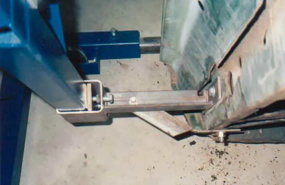

If you don't have the T brakets, you'll have to make some. My rotisserie came with a set that bolts where the rear bumper brackets bolt on. I'm alos supposed to run a strap under to the bottom of the frame rail as well on each side. They call it a mount stiffener.
all you have to do is remove the rear tie down mounts on the rerar frame rail and pound them straight. bolt them back up and drill or blow holes in the arms to bolt to the mounts. thats what i did.
