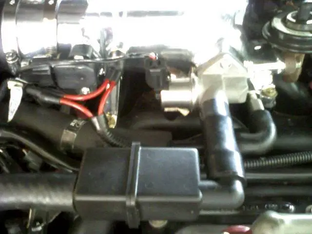

I really don't see how the iac can be installed wrong, heres a pic

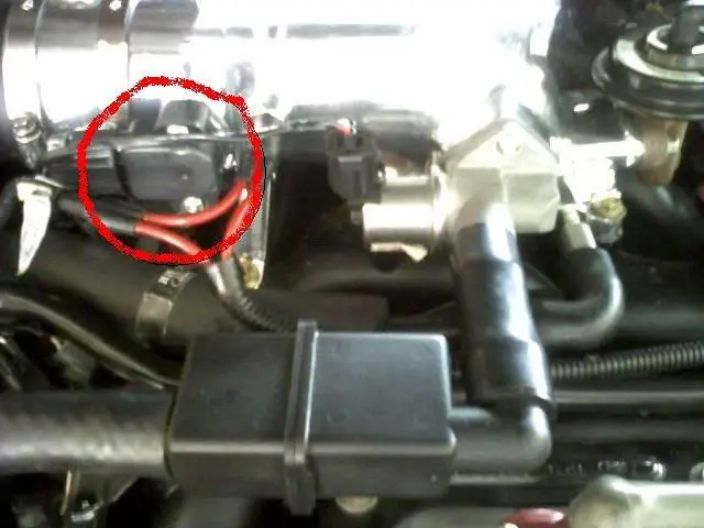

The 1st problem I bet is the TPS...I ahd mine installed incorectly and even bought a new one until I figured out that the sensor wasn't installed correctly. I does throw a code though.
The second problem might be a small vacuum leak somewhere. Just check all the connections to the TB and plenum and make sure there are no leaks between the two via loose bolts.

I know you guys may be done with this, but this document may help with the idle after installation of a new TB. From the Accufab website, but would pertain to any TB replacement. Please note the section on the TPS (sensor) adjustment. This definitely makes a difference, since I experienced the weirdness before I made the adjustments according to the article. Everything is fine now.
http://www.accufabracing.com/article_1.htm
I looked at that article and it says "DO NOT ADJUST THE STOP SCREW ON THE THROTTLE BODY UNDER ANY CIRCUMSTANCES. This screw has been pre-set at the factory to insure a proper air gap around the throttle blade in the fully closed position. If by chance this stop screw has been adjusted in the field, please call our TechLine for further assistance."
I did adjust my stop screw because my TB was sticking. I changed it till it wouldn't stick (probably about a half a turn). Why does it say not to do that?
