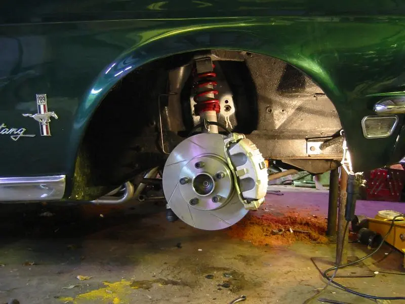

I have finally installed the RRS Struts that I bought as a part of a local (Aus) RRS Group buy. The installation is quite straight forward, and excepting brake lines was done in one decent days work at home, including removal of old suspension bits.
I had to get different brake lines made up as I didn't feel inclined to change my hard lines due to different flares on the brake fittings and where I wanted to mount the lines. I expect for most mustang installations it is nescessary to change either the hard lines or the RRS lines due to brake line fitting differences and mounting point positions.
Excepting brake line issues, the kit is very complete and the instructions are clear with colour pictures.
Due to difficulties with the steering (http://forums.stangnet.com/showthread.php?p=4882283) I haven't been able to fully test the setup yet. Those problems were not at all related to the RRS stuff - they were present before the install. I will post back when I have tested the setup more thoroughly.

Final Product:

Wait a minute, I know it probably doesn't make all that difference but shouldn't they have put those calipers toward the rear of the car? (centralise mass) They do look like they might be too big to fit there though.
Can you comment on unsprung mass saved? Did you get a feel (or even weigh) the bits that came out and went in?
Re: calipers, maybe, I hadn't thought about weight distribution, I would think the difference is negligible.
It is definately lighter than the stock setup (with cast iron calipers), I'd say a couple/few kilos different on each side - so maybe 4-8kg all up.
This is probably achieved mostly in having a smaller spindle setup with aluminium calipers.
They have a drag race setup with lighter discs/etc which is supposed to be 12kg lighter.

i got to ask what was ur prior brake setup?? strut looks good too
Prior brake setup was taken from our local Australian Falcons. Aluminium calipers and 287mm discs that are a bit thicker than the normal mustang ones. Spindle geometry felt better in terms of bump steer than what the car came with (I assume stock mustang, but perhaps it was granada). Spindles + discs were a bolt on affair.
