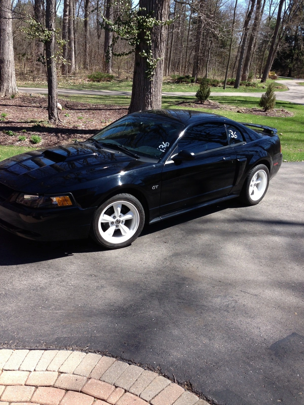

Hey guys, i have an 02 gt (5 speed) with an x pipe, CAI, short throw shifter, and 315's on the rear! i should mention i just bought the car about a month ago. I go down to the dragstrip about once a week for fun, and have an average reaction time of .09-.13 with little wheel spin at the line. Im just a little confused as to why my time is so slow, I'm thinking its something with the car, cause my 1/4 mile time has been pretty consistent (low 15's). Ive also peeked around at forums and people are saying they are running mid 14's in their 02 gt auto………. any advice?:shrug:
heres a pic of it
