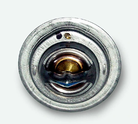

I always use the genuine Ford thermostat. It's the correct temp range, and stainless, plus it has an air release valve at the top so you don't have to go nuts getting the air out.

so if i'm correct it did not work when you bought it ever? maybe the car was overheating prior to this anyways? and now you know? I doubt its anything serious. but to help yah out the thermostat is on the other side of the upper radiator hose on the engine block. the spring side on the thermostat faces the engine block when you install it and should be that way now when you and if you remove the old one. Once you install the new one, thats after you clean off all the old gasket material or rtv let it dry for a while if your going to use rtv and raise the front end up in the air. That will help to get the radiator up as high as you can to release any of the air pockets that will be in the system. Watch you temps. If it gets past 3/4 on the guage shut it down before you hit The H.

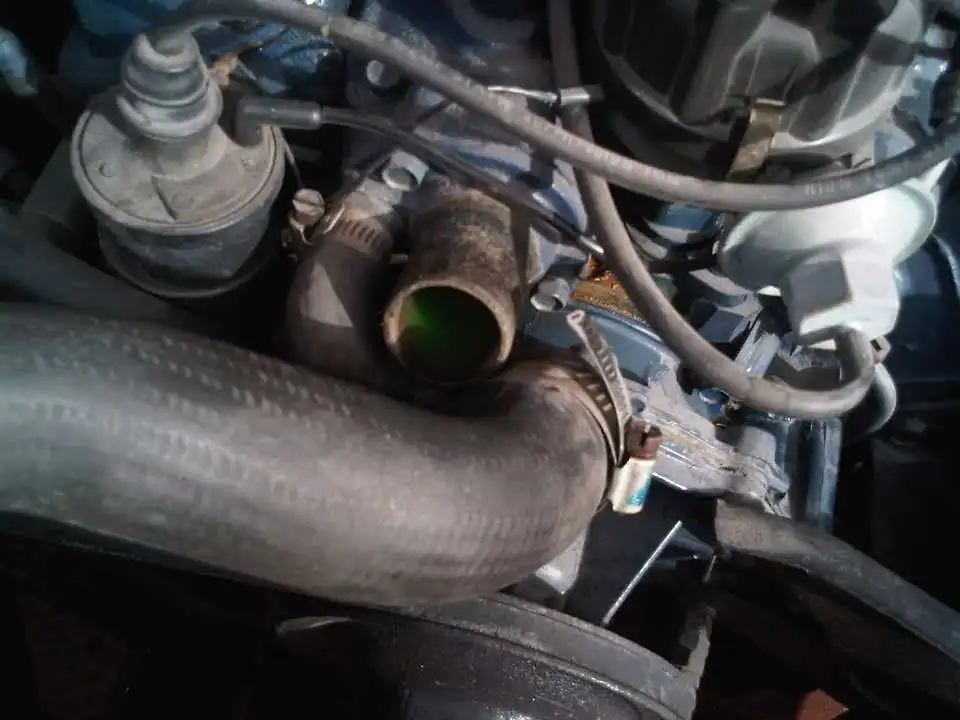

The only way to know for sure where the temps are is to install a mechanical temp gauge. The factory gauges are notoriously inaccurate. And the thermostat isn't in the engine block, it's in a housing at the front of the intake manifold that the upper hose is connected to. Two bolts in the housing. Remove the upper hose, unscrew those two bolts and pop the housing off . It'll be stuck to the intake so you may have to pop it loose with a rubber hammer or something similar.

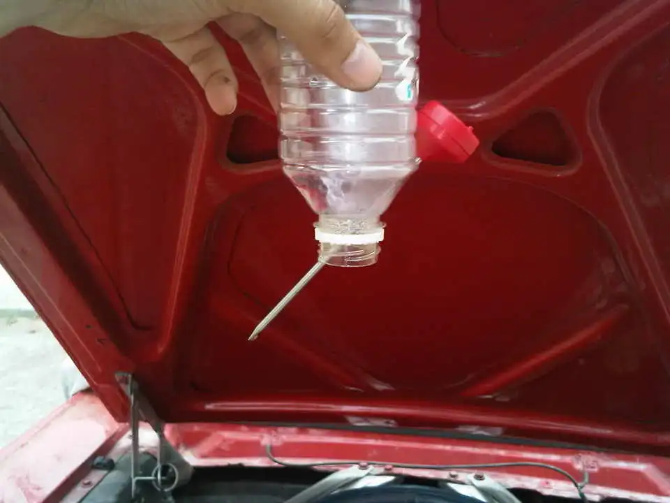

So i decided to have another look at my heating issue with the feedback I received.

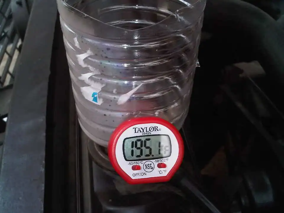

I got myself a digital thermometer made a simple holder for it - pictured below,
Topped up the coolant
The starting temp of radiator coolant was at 92F with the engine off
I started the engine (cold start) and the coolant temperature rose gradually to 195 which was HOT or the max then I stopped the engine (@ 115F the needle was in the middle)

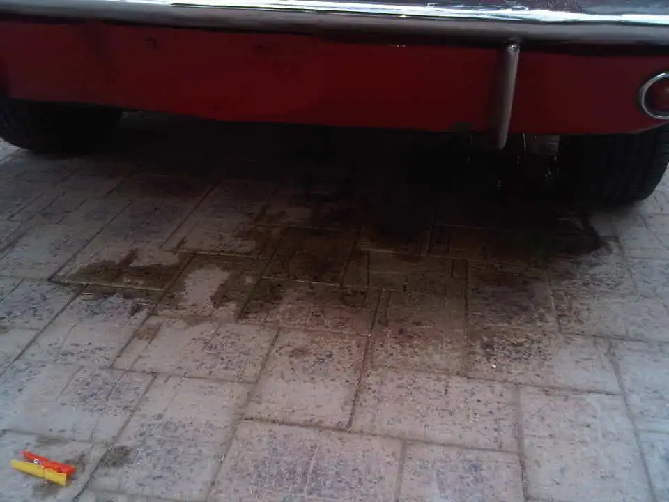

When I stopped the engine the coolant started to flood and came out of the over flow tube, a lot of coolant came out, pictured bellow and in the video

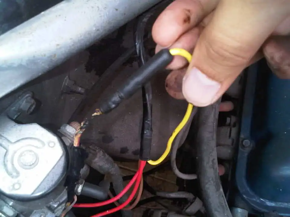

As I was inspecting the engine bay after the engine was off, I noticed a wire was burnt I believe its from the gauge feed harness does this have anything to do with the heating problem, either way what is that cable for (it was yellow pictured below)
I have a link to a short video that i took, I dont know if it well be helpful for you guys or a waste of ur time?
YouTube - 1966 Mustang 289 Running Hot troubleshooting
after several hours I went back and decided to look for the thermostat, DO i just have to unbolt those bold and replace it and the gasket?

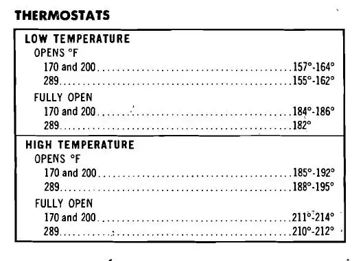

This is the information I got from the 1966 Shop Manual
can some explain the open and full open on Low and High

195 degrees is not hot. That's normal operating temperature.

I agree 195 degrees is a good operating temp. I would say the temp gauge is reading high.

If it's reading "hot" @ 195* then, yes, the gauge is wrong. As I stated before, the factory gauges are notoriously inaccurate. This isn't a classic Stang problem either. My 89 Ranger's gauges were way off well before I swapped the V8 into it. They went off base when it was only about 5 years old. Both the oil pressure and temp gauges were off. The oil read nearly zero when it was pushing 70 psi. The temp was always hot when the temps were normal (160-200) Put an aftermarket gauge on it along with the factory gauge and you'll see.
