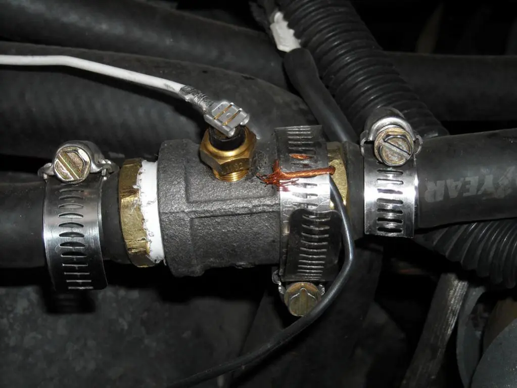

Ok I found a picture. This was done by a backyard type person. They actually sell a kit like this meant to run with your heater hose. For situations like this.

I have one of these, JEGS Liquid-Filled Engine Thermometers - JEGS
If you have a factory style cast iron thermostat housing with the temp sensor hole, this will screw right into it.
my factory gauge is almost over the high end limit and ther mechanical one shown above is only reading 200
Thats a cool idea. I just picked up one on ebay thats made by Marshal. It looks more old school like the other underhood gauges.
