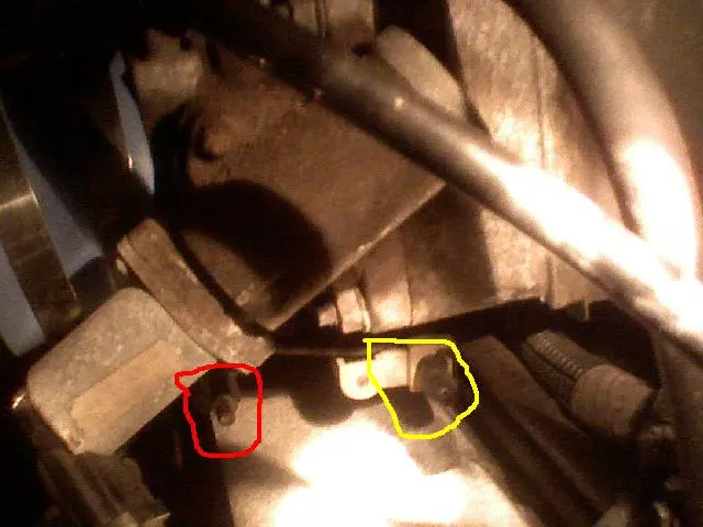

My check engine light has been on since i bought the car and my idles been rough. today my father looked at it and spotted this little sensor looking thing uncapped and he capped it and now the check engine light doesn't go on anymore but I wanted to know what the hell it was that he capped. He says an o2 sensor but I just want verification. Would that make my mpg go down? Its under the Intake on the left to the right there is another one identical with a cap
might want to replace the t-stat... they are only like 9 bucks for a good one or 3 bucks for a cheap one... i run a 180* t-stat works real good... more then likly its stuck closed or open...
also for the thing u your dad caped... might want to describe it better have no idea what ur talking about... but ur 02 sensors are under the car up on the midpipe...
K got the pics the one picture the red is the uncapped and yellow is the capped one

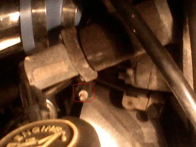

the 2nd pic is after i capped it
sry for the garbage pics its 5 am and my girls got my real camera:nice:
